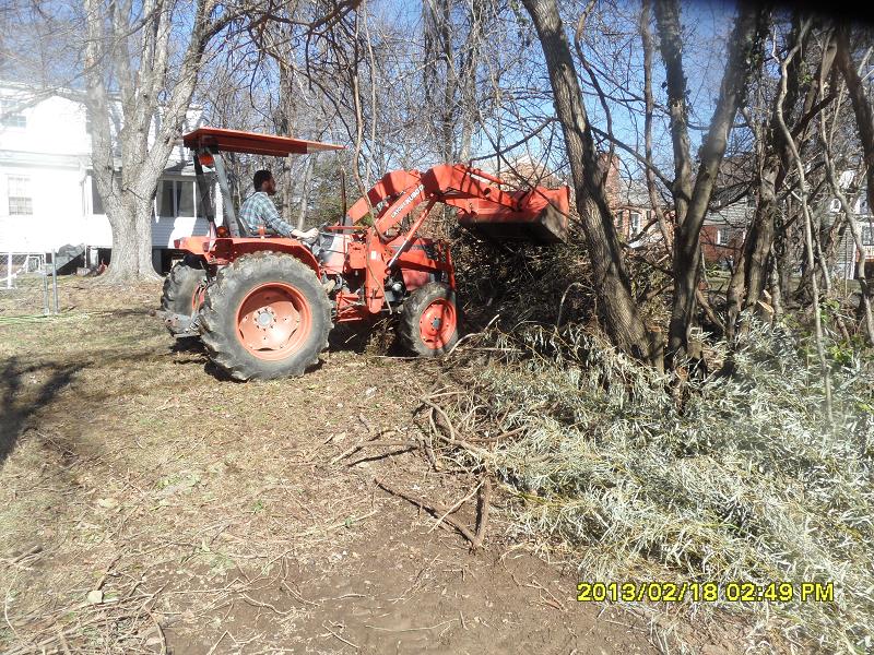

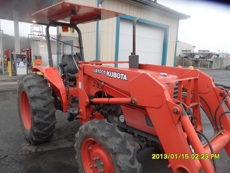

Why that width? A 45 Hp PTO tractor would probably be wider
For a 6' rotary cutter going uphill I think a
456686d1455218736-kubota-hp-needed-8x6sam_0797-jpg
40 plus PTO HP
456687d1455218741-kubota-hp-needed-8x6-g4-using-forks-jpg
tractor would do well.
Set the wheels wide and it's over 80". Set them narrow and I can get down to 78", to fit easily on my trailer.

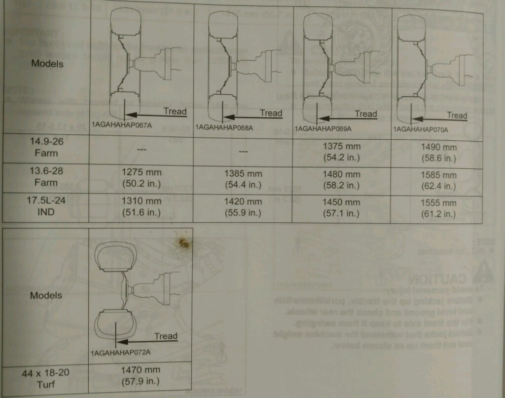

/ Kubota HP needed? #16
The base L's 00 & 01s R4s can't be adjusted, unlike the Grands & apparently MXes. Duno about the Ms.
I think the MXs and basic Ls have 2 positions that you achieve by swapping wheels side to side. We're talking about R4s here. R1s will have multiple positions achieved by swapping side to side, changing the dish of the wheel, and how it bolts to the rim, regardless of the model. The Grand L series has R4s that can be adjusted to multiple positions similar to how R1s work.
/ Kubota HP needed? #17
FWIW: At least for the MX4800 and MX5200 I can say for certain there are 4 wheel widths for R1 AND R4 (only 2 with turfs). I suspect all the MX models are the same.
Not sure this matters to the OP but just wanted correct info out there.

/ Kubota HP needed? #19
Attached is from the manual.
Oh, good to know. I knew they had at least two positions for R4s, but I didn't know they had 4. That's a nice feature.
