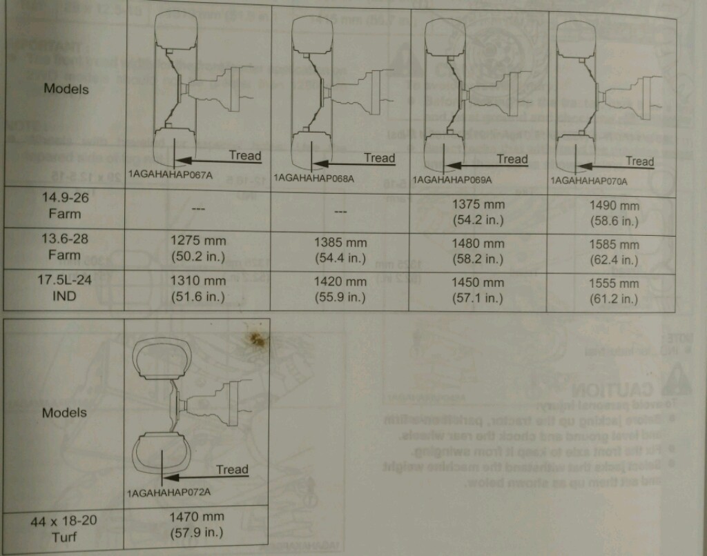

/ Kubota HP needed? #26
I think the MXs and basic Ls have 2 positions that you achieve by swapping wheels side to side. We're talking about R4s here. R1s will have multiple positions achieved by swapping side to side, changing the dish of the wheel, and how it bolts to the rim, regardless of the model. The Grand L series has R4s that can be adjusted to multiple positions similar to how R1s work.
You can adjust the dish on my MX as well, not sure if that is a new option (R4s).
ETA: already covered I just hadn't caught up.
