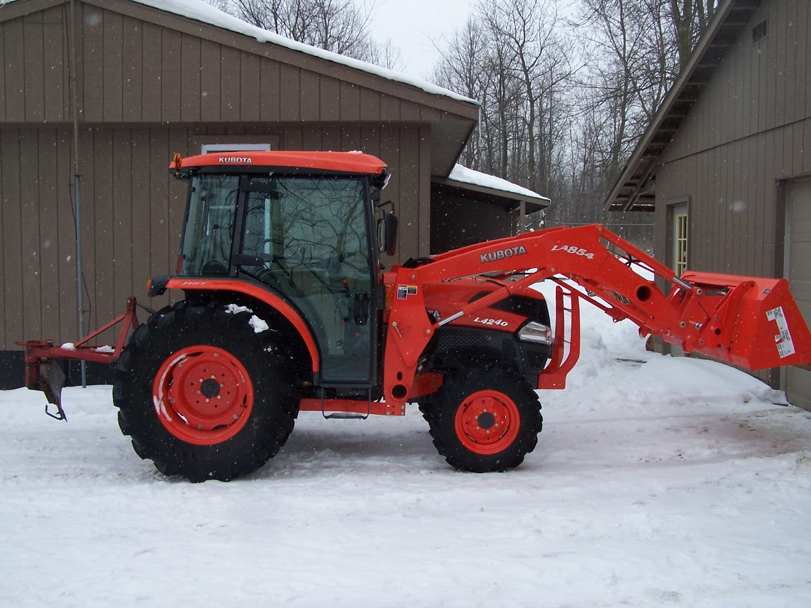

The beauty of the HST+ is you don't have to use it(if unfamilar).On my L4240 I do everyting in medium range,all but road travel.It's just a flick of the lever up and down.IF you start to bog;just go down a range.Very simple and I don't believe you can "hurt it".I sometimes use "stall guard" when moving dirt,but never use the "auto throttle".IMO the L4240 is a very good all around tractor.
I plow snow,roto-till,brush-hog,pull a two bottom plow,box-blade ect.and find the HST+ perfect for these tasks.
Picture when new.I now have a seven ft.Bush-Hog rear blade and a eight ft.FEL mounted snow blade.
