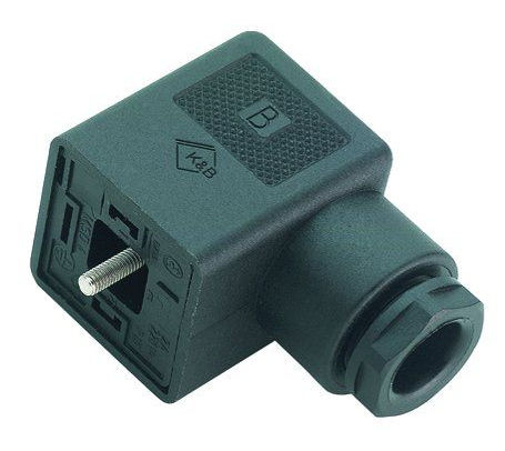

I checked my L5740 and it didn't at all resemble the pdf file you attached, nor did it look like your original picture. Then I noticed that the pdf was for ROPS equipped 2007 - 2009 models and Kubota made a major transmission change with the D-3 version introduced in 2010. My solenoids are completely covered with bolted on shields and cannot be seen without removing the shields. However, I did some research on hydrostatic pumps and motors typically sold in Japan and the common options appear to be Deutsch connectors which I believe your tractor has, or DIN 43650 (the DIN has several versions but I believe the various types all have the same electrical connection with varying grades of sealed housings). I think yours is a Deutsch connector which is in line with the price you quoted. It also fits your description - connector housing, seals and pins. They have really been an industry standard for mobile equipment because they are so well sealedvirtually eliminating corroded connections. Some solenoids have a pigtail for the connector and some solenoids have that part of the Deutsch connector firmly attached to the solenoid. Your failure description, and the picture, indicates the second version with the possibility the housing can be damaged if the wires are snagged and pulled - I think. All of my machines at Cat had the solenoids on top with a belly pan under the frame so it was impossible to get at them without removing shielding. The images I have attached show a coil with Deutsch connector body and a DIN 43650 connector which instead of plugging in is secured with the screw seen in the middle.
