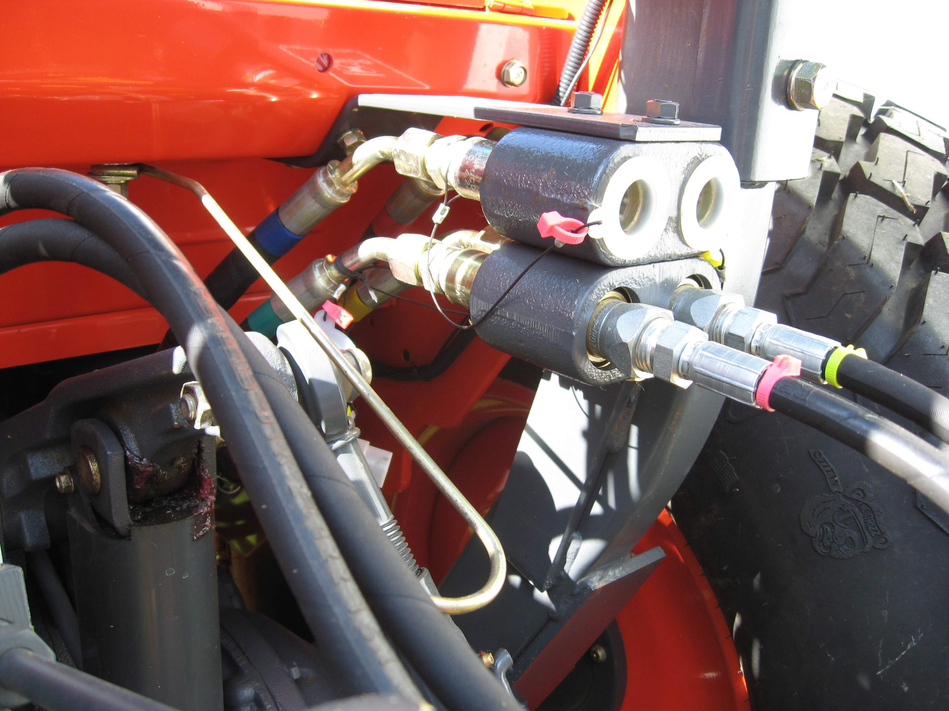

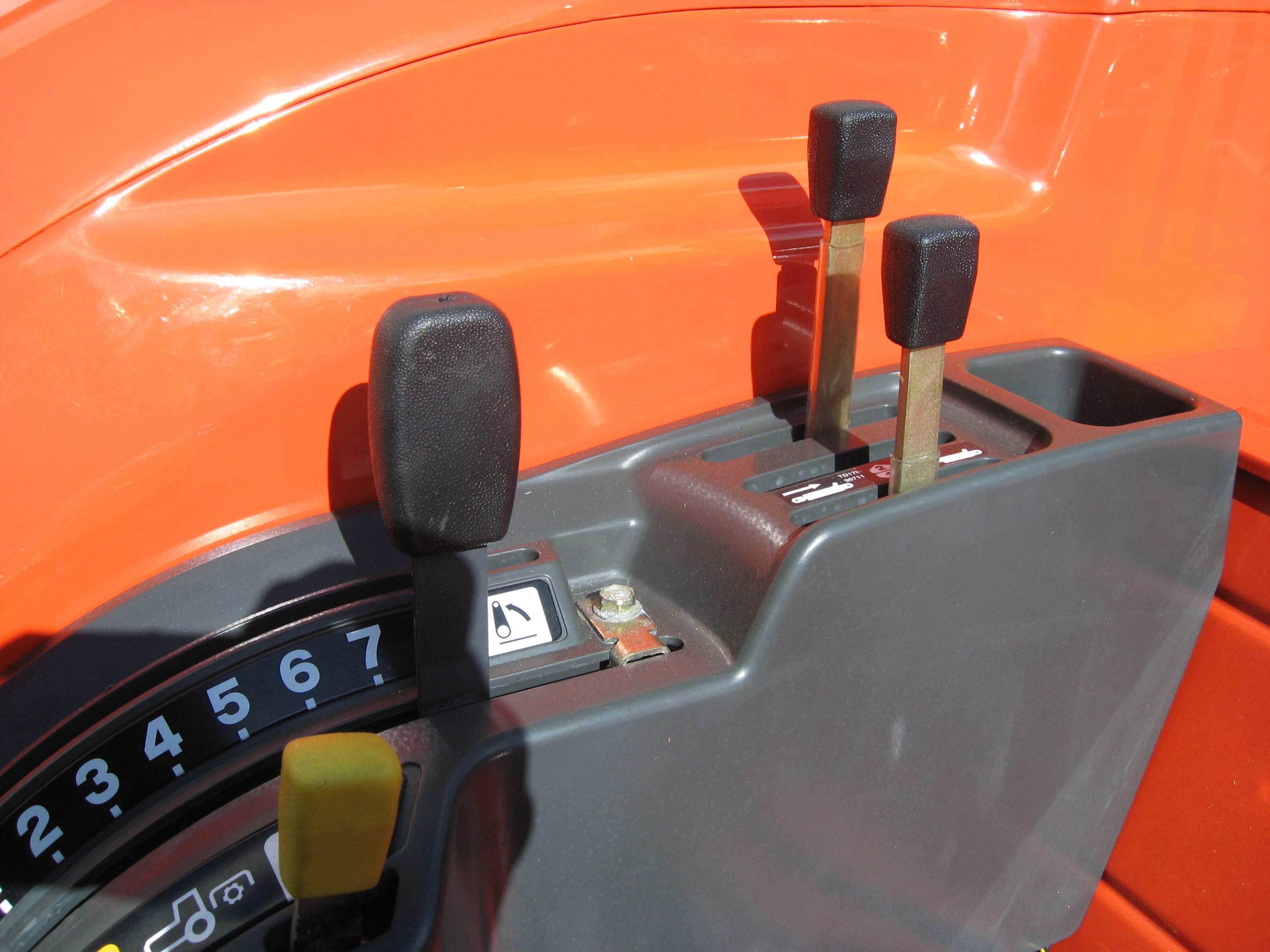

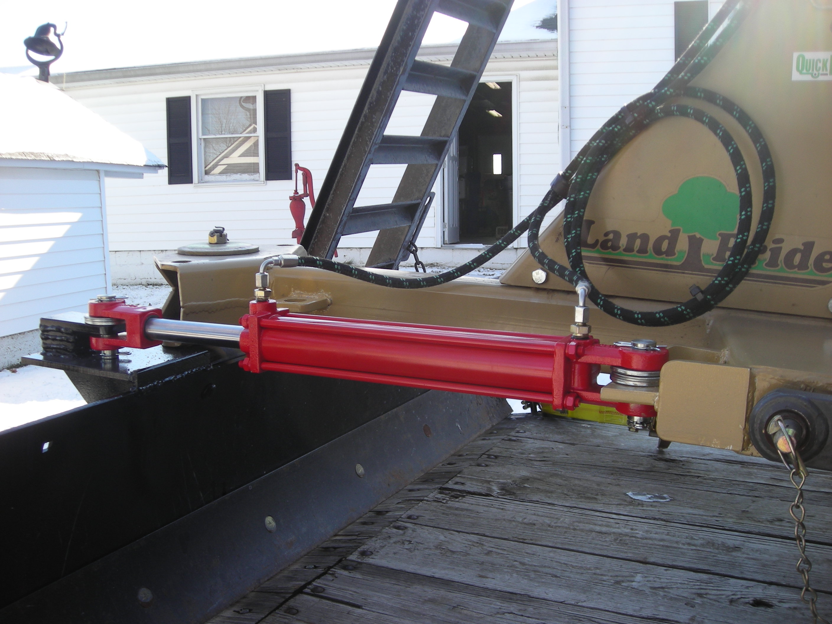

I got my tractor with one remote installed to operate a hydraulic top link. I shortly added a second remote to control the angle on my rear grader blade. Now I would like to get a box blade with hydraulic operated rippers. Philip.

Thanks Spy and Philp.. I see know where the lever goes.. Gee nothing in those slots on tractor:confused: This is NOW making more sense to me... With the standard remote is the top link locked in place and the implement doesnt jump up? The Kubota site says standard and FD which one would you want for the top link?

Both of my remotes are standard, I believe the term is open center. When the valve is in the middle position, the cylinder is in a locked position. In my opinion, this would be best for a top link. Philip.

I like the float detent valve on the top link it allows me to float the box blade so I get a smoother job and when I am running the rotary cutter I will float it and it allows the mower to follow the contour of the ground and ride up and down wit the tractor. The side link I would use a standard valve. the float detent will do both jobs.
