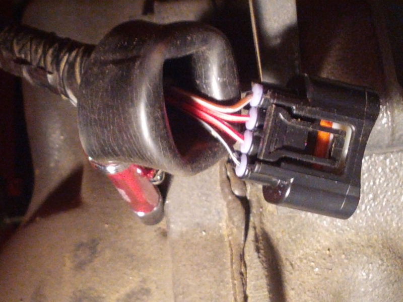

   / Kubota ign. Keys #26
Here's a picture of the connector. Top to bottom is brown, orange, red, black.

Well it works !!! No error message on start up and the cruise works good. My tractor had two red w/white wires instead of one red and one orange. The pic you sent got the odds down to 50/50 and I was feeling lucky. Thanks again
