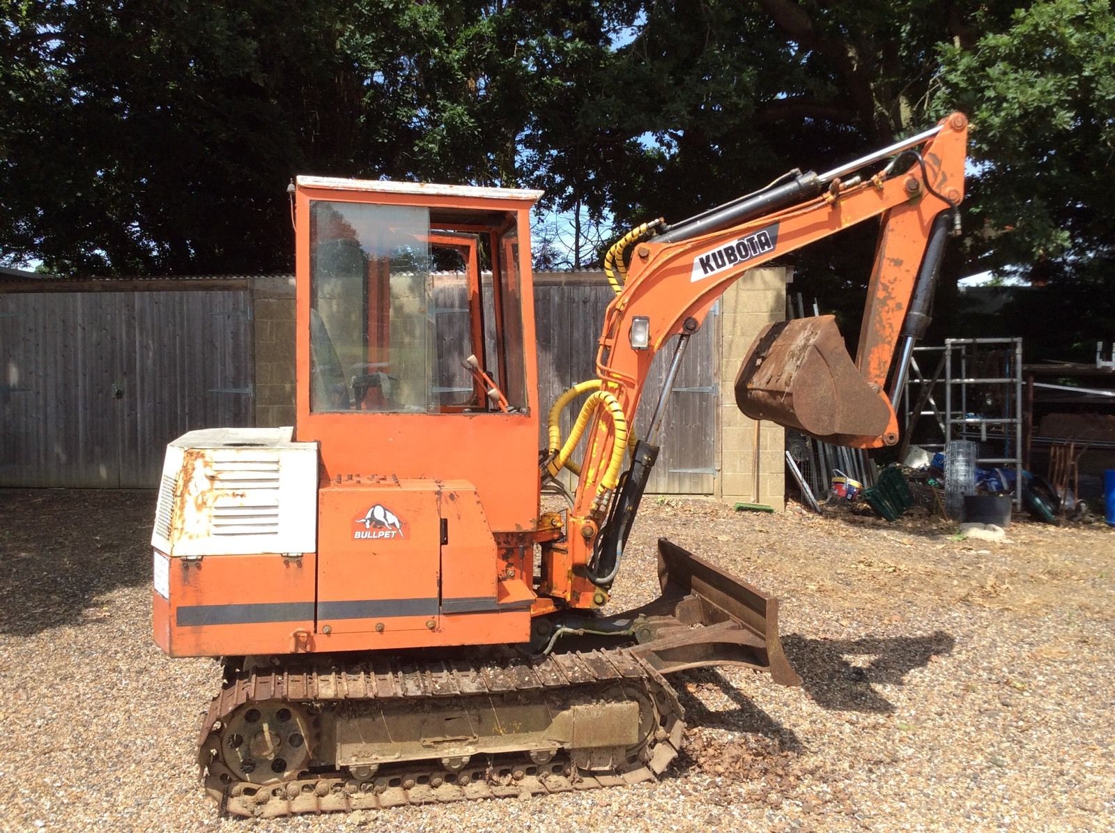

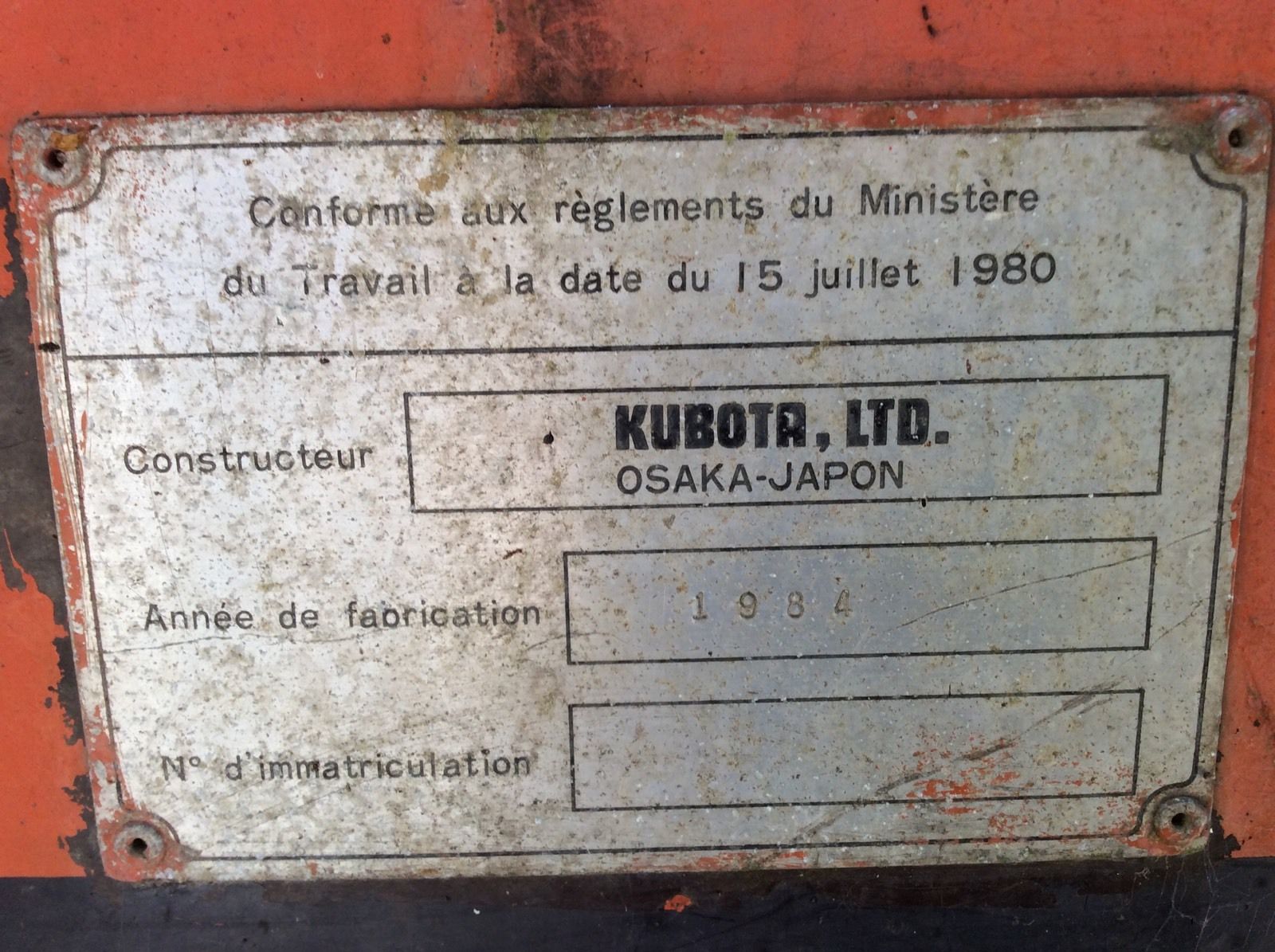

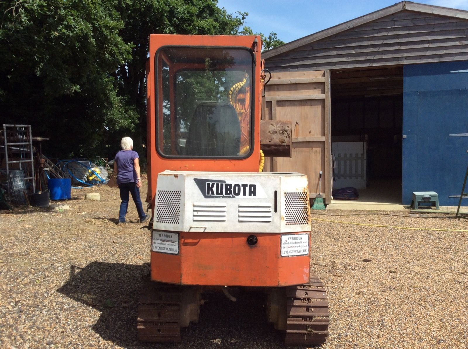

Just bought my first kubota. It's a nice 1984 kh8-2.
Looking for information on them. Not found anything with Google....
In particular the weight and specification.?
Any chance of me finding an operation / workshop manual?
Thanks

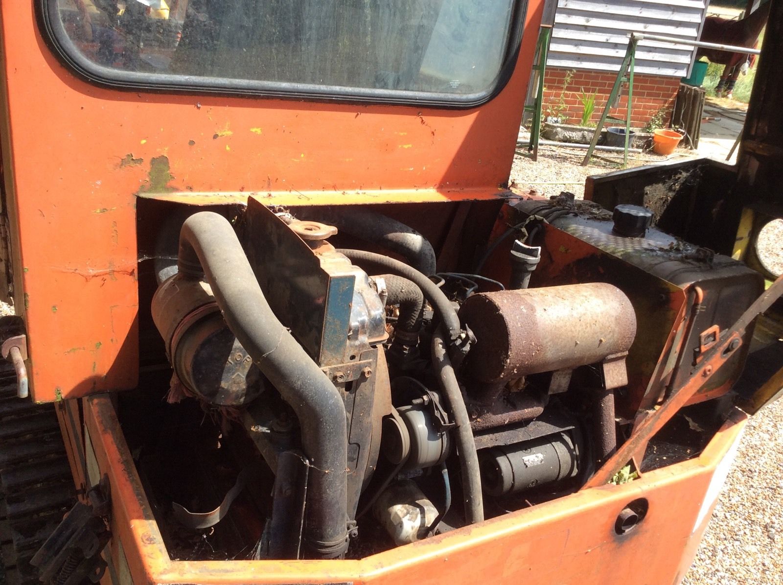

So far i have found it has a D850 engine.
First things i need to know are...
Which oil to buy for the engine and hydraulics?
One track is a bit loose, how to tighten, Grease?

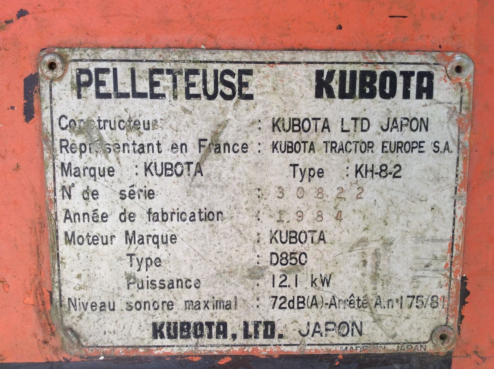

I am in the UK. It seems the kubota was sold in France originally.

(Do you have any photos? I personally am always interested in the old iron.)
The motor was used for several different applications such as welder/generators. Also it was in the B6200 tractor here in the US. If you search the B6200 there is a decent amount of info and it will at least helps with engine info (old service manuals are also around and fairly cheap)
/ Kubota KH8-2 info #8
Looks good! Looks like you have a solid machine!
Can you add teeth to the bucket or is that just a ditching bucket? (The teeth help it dig quite a bit better, but are not the greatest thing to have it you want to finish grade)
It is interesting to see how some of your machine has evolved into the current product line. The general boom design is very similar and the blade system really has not changed that much until you go to a 6 way blade.

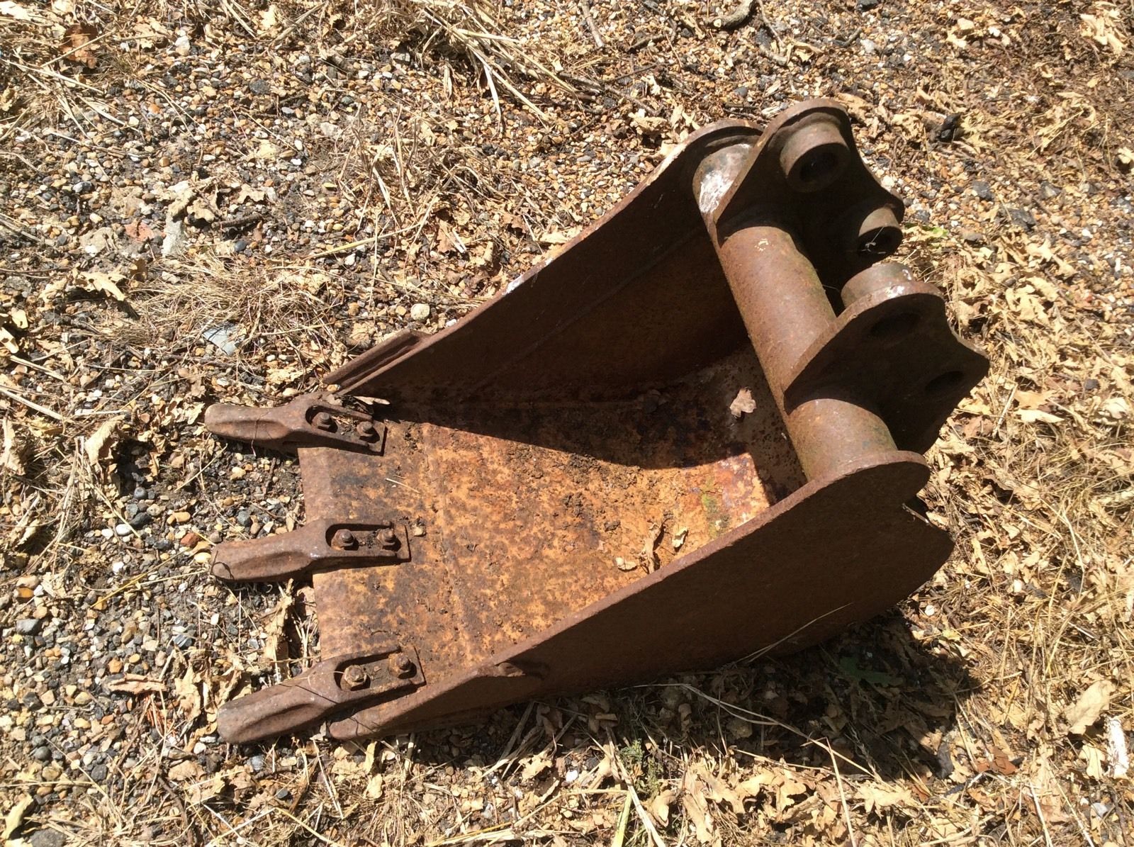

I also have a 14" bucket:
/ Kubota KH8-2 info #10
excellent! That makes for a good setup!

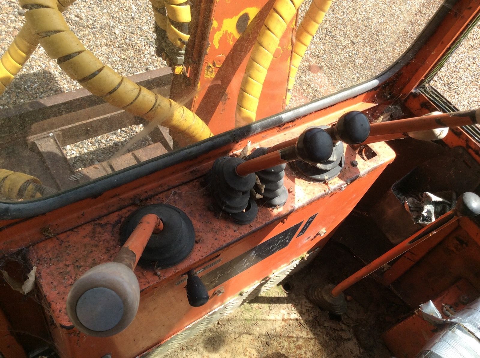

One leaver is stiff to operate, I need to look at that.

It should take a little over three and a half quarts and you can use Kubota Diesel engine oil or any quality diesel oil such as Rotella (Don't really not syn.oil, reg. dino oil is fine)

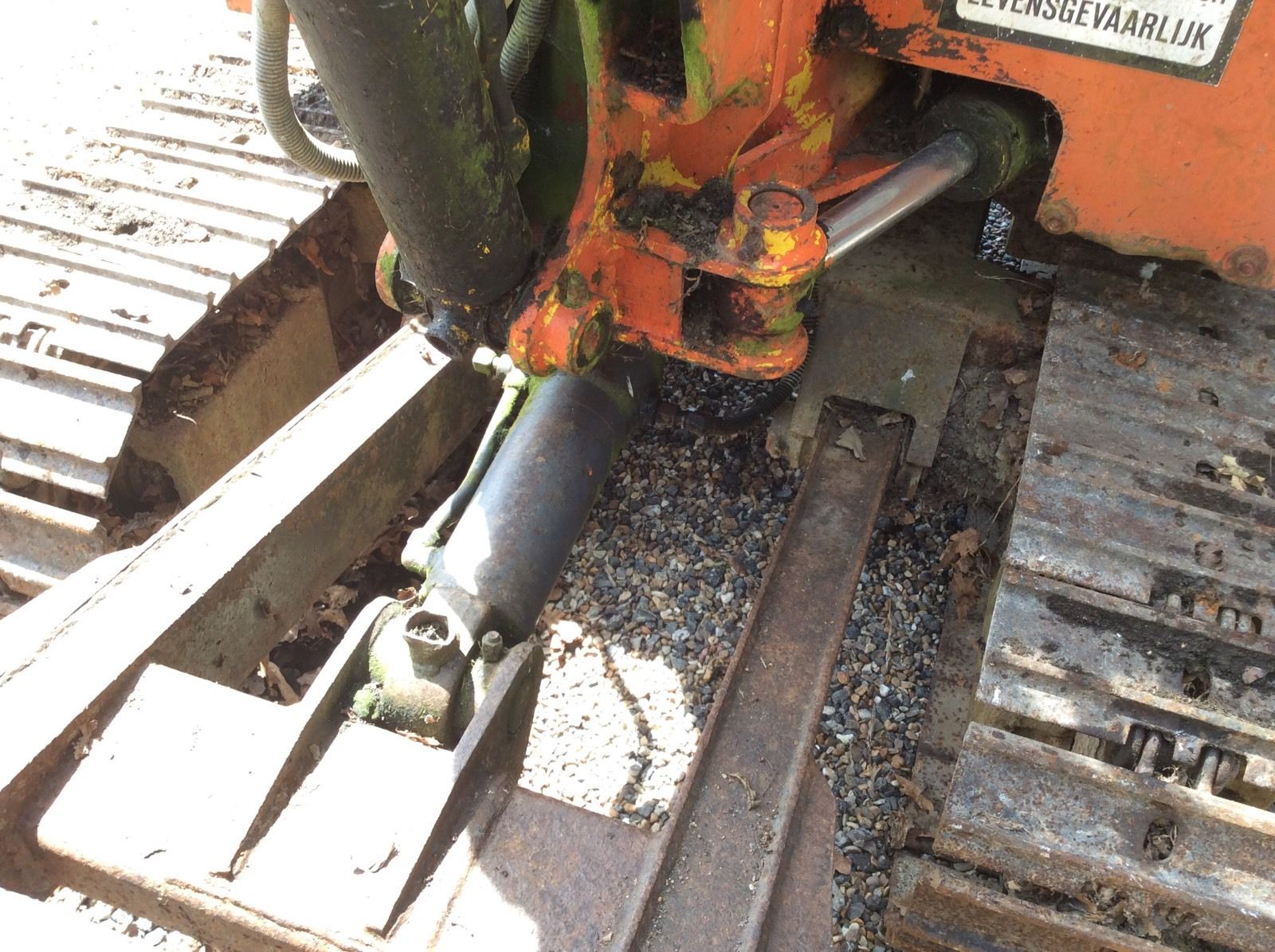

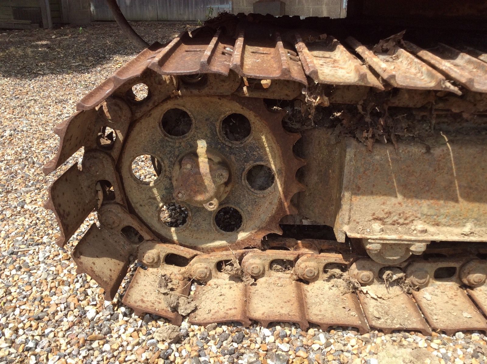

Track tightening appears to be a manual screw ?

That is a lot different than the newer models..... The newer ones use a grease nipple for the tracks and grease pressure holds everything in place. Very simple and works great.

Today i managed to tension the tracks. Does this look reasonable? i set them to sit 1.5" below center roller.

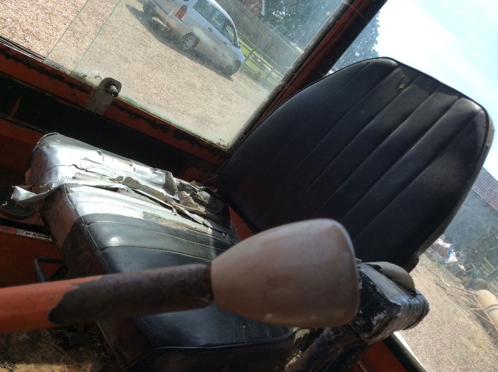

Also lifted the seat out and floor panel to check the swivel motor.
The gearbox for that was dry :-/
