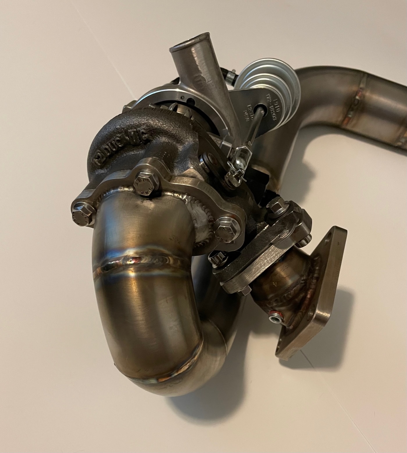

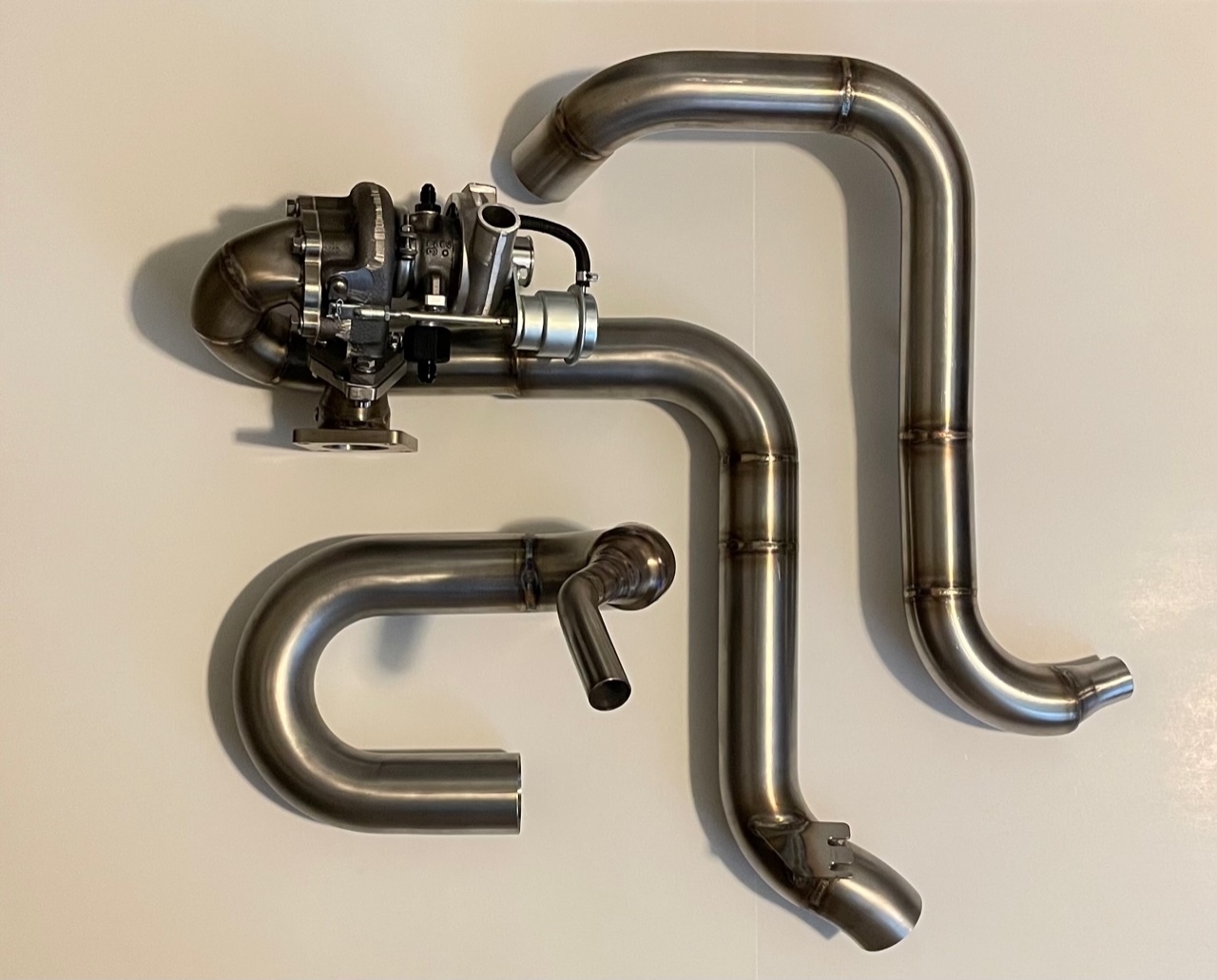

Here's a pic of the L2501 Turbocharger with down-pipe and exhaust and the intake pipe and charge pipe;
Mike

Isn't that just beautiful.

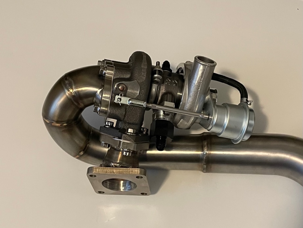

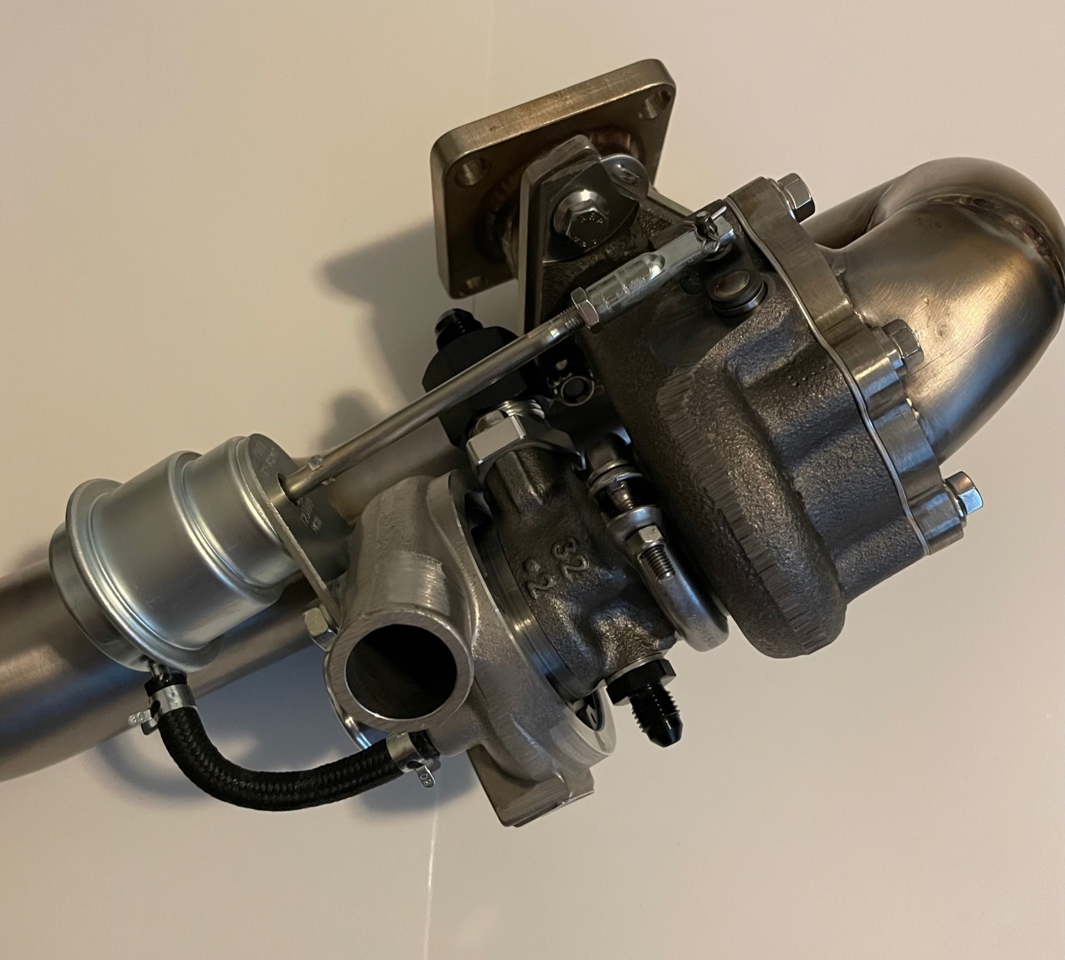

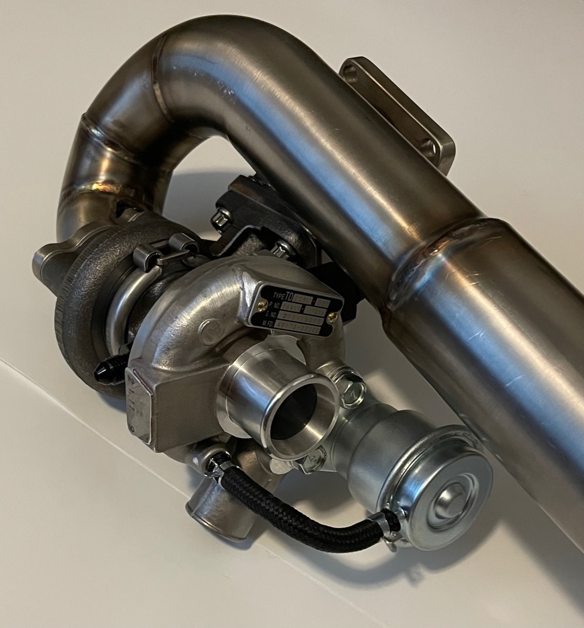

Here are some unposted pictures of the L2501 Turbo assembly;
Mike

Nice work!
Can't quite check the numbers on the turbo but that looks just like the ones used on a lot of vehicles here in Europe with engines anywhere from 1.5L to 2.0L.

#130
Nice work!
We’re using the OEM Kubota #1A024-17016 (Mitsubishi MHI TD025L-03C). And, yes, this MHI TD025 is used on a bunch of tractors and automotive applications.
