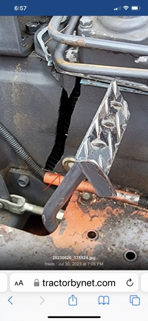

Have you looked for a worn out like model tractor?
Surely there’s a tractor in a graveyard somewhere that still has a good bell housing
That has been the problem, I can't find anything...or can't get anyone to return my messages.

The housing is a thin material and mostly for looks /Would suggest removing it from the engine and transmission then matching the cracks and bolting together. it would be stronger and neat not noticeable
my Kubota also broke so left it open to drive the shaft to the clutch.
was the ride bumpy?
ken

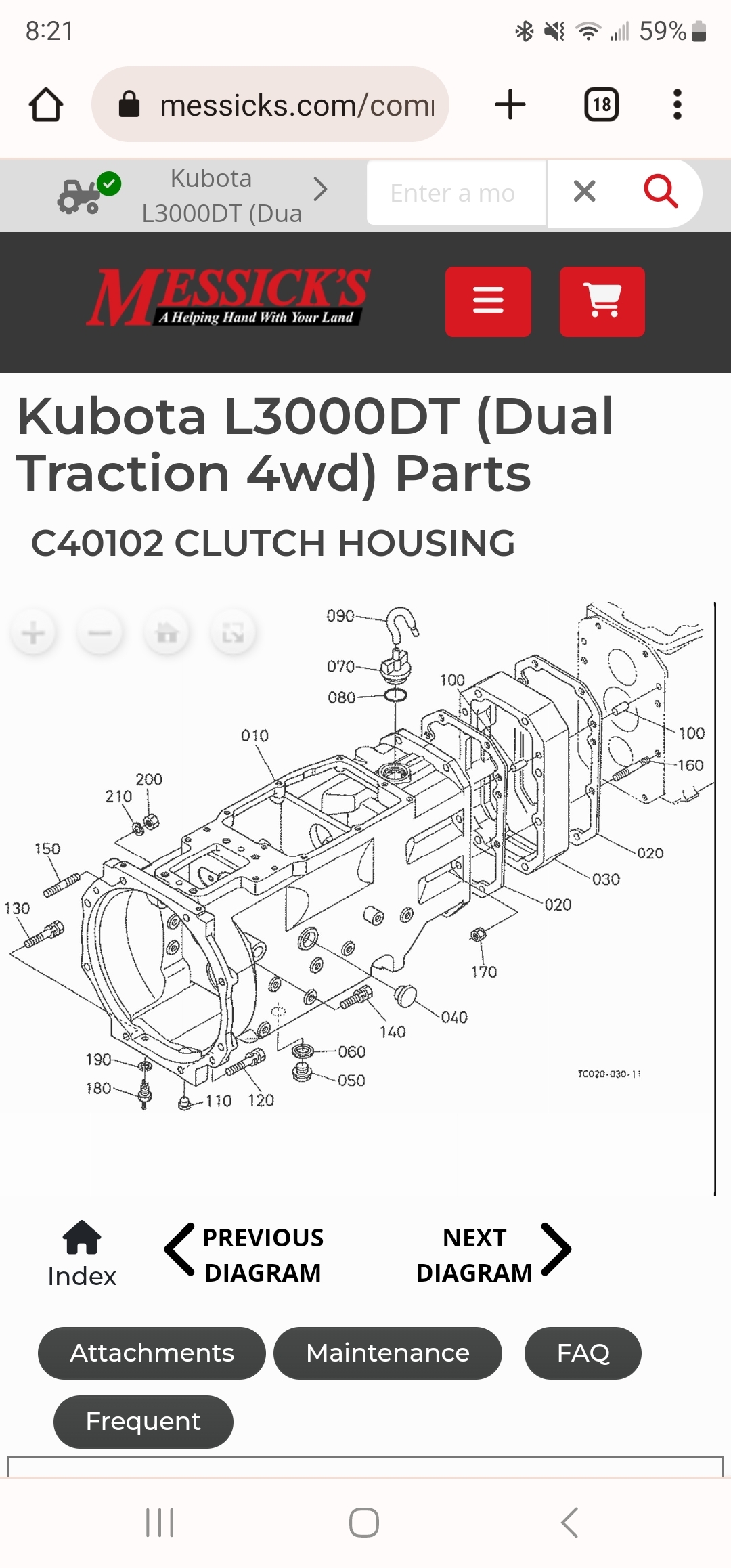

Looks like gears inside and it should be part of the hydraulic tank? Maybe I am wrong. Could possibly have it welded back, but it does look thin.
   / Kubota L3000DT Clutch housing #15
Unless something is added it keeps the clutch housing and transmission pump separate. allows you foot room to the seat.
mine only has a shaft from the clutch to the universal joint into the transmission.
ken

Maybe something is different because it looks like gears in the crack to me and the arrow in the picture is pointing to what I would say is the sight glass for the hydraulic fluid.

It does have a main shift and counterpart inside. It definitely holds fluid that spilled out immediately. I thought originally that it was the transmission but that bolts up behind this.

The clutch housing also contains the 4 speed transmission. The Hi-Lo range is contained in what is called the transmission housing but is actually the hi-low and rear differential housing. I would say that you will have to replace the clutch housing.

Hi, and looking at my 7800 DT from the left side of the picture is the Clutch and throw-out bearing a shaft threw the housing left also is the clutch pedal attachment. across the top of the housing, the Fuel tank is bolted on then there is the 4-bolt attachment for steering to the front end. then I have an opening for the front of the pump Hydraulics and filter for the fluid inside but not part of the housing it is open on the bottom able to put a hand inside to grease the you-joint to transmission. then bolted onto the transmission.
on each side is attachment bolts to separate the front part and roll the rear end away from the housing. also beneath is the shafts for 4 whl. drive and shaft for mowing attachments.
it is one of the easiest types to repair of any I have worked on. I know sometimes there is additional add ons but I'm referring to the picture referenced.
Get some blocks and place them beneath the transmission and the same for the engine. remove the transmission bolts and whatever is retaining separation. can be welded after all it was in the building I suggested a strap to give additional strength and make sure alignment is achieved before welding if needed.
all shafts have a pin needing to be removed.
