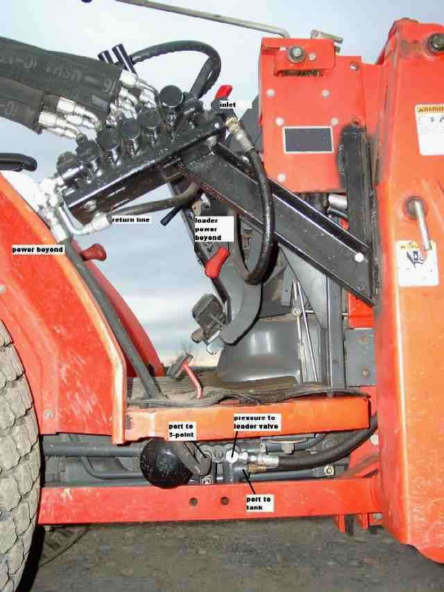

Here is my answer to additional hydraulics. Since this picture was taken the two foward valves have had Tees added and run to the front on the right side to allow me to plug in my Meyer snow plow. (Sorry no pic of the plow mounted) I was unable to use the loader circuit because of the regen in the dump cycle. I bought the five section valve, one with float, three metered, one standard (did not have a fourth metered available at the time) two cushion valves, one cylinder for the top link and a cylinder for the side link for about $490.00 with freight. The hoses I am lucky enough to work in a truck fabrication shop that does hydraulics so I get all kinds of " scrap hoses" for the taking. This is on a L2900 yours similar?

Bill_M that looks like a lot of serious hydraulic fluid under pressure moving within inches of your head to me. Are you using anything on the hoses other that the anti-abrasion sock that I see to protect yourself? /forums/images/graemlins/confused.gif
   / KUBOTA L3010 LOADER MTD. AUX. HYDRAULICS ? #15
Pine Ridge, No, there is currently only one piece of wrap on each hose. I did plan on a second covering on the ends at the least, I put it together and never got back to it. Still have to change out a hose and adapter to stop a seeping leak. They are more than inches away but not really that far when you have seen what a burst hose will do. Thanks for the reminder to think safety first!
   / KUBOTA L3010 LOADER MTD. AUX. HYDRAULICS ? #16
Hydraulic oil forced under the skin is dead serious business. Be careful out there Bill.
   / KUBOTA L3010 LOADER MTD. AUX. HYDRAULICS ? #17
ya i had a guy at work who blew a hydro line on a concrete mixer. another guy thought he could help him get the load off so he rapped the line with a rubber glove, then a shop rag and held on to it tight thinking he could stop the leak. he stopped it for a second, while it injected it into his finger. they split it open to let it drain for a few days, then did grafts. after that i would call him any time a hydro line would break and ask if he could plug it. He would tell me to kiss his finger. I dont have to tell you where they got the graft. /forums/images/graemlins/blush.gif
