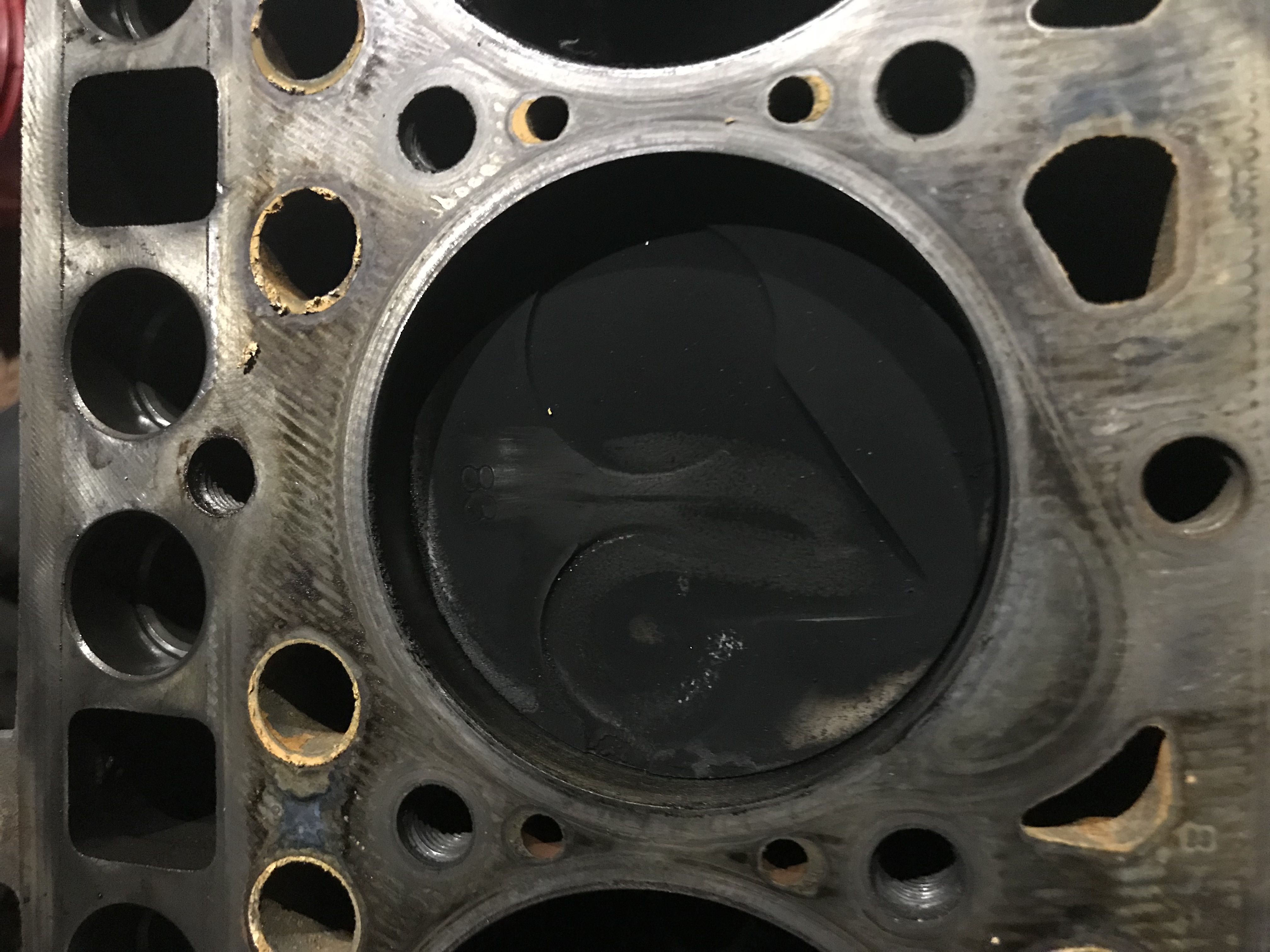

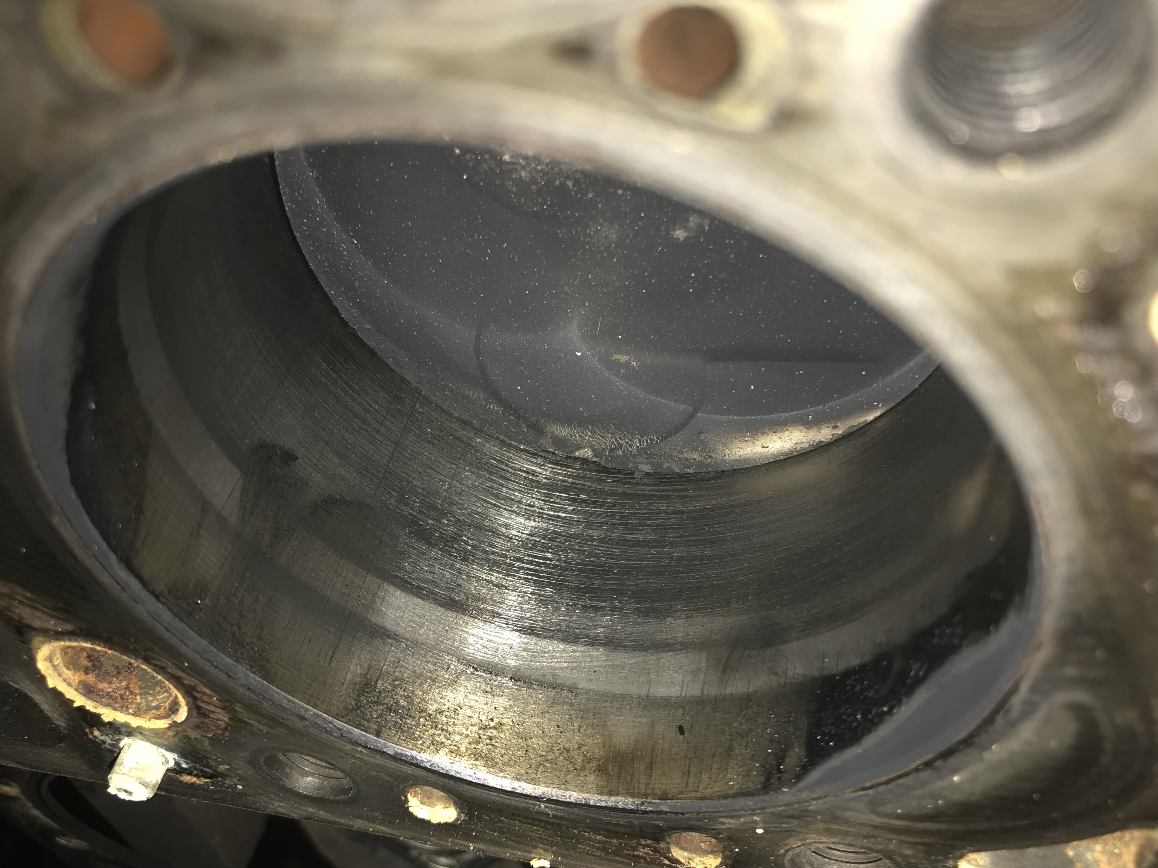

So finally got a chance to tear into it more, a few bent rods and a lot of carbon build up in the cylinders. There is some scarring on the cylinder walls, it looks to me like whoever owned this before never took care of it (possibly one reason for the broken crank). I went ahead and got a new motor shipped, should be here in a few weeks.

I would be checking the intake system for a cracked hose or something allowing air to bypass the filter. Also if it is possible rain got into the cylinder(s) causing a hydraulic lock when cranking.

The only thing I can think of is, the engine has had a coolant leak into that cylinder . Possibly because the head bolts were not re torqued after the apparent rebuild by the previous owner . That piston may have had water/coolant on top of it when it was started, which bends rods and can also break cranks .
It may have even ran like that for a while, without the front pulley and fan turning if the operator hasn't got an ear for things .
