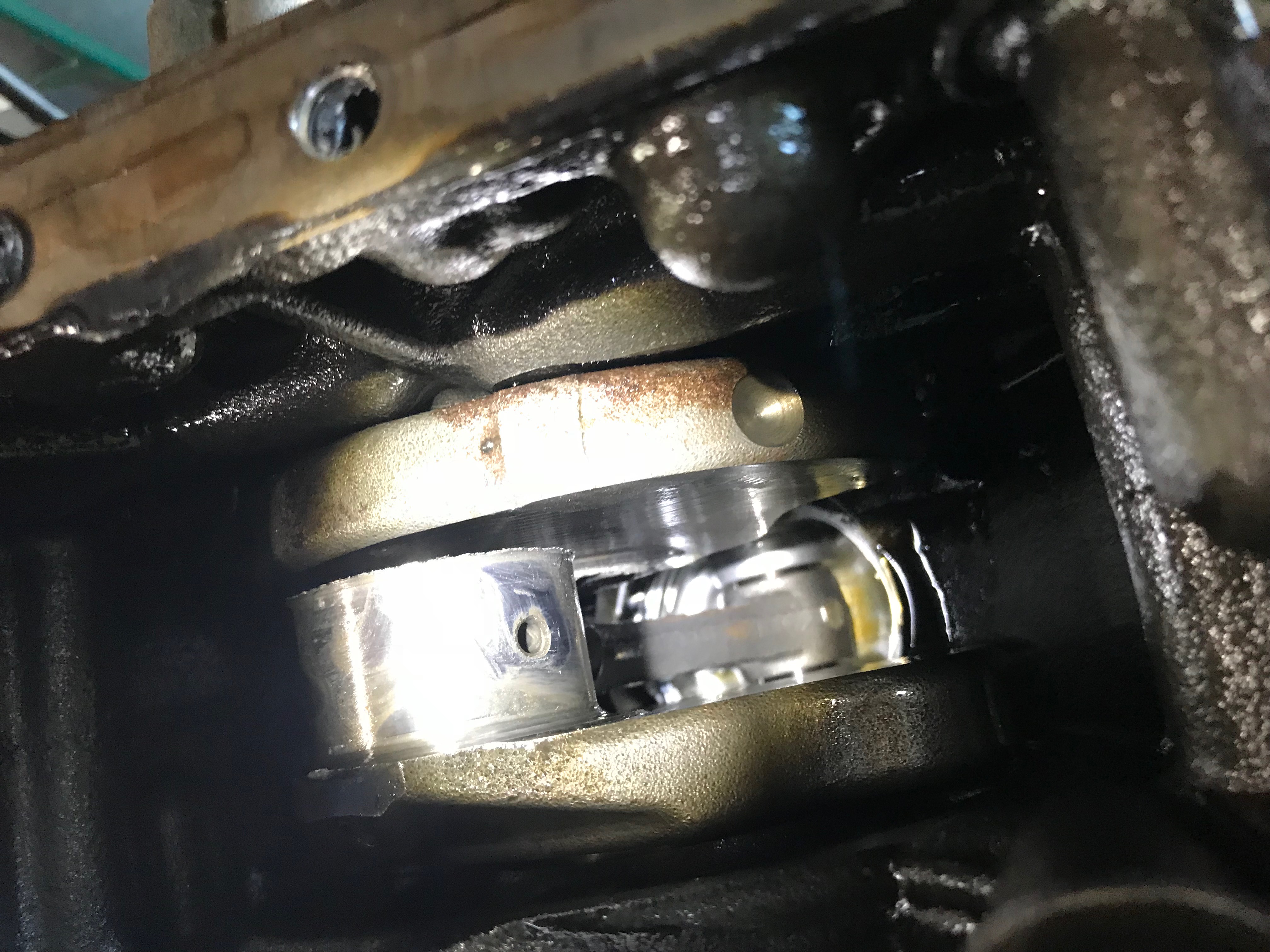

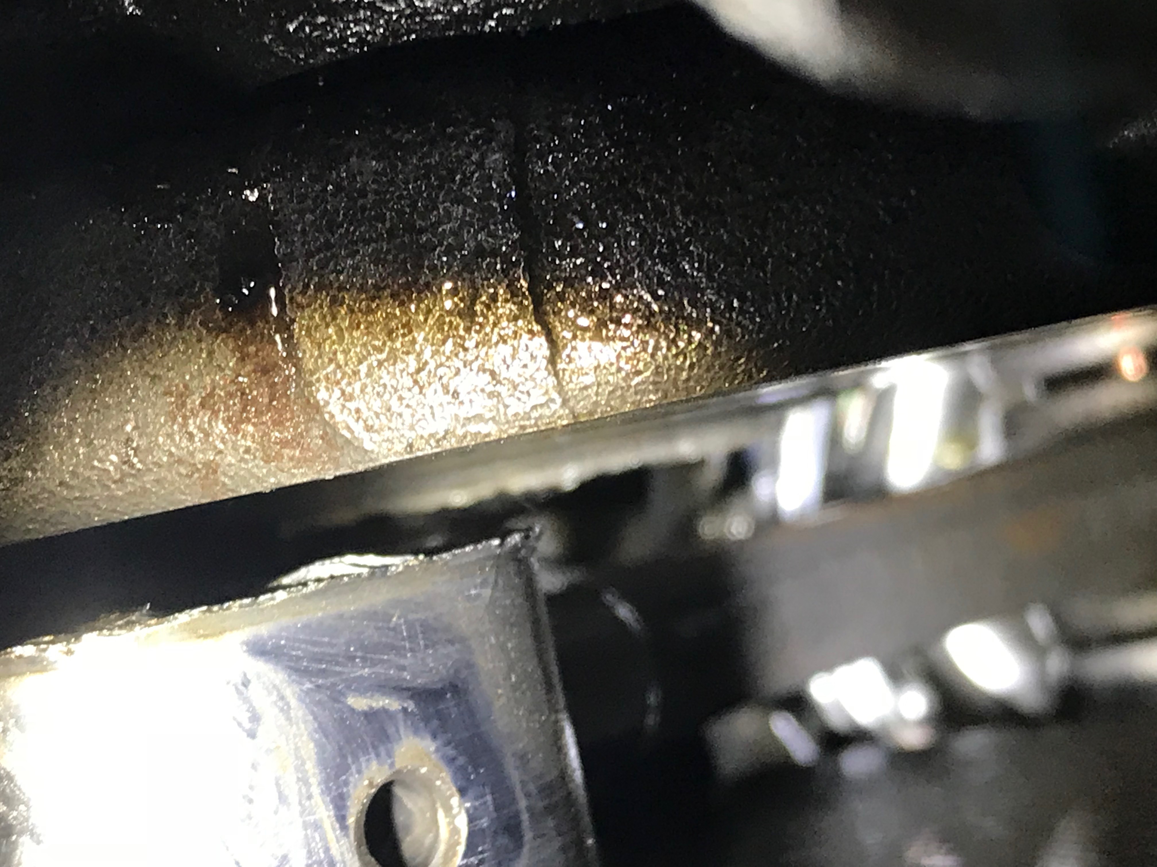

I will be pulling the engine completely out tomorrow hopefully and will be able to drop the oil pan and verify but I have the timing cover off and when I turn the flywheel the front shaft doesn't move at all. I can turn the crankshaft from the front with a pipe wrench and at a specific spot it will bind a little then pop, all the while the flywheel won't move as well. Hopefully I will have a picture after I drop the pan.
A broken crank was the last thing on my list of possible suspects for sure but I'm not sure how else I would see what I'm seeing. I looked at a parts diagram just to be sure there wasn't anything I missed.

Has around 800 hours on it. He was moving dirt around the backyard, nothing more than what I use it for around my place.
I have verified it was the crank as well. Looks like no other damage and I didn't have a pump connected so everything else seems to be ok.
/ Kubota L3130 Engine Problems
Noticed it looked like the tractor had been apart before. Wondering if that was the cause, the rod bearing have some pitting in them but not sure if that's from when it broke.

So finally got a chance to tear into it more, a few bent rods and a lot of carbon build up in the cylinders. There is some scarring on the cylinder walls, it looks to me like whoever owned this before never took care of it (possibly one reason for the broken crank). I went ahead and got a new motor shipped, should be here in a few weeks.

The only thing I can think of is, the engine has had a coolant leak into that cylinder . Possibly because the head bolts were not re torqued after the apparent rebuild by the previous owner . That piston may have had water/coolant on top of it when it was started, which bends rods and can also break cranks .
It may have even ran like that for a while, without the front pulley and fan turning if the operator hasn't got an ear for things .
