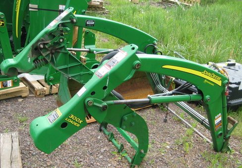

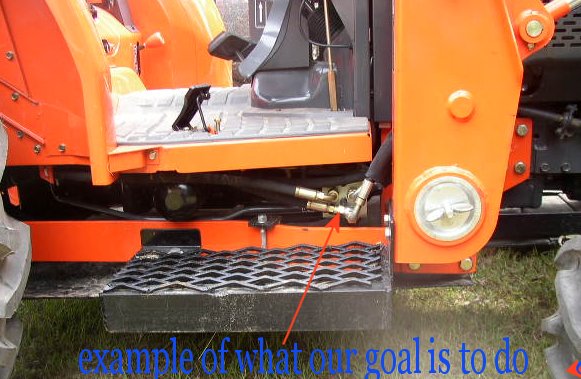

To better inform what I have been doing, here is the loader we are using, ( yes a JD ) loader, but my friend got what he though was a decent deal, and though it was a cut and dry install, though we knew we had to make up the new mounting brackets and that was the most difficult to do, we've had it on and all will work fine as far as clearance as well as fitting, the control valve easily accessible up on the tower, with plenty on line to reach under the floor board to the accessory block,

You are getting all mix up. All three of your pictures it shows the cover plate that has to come off. It takes a 12mm wench and it was posted before that the holes under that plate was threaded, I'm not sure about that, if not you have to make or buy a new plate. It's not called a accessory block , it's called hydraulic outlet block look under that in the parts manual.
   / Kubota L3130 Hydraulic accessory block #13
I was writing at the same time as you were posting. I'm talking about the 1st pictures you posted. The way you are headed is the hard way. But It can be done.
   / Kubota L3130 Hydraulic accessory block #14
That hyd block is there for a reason. Locate the cover cap with threaded holes.
You could also cut the line from the pump and install the loader valve in series. Then the loader valve will provide the relief pressure.
Right now, your tractor relief is on the bottom of the hyd block.
Send this picture to Messnicks and tell them you want the hyd block with threaded ports for your tractor..

The cover that is on the tractor now just has the ports tied together, the block that bolts in place of the cover isolates the ports and connects them to threaded ports that go to lines for the hydraulic valve.
You need to go to the dealer and have a good parts guy dig for the number for that block. The block is a US made part and you may have to check on the whole goods side to find it as it is part of the loader install package. The block you found under the option section is for the rear hydraulic remotes and not suitable for loader connection.
