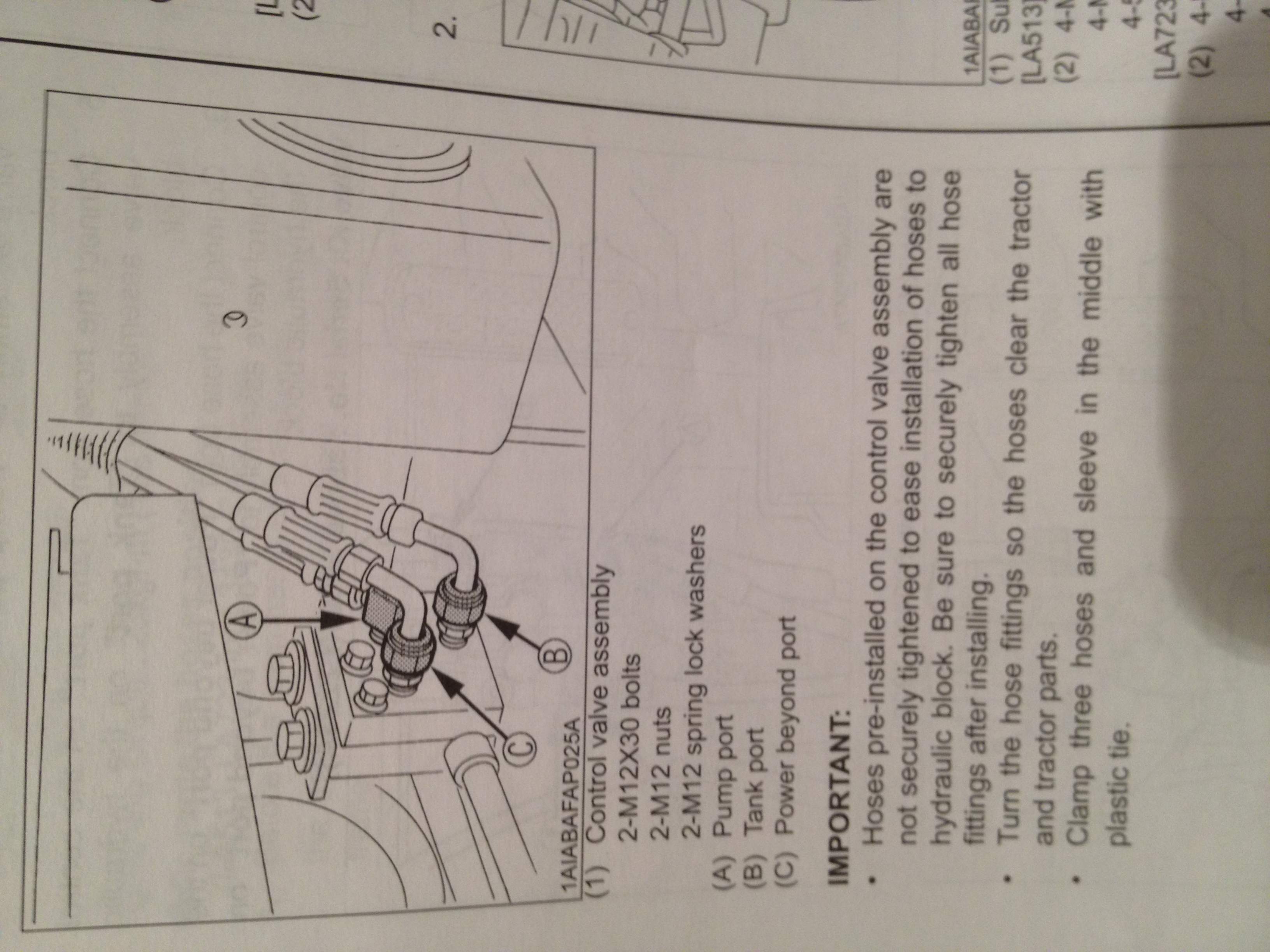

I don't know if it will help, but attached are a few photos from my 723 loader instructions.
(Not one of the photos below)In Section 3.2 Checking Parts they show item 9 as a Hydraulic Block [L2203, L2213, L2223, L2213A, L2223A]
Item 1 in the 2nd photo below is the Hydraulic Block referenced in Section 3.2 (Reference above)
