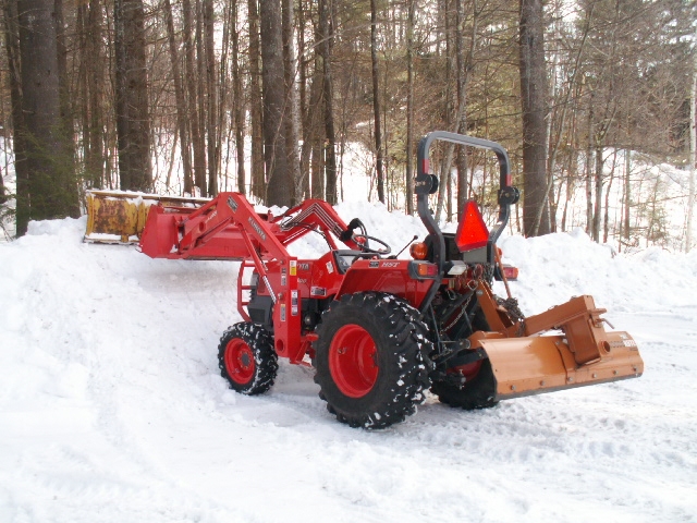

My setup different than what your thinking of,I didn't have any problems.
Are your rear tires loaded or rear ballast?

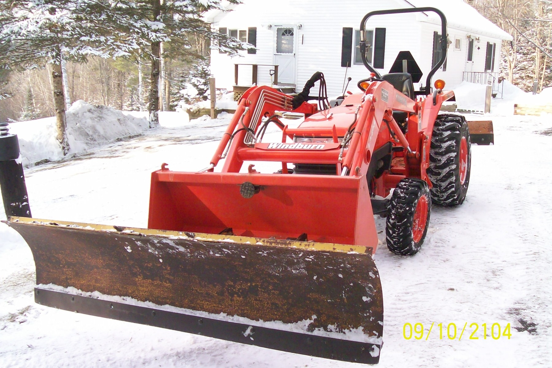

I had an L3200 and used a rear blade and loader for a while. Then for a couple years ran a Pronovost 64" rear blower. Best thing so far is the QA mounted blade on the L4240. It's a lot faster than anything else and being mounted on the FEL means snow can be piled up easily. Whatever you do, make it so the blade is suspended on a chain so it can be floated with only the weight of the blade. Do a search for "underslung snow plow". A few of us built them and this method helps prevent the plow from becoming a rudder.
