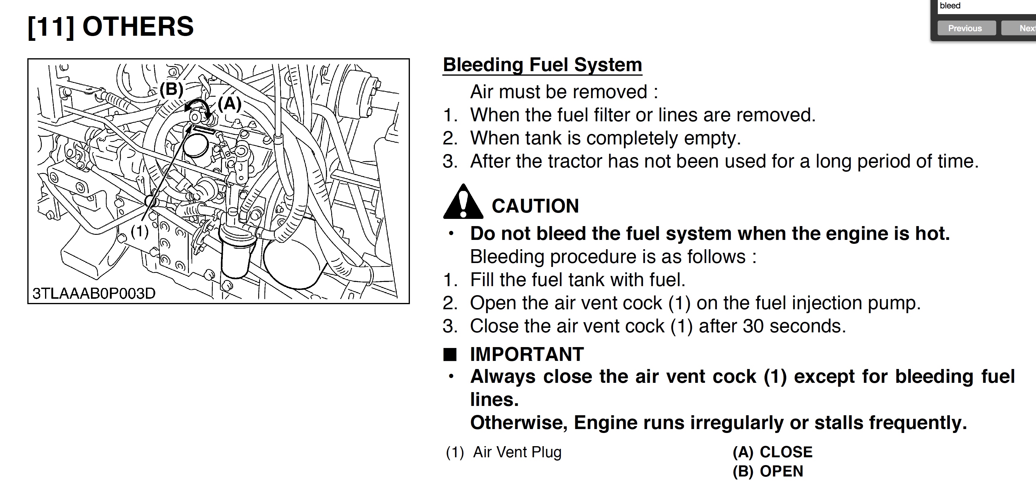

Please bleed those injectors before you go to any more trouble. That the symptom is under load (going uphill) suggests that fuel delivery is weak only then ... when the governor tries add more to keep rpm up there. Air in the lines may compromise the greater pulse needed to deliver that higher (-est) amount.
I rarely blame something I've replaced more than once, but that's just me. Good luck with this. I agree that no harm was likely done to the machine.
   / Kubota L3200 stalled after running kerosine #35
Most of these machines are self bleeding and I'm not sure how long it would take to get the fuel out of the lines but not long. A lot of the fuel ends up getting pumped back to the tank.

Thanks guys.
Total run time was about 5-10 minutes after adding kero. Temp gage was about 1/4 up from dead cold. Just in normal operating zone.
After draining the tank, changing the filter and refilling with diesel, another 5-10 mins. Same after I came back and ran it again. It did feel down on power even after refilling and up to the point it choked.
Total run time on questionable fuel, less than 20 mins.
I'll try draining the tank and cleaning everything out including purging the lines. . and I'll check injector spray. I ordered a set of injectors (returnable) just in case.
I would have thought dirt or water would have been caught by the filter/separator, as that's kind of it's job.
I'll keep this thread updated.
If you don't already have the Work Shop Manual for it download it for free HERE . If you don't have the owners manual with bleeding procedure, attached is the bleeding procedure from the WSM:
