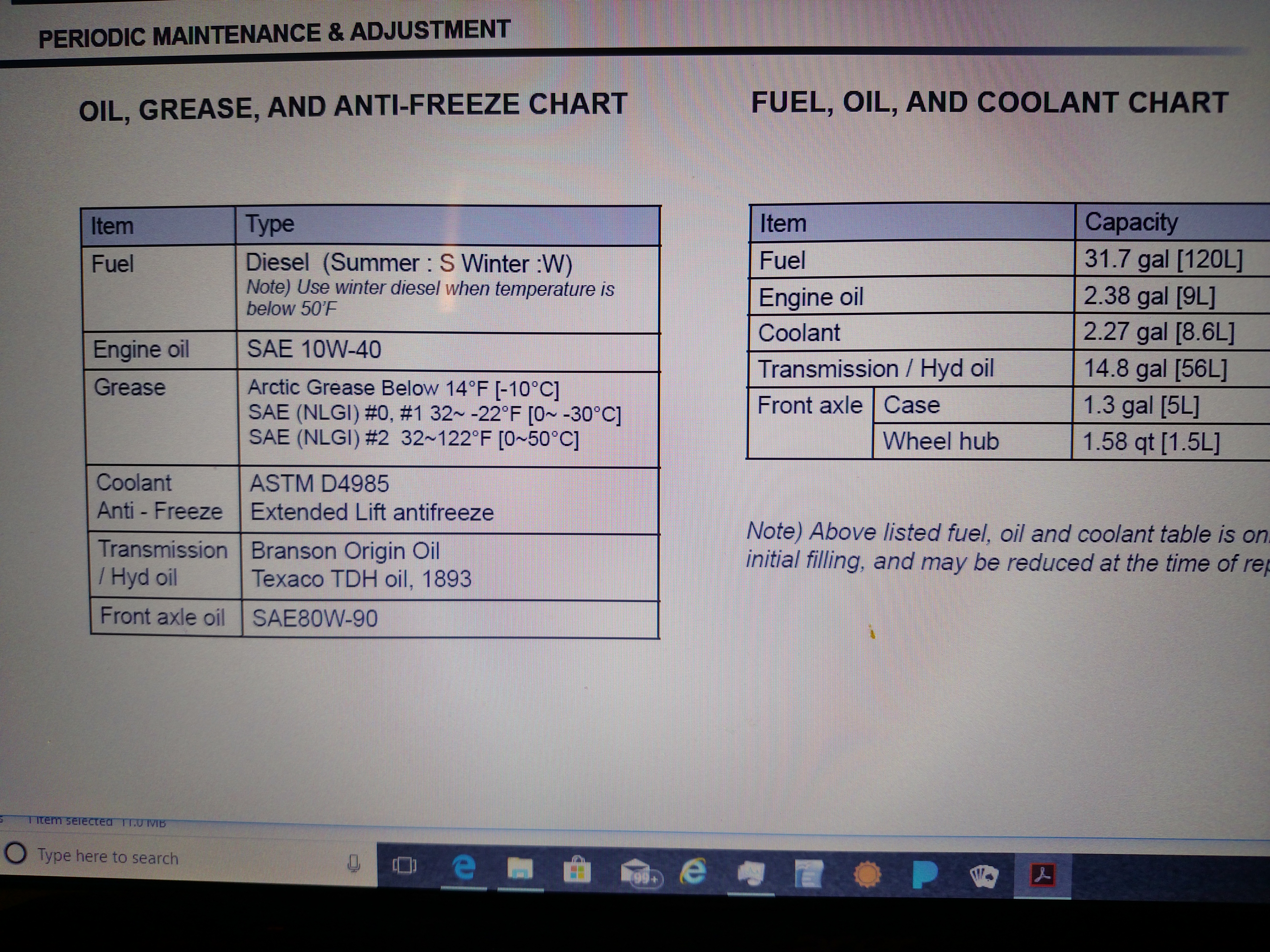

This doesn't address the OP problem;
but it may add fuel to the flames :laughing:
copied from my owners manual for a 2015 model;
to everyone worried about blending or cutting #2 fuel
Winter fuel being #1 diesel which is kerosene
   / Kubota L3200 stalled after running kerosine #46
LouNY -- "winter fuel" is not #1 (kerosene.) I am reasonably sure what your manual is saying is go to winterized fuel (which could mean anything, additives in it from the distributor, some % kerosene, who knows). Nothing on the page you uploaded implies kerosene that I can see.
