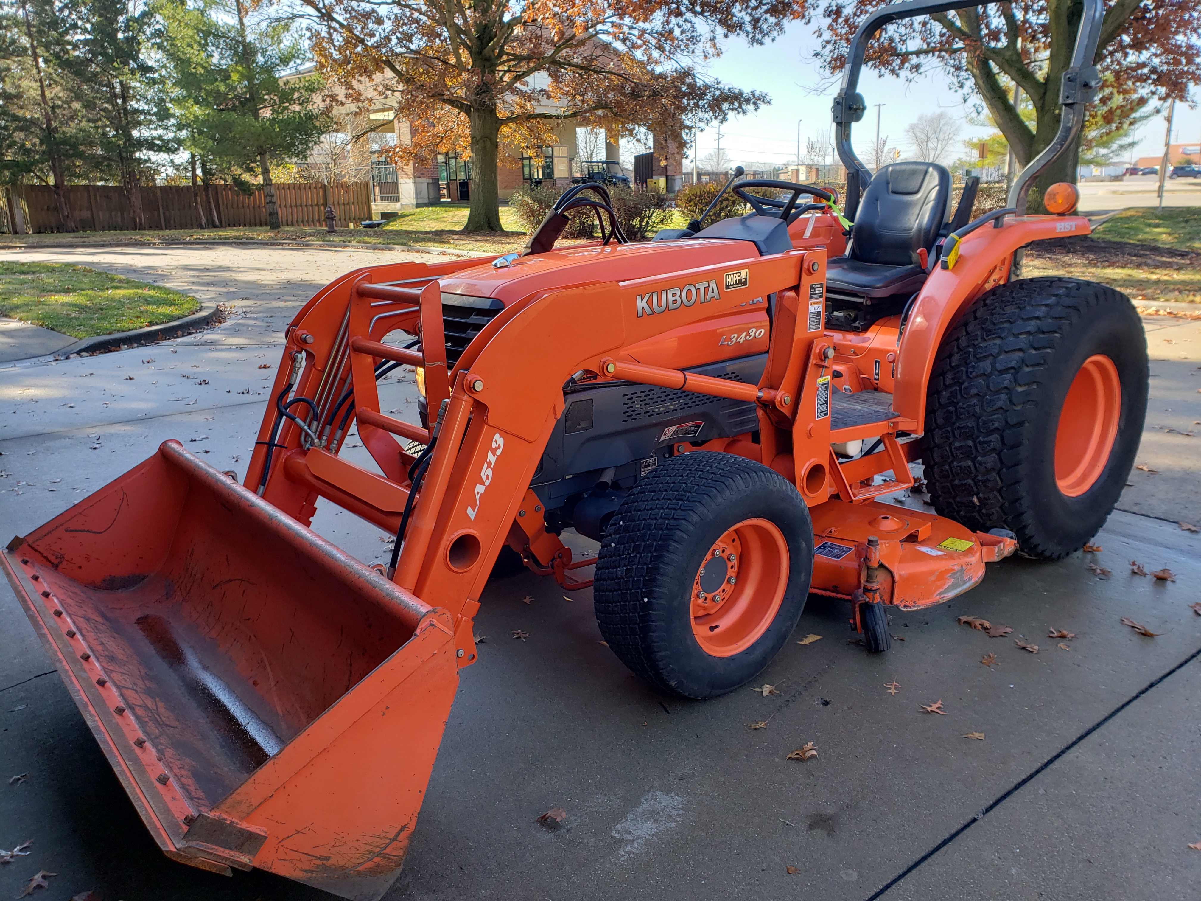

Hi all. Brought her home yesterday. Here are a couple of pics that I took this morning. Have started my list of things that I want to do such as add quick-tach plate to the loader and rear hydraulics, as well as a few implements such as pallet forks, 3-point boom pole, and eventually a grapple. Looking forward to learning from y'all.

Check the 3-pt with a load. Upon slow lift some of these studder and jump a bit. I've learned to work with mine but "feathering" an implement is difficult.
Other than that I very much like my Grand L3130. It has all of the power and traction I need with R-4 tires.

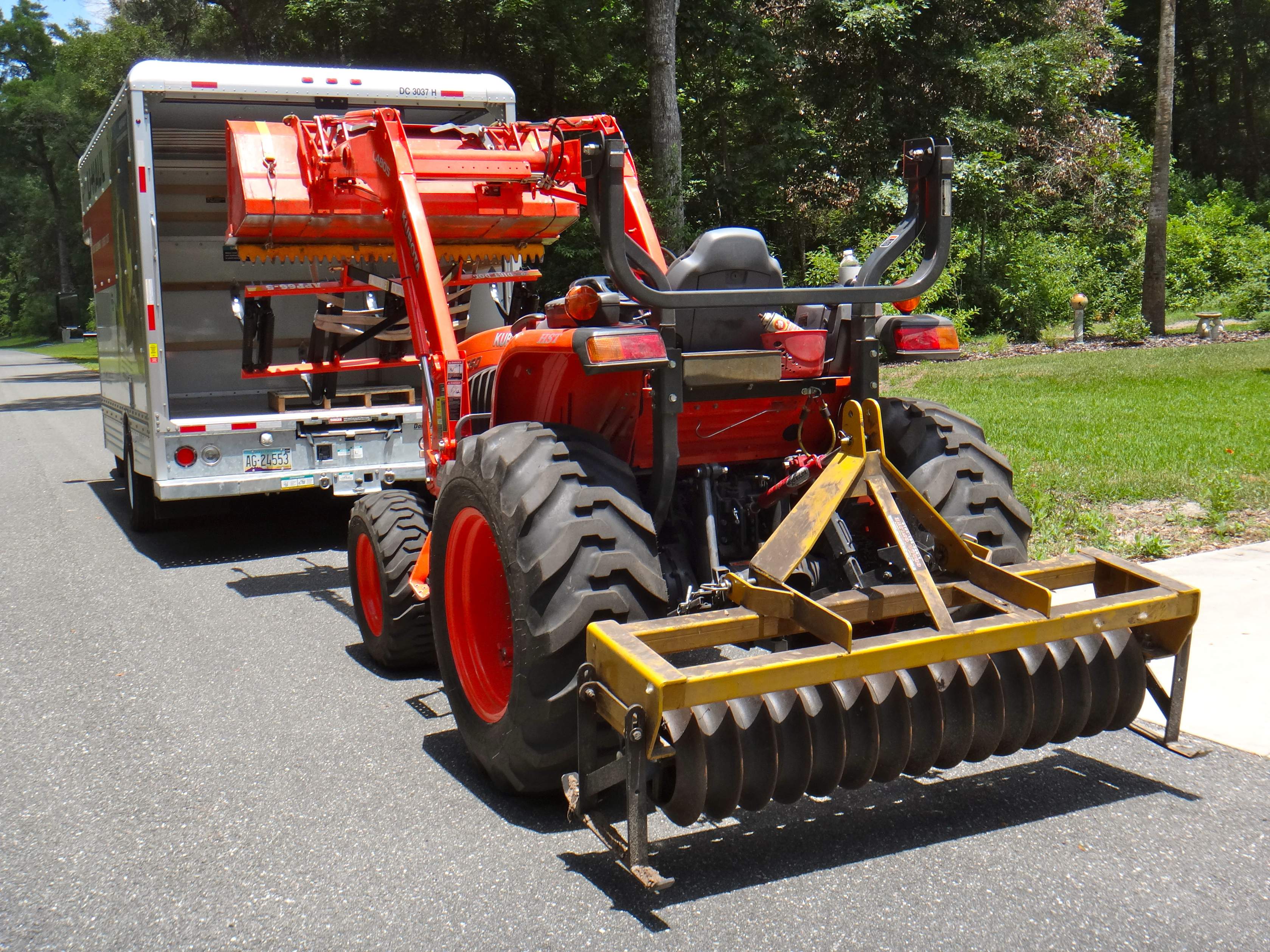

For many tractor tasks bucket hooks would serve about the same as a Three Point Hitch Boom Pole with the advantage that bucket hooks are always on the tractor. Photo #1. Field Cultivator (load) shipping weight ~~300 pounds. Cultipacker counterbalance 600 pounds.
You can LIFT to your FEL capacity.
But you should PULL prudently, changing load to rear/center or rear cross-drawbar before much force is applied, or you may separate FEL from tractor.
LINK: Ken's Bolt on Grab Hooks <<Kubota Hooks>>
Your L3430 is a two increment predecessor model to my L3560. You will need Three Point Hitch counterbalance of at least 600 pounds, assuming loaded rear tires, for max FEL lifts.

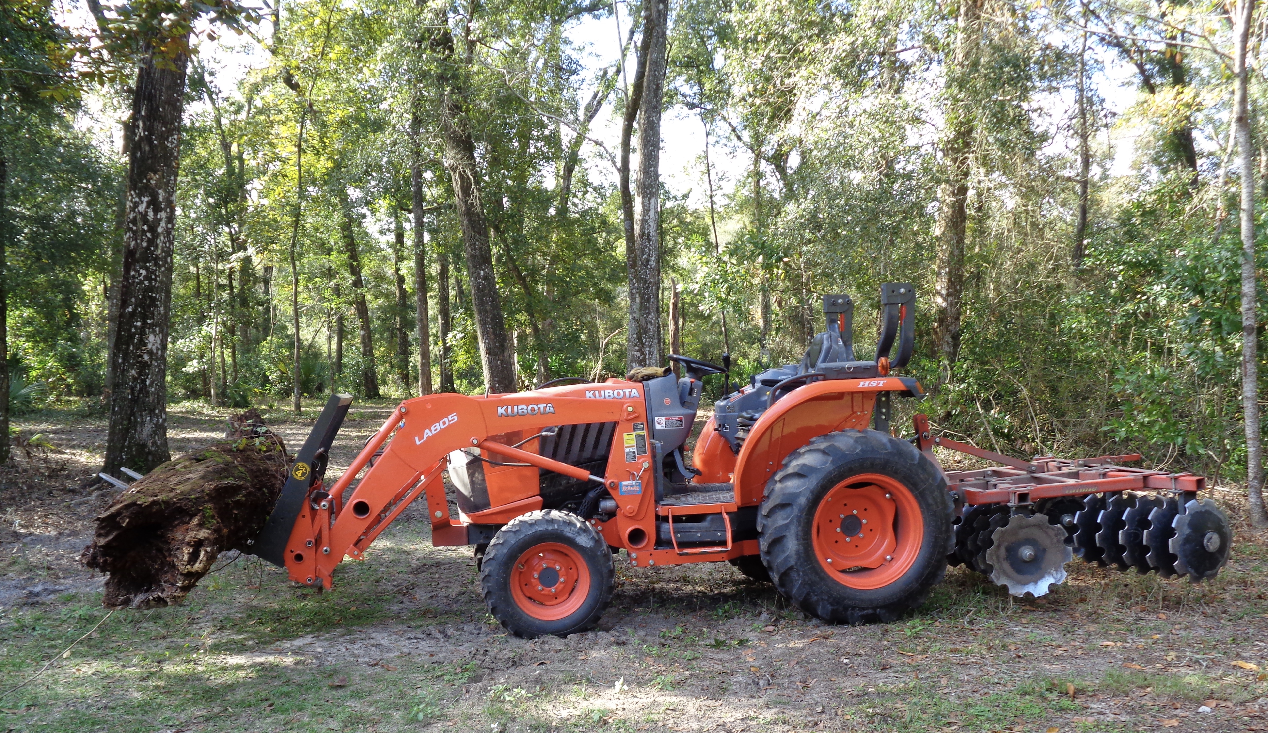

I have air in my rear tires. For max FEL lifts I attach my 1,000 pound Disc Harrow. Since it extends w-a-y back, leverage increases its utility as counterbalance, at the price of maneuverability. Photos #2 + #3 from yesterday. ROPS folded because I was working under tree branches.
Saturated Oak trunk weighed perhaps 1,200 pounds.

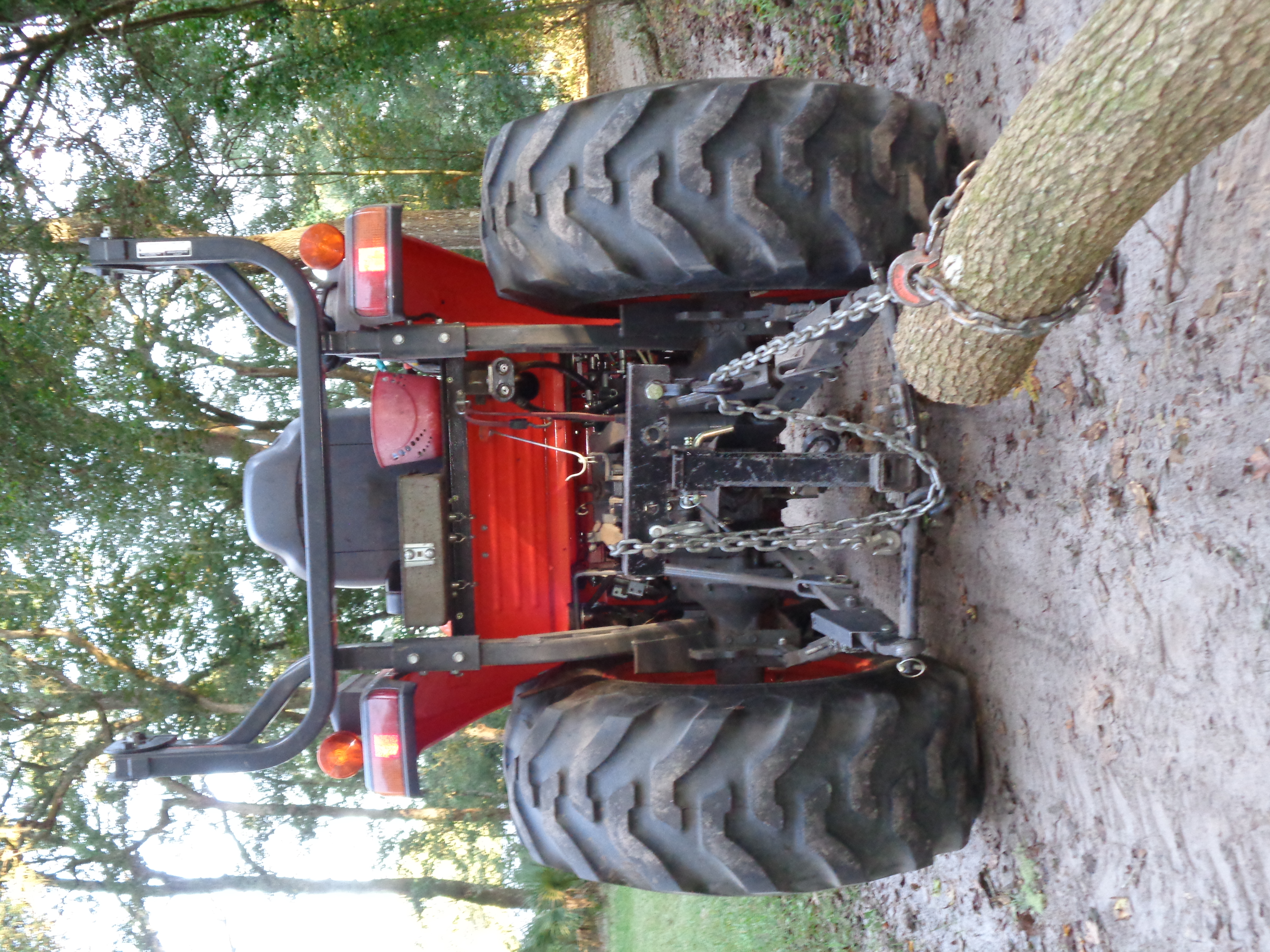

For skidding logs a Boom Pole is not the best implement. The load is too far back, too high and the pole is subject to a transitory stress flexing. Safer a rear cross-drawbar with a "hanging tree" to facilitate trunk elevation. Photo #4.

Agreed on the boom pole usage!
I have had one sitting in the barn for 30+ years.
NEVER use it!
