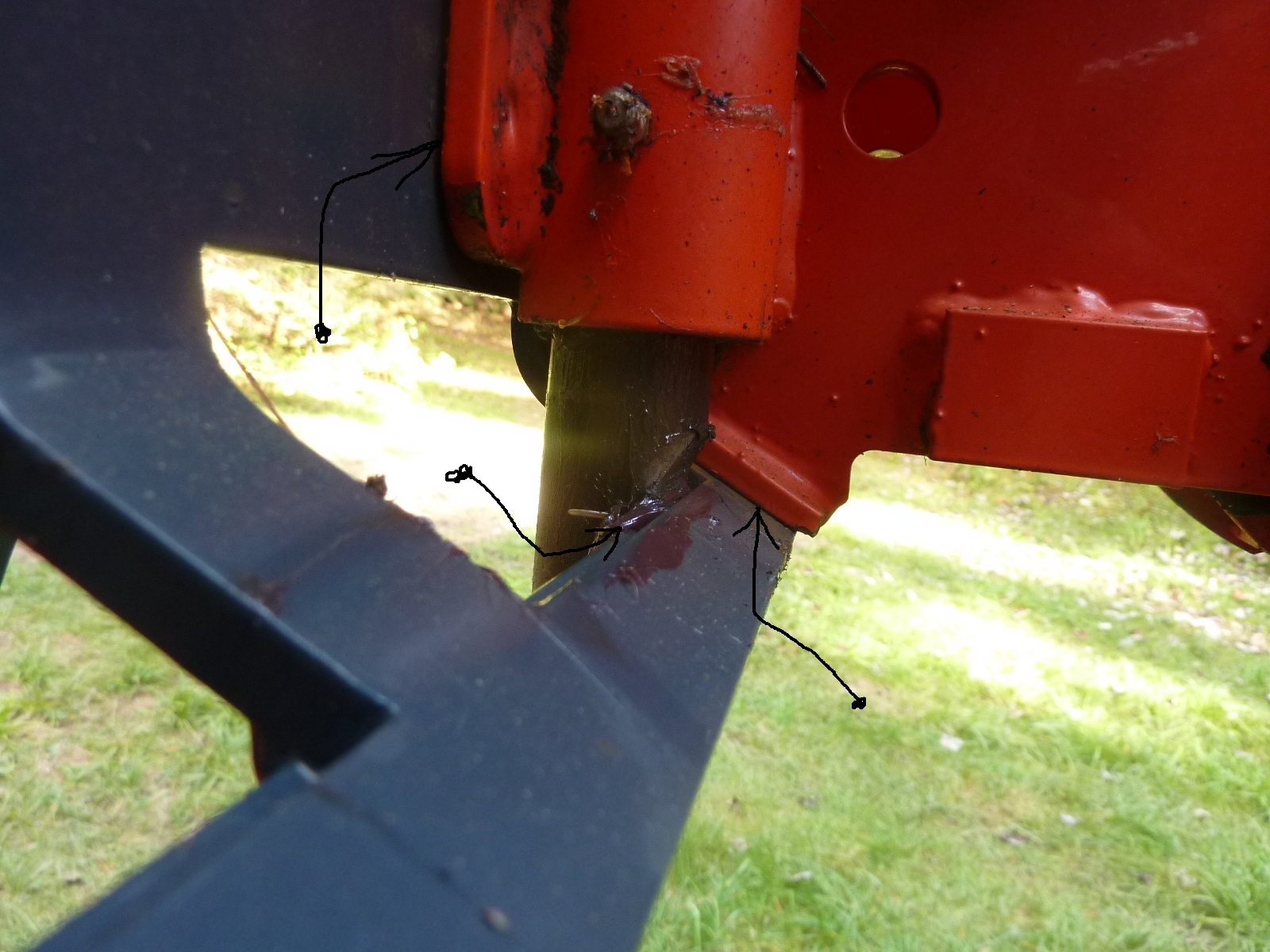

Proper fit of a SSQA plate and implement requires a tight fit, contact fit as no gaps, in 3 places. The black arrows on this picture shows where they are.
It seems that it is fairly common to have an ill fit. There are so many variations of tractor and implement. First make sure your bucket is sitting flat against the SSQA plate ( top arrow ). Then if you have a gap between the pin and the bucket or between the angled portion of the bucket mount and the lower angled part of the SSQA plate weld in shims to obtain the proper fit. Pin contact should be well up on the pin not at the tip. The spring just changes the pressure required to tip over the cam type latch when engaging the pin.
