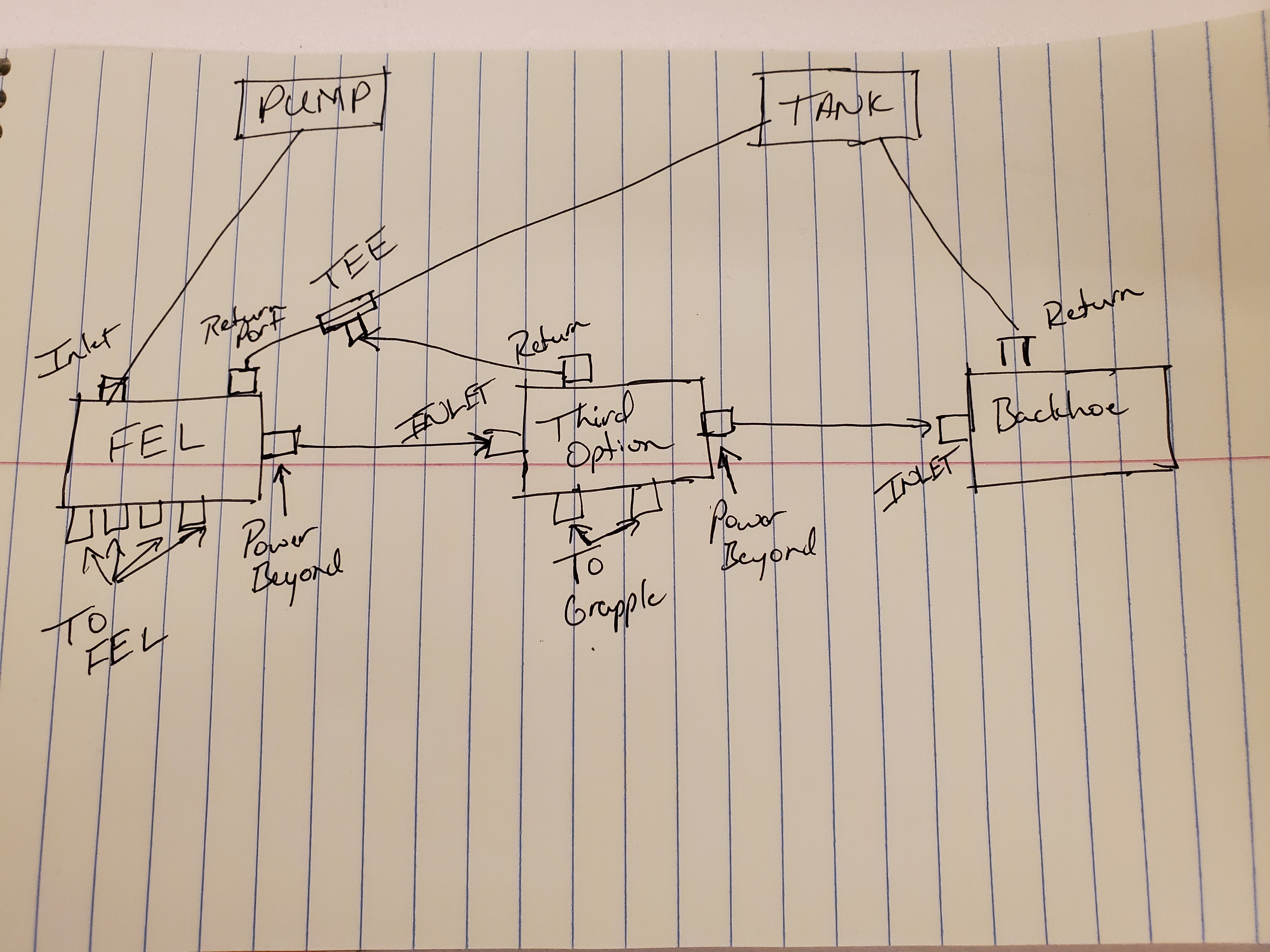

I finally broke down and picked up a third function kit and a grapple for my Kubota L35.
I bought this kit from Summit Hydraulics
summit-hydraulics.com/product/hydraulic-third-function-valve-kit-w-joystick-handle-for-tractor-loader-21-gpm/
And I got this grapple:
mtlattachments.com/attachments/72-mtl-hd-root-grapple
Also got the WR Long quick tach pin on adapter.

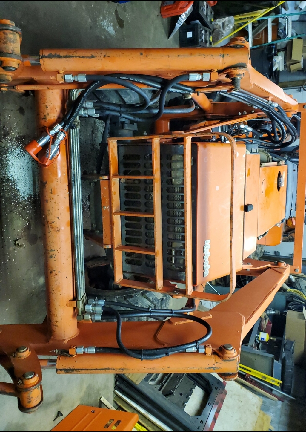

And then the adventure began. I made a mounting bracket, twice. Two trips to the tractor parts store for hydraulic hoses. Two trips to Napa for fittings because I forgot one. And one reorder because they left out some of the electrical components when Summit shipped the valve.
And it still doesn't work.
The backhoe works fine and the third function has pressure but the front bucket valve has so little pressure it won't move. I'm using the power beyond port out of the FEL valve to feed the new valve and the power beyond port on the new valve to feed the backhoe. Backhoe works fine so the pressure is correct passing through.
I'm at a loss.
Any idea what I'm doing wrong?

Your drawing looks correct.
My next step would be to re-attach the FEL power beyond port to the backhoe inlet. In other words take the new valve out of the circuit. Then see if the FEL starts working again. That would isolate the problem to the new valve.

Looking a bit deeper into your system,
did you install the power beyond into your new valve?
Looking at your drawing your FEL valve should have had a power beyond already installed in it.
Then did you install the new power beyond into your new 3rd function valve?
I didn't look deep into that valve but;
P Port: Connects to equipments power beyond port
T Port: Connects to return line / tank reservoir
A & B Ports: Connect to cylinder lines
So the power beyond from your FEL connected to the P port,
the T port is tee'ed into your existing return line,
the A & B ports go to you new cylinder,
was there another port identified for the new power beyond plug to be installed in?
You state that when activating one solenoid you are getting fluid to both work ports?
Is it connected to a cylinder or just open ended hoses?
one port should have system pressure, the other should be just minimal system return pressure.

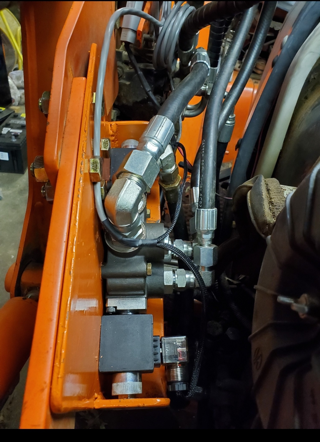

I took both work lines off of the grapple to make sure I had all air out of the lines and realized that when one side of the valve was actuated both lines were pressurized.
I just went and picked up a check valve and installed it in the return line off of the new valve and before the tee. The grapple functions now but only opens when the solenoid is bumped. It closes like normal.
I've called Summit and they're sending me a new valve to try. Maybe that's what's wrong. Please let me know if you have any other thoughts.

I'm thinking you have the valve plumbed backwards. Got a good link to the valve and maybe some better pictures?
In your first pic, that hose on top of the valve, where does it go?
That is the return line. Goes to a Tee in the return line of the FEL.
This is the layout I have.
/ Kubota L35 Third Function Valve Install #16
I can't see anything obviously wrong... I'm actually wondering if they somehow sent you a valve with the wrong spool installed on it.
These valves can be setup with various types of spools that can mix all kinds of ports in various positions. Some will block both work ports in Neutral, others will have a port open to tank in neutral, and so on.
