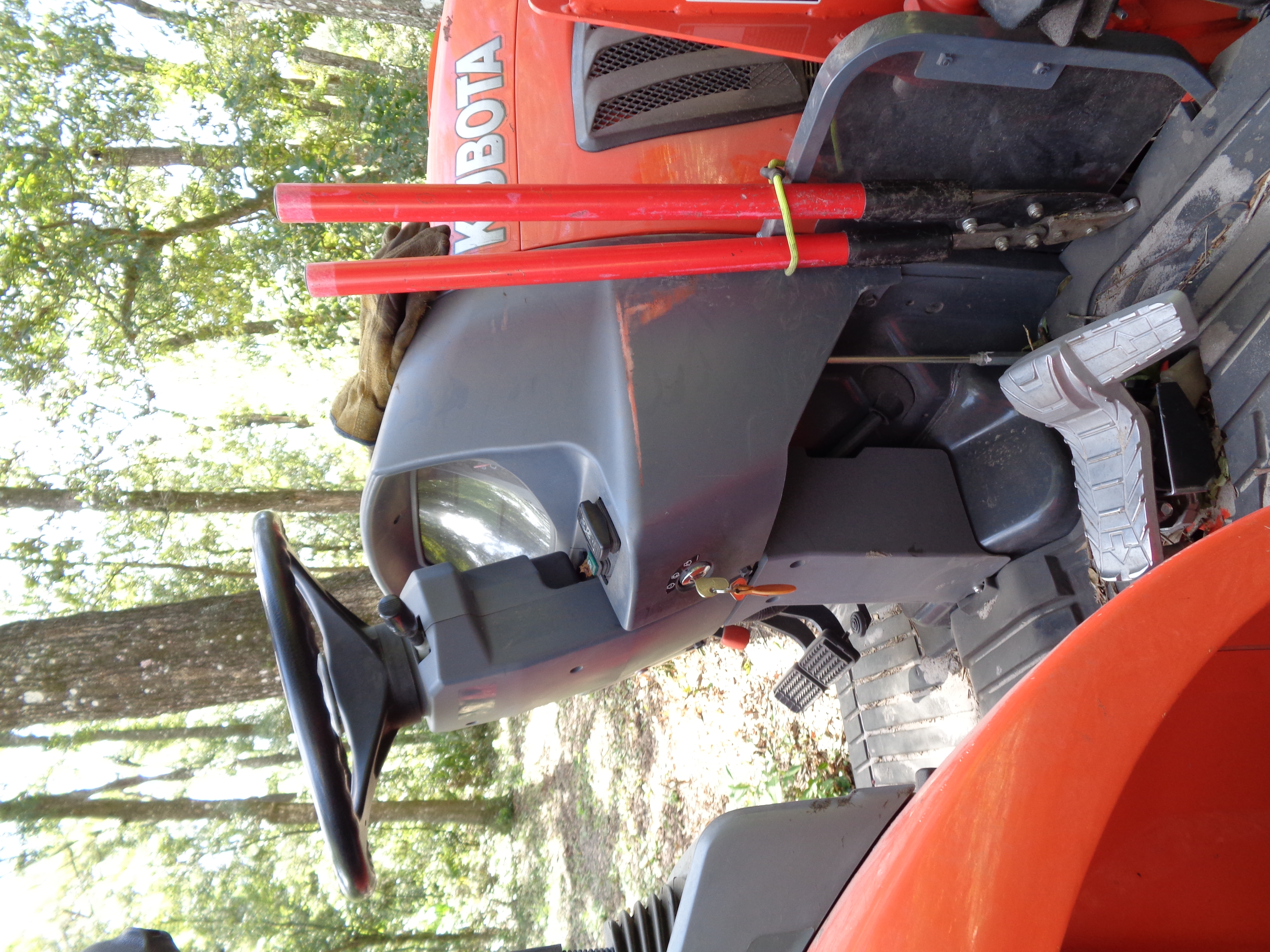

What stays on the L3560 evolves.
I have replaced the Milwaukee Sawzall with a set of large loppers, secured by a "GearTie" Loopable Twist Tie from Home Depot.
The loppers work better for me when vines wrap around the wheels. With the Sawzall vines often have to be steadied for the saw blade to cut. Loppers work without steadying. Loppers take less space. Loppers do not need to be electrically charged.
The GearTie is more secure holding items. A couple times the Sawzall snagged something, the bungee stretched, then the Sawzall fell to the floor of the operating station.

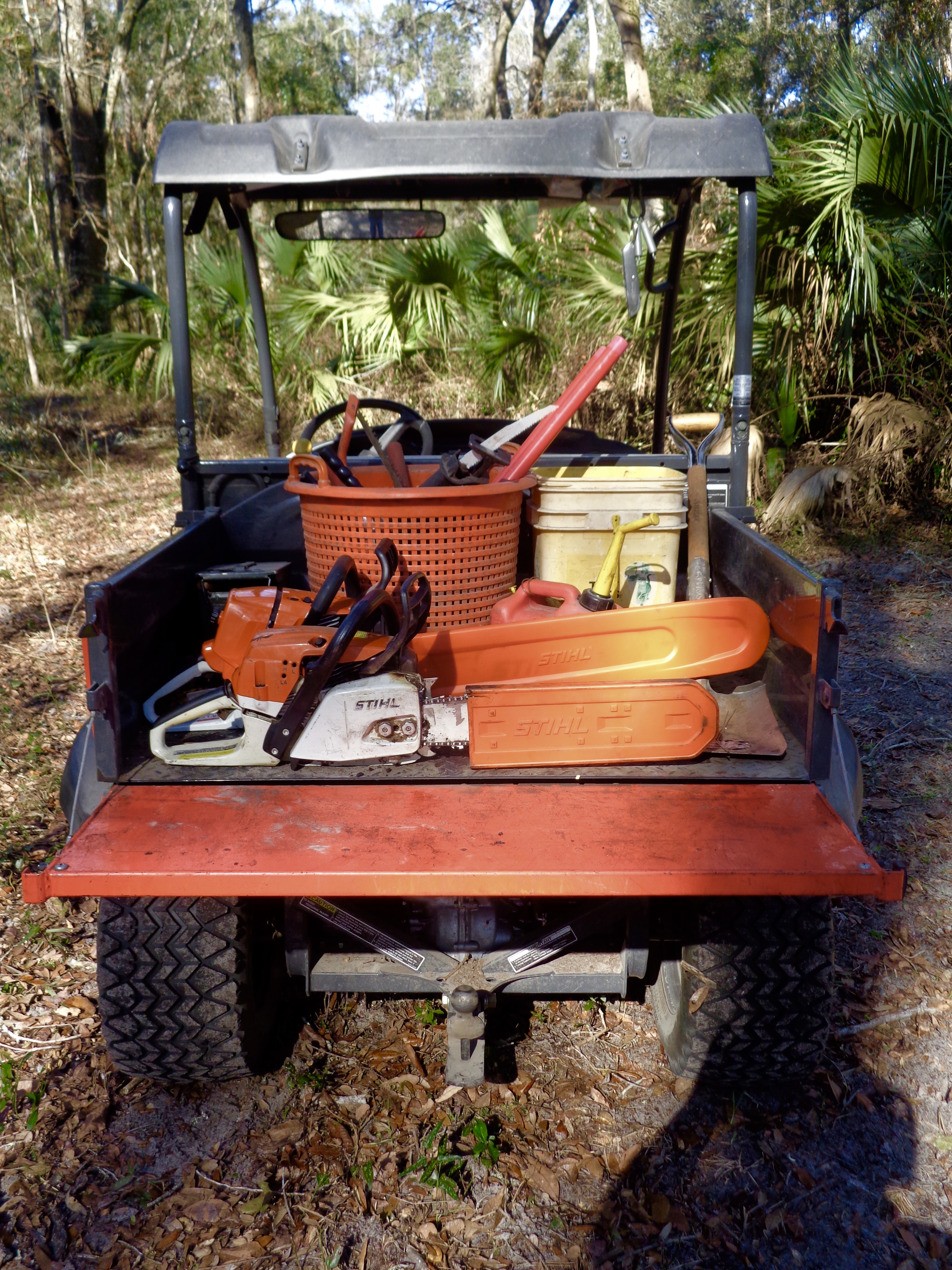

I find the Sawzall more useful on my RTV500 in company with two Stihl chainsaws, for trimming tree branches.

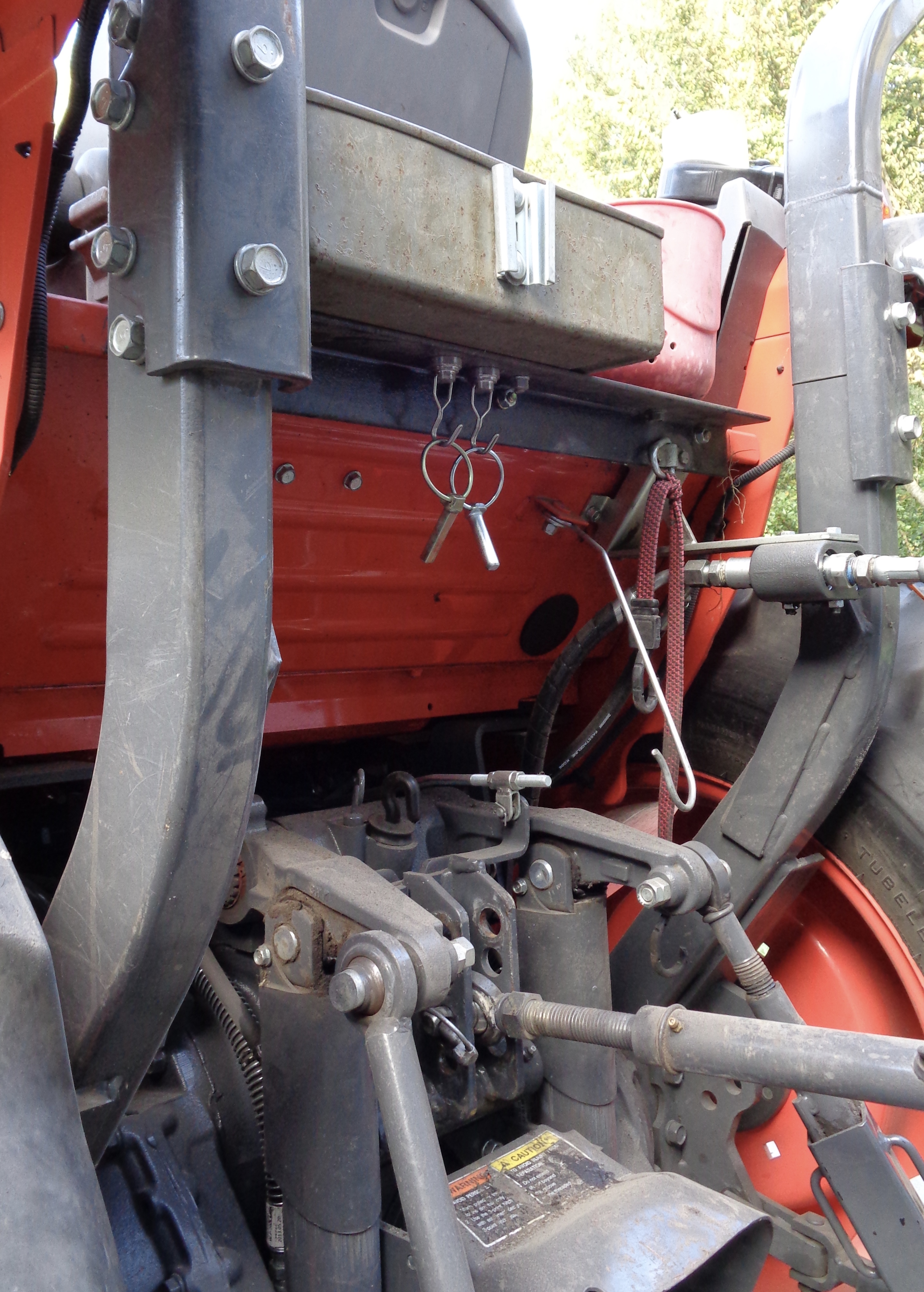

I have had Neodymium magnet-hooks attracted to the rear of the tractor to hold lynch pins for two years, without magnets moving a smidgeon.

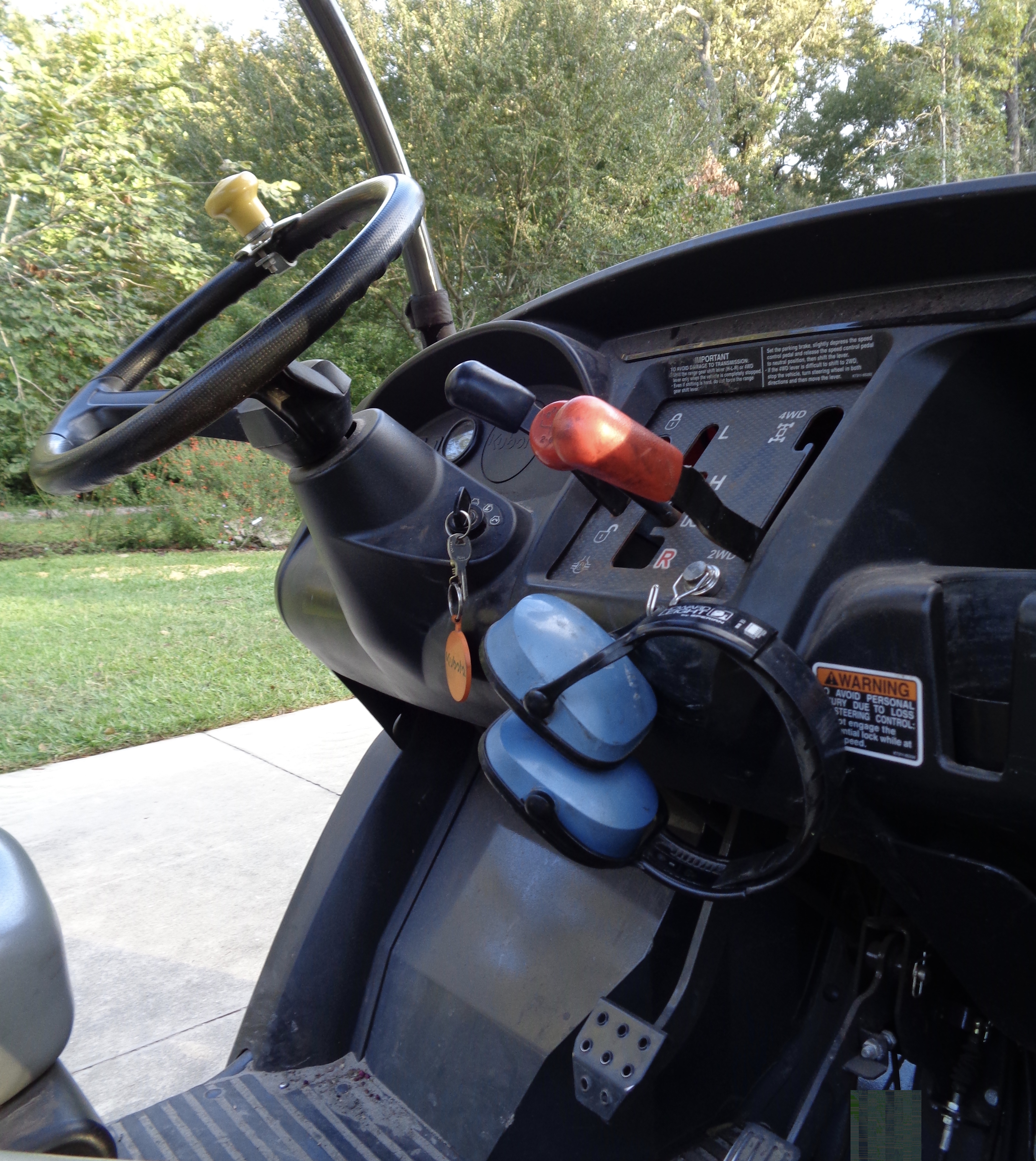

I also use one magnet-hook on my RTV500 utility vehicle to hold ear muffs and electronic dog collar control.
