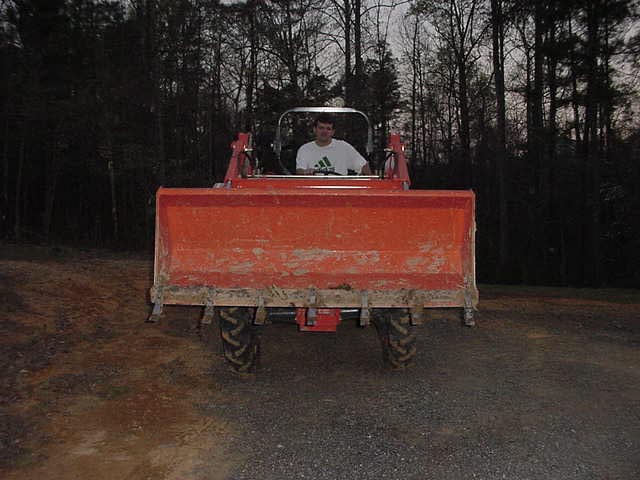

Here is a picture of my LA682 bucket with WR Long toothbar.

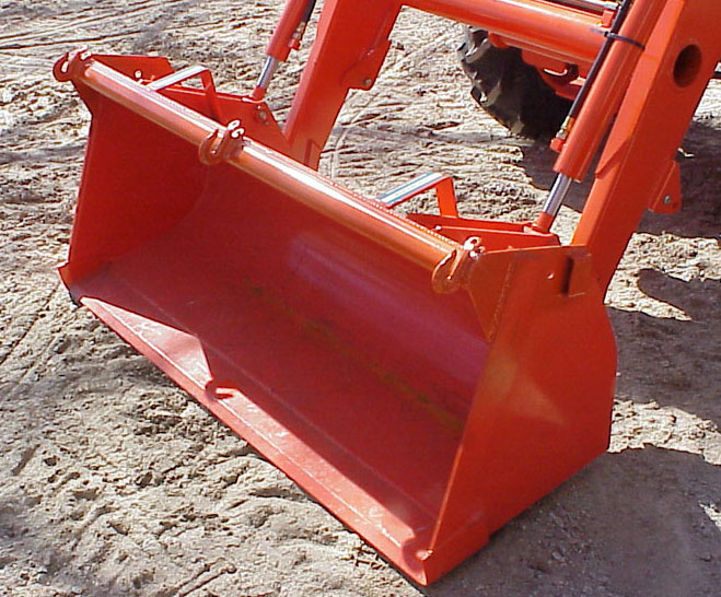

I have the heavy duty bucket. It really depends on what you are planning to use the tractor for. In New Hampshire, rocks are our best crop and I am going to be doing quite a bit of stone work, so the bucket makes sense. The guy who worked on my barn foundation last year had a 3600 with the standard bucket - and all sort of reinforcement welded on it. The roll back doesn't hold firewood quite as easy as the square back. The edge is not bolt on - but is MUCH heavier then the standard bucket. I guess if it asn't for all the rock work I would have gone with the standard bucket.

Actually the heavy duty bucket has a square edge back as well.
