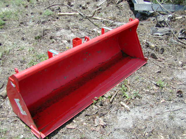

   / Kubota L3710 LA682 Loader Heavy-duty Bucket #15
Just wondering, since you are interested in a heavy duty bucket and also larger bucket, if the 72" heavy duty bucket for a LA852 loader might have the same hook up. One of these came with my L4610 and 852 loader, and in my opinion is not as large as the fel could handle. If you are interested, I would be glad to get any measurments off of it for you.

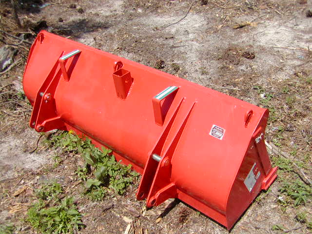

   / Kubota L3710 LA682 Loader Heavy-duty Bucket #16
Rear View of LA852 fel bucket.
We put the chain hooks and the goose neck trailer receiver on it.

I would have to say the bucket is about 60" wide, as advertised.
The chain hooks were welded on at the dealer as per my request. Original bucket was orange and they just touched up their work.
I would guess that the main body of the bucket is about .180 to .2" thick. As the body curves to the bottom, it meets a right angle piece equal to or heavier in thickness. This right angle piece forms the drag blade on the bottom back of the bucket as well as reinforcing the floor of the bucket.
The front edge of the bucket is about 1/2" think and easily accepts a toothbar.
As for the rock issue. I find I am often moving rock that is at or above the capacity of this loader. The picture you saw was from when I received the tractor from the dealer. I must say the bucket is not so pretty now - no damage at all - but this is no hanger queen - this tractor works. It really depends on what you intend to do with the tractor. If you are using the bucket for moving snow and soil, you are probably fine with a standard bucket (which is a bit bigger). If you are building stone walls (BTW all the stone round here is granite) you will either want to reinforce the standard bucket or go for the HD version. The HD bucket will take anything I can throw at it and come out smiling - can't say I have as much confidence in the standard - but it all depends on what you are doing. It's raining toady but I'll try to get out to the barn later and snap a few more picts.
Hope this helps.
