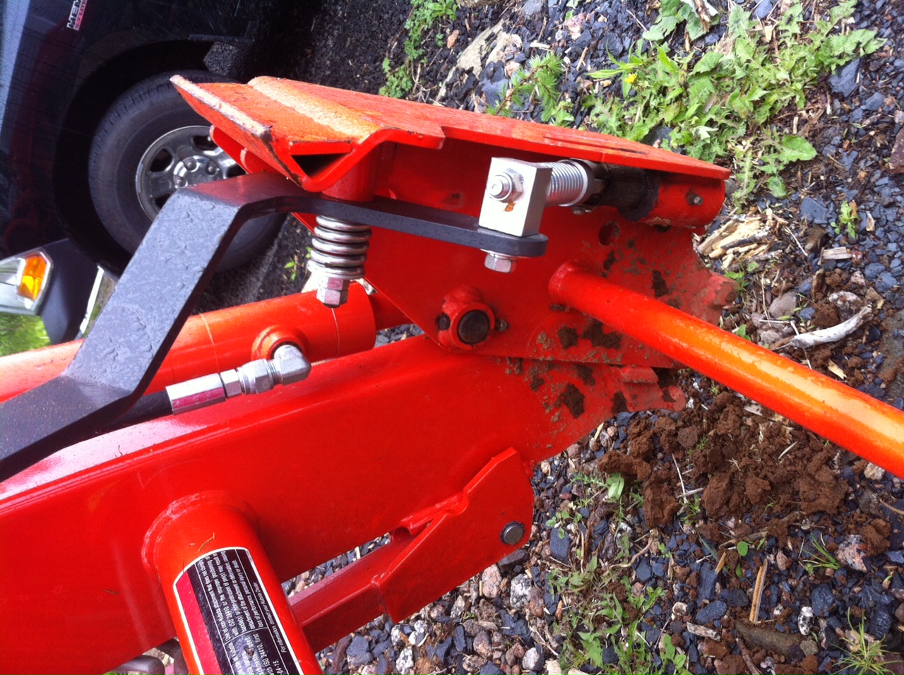

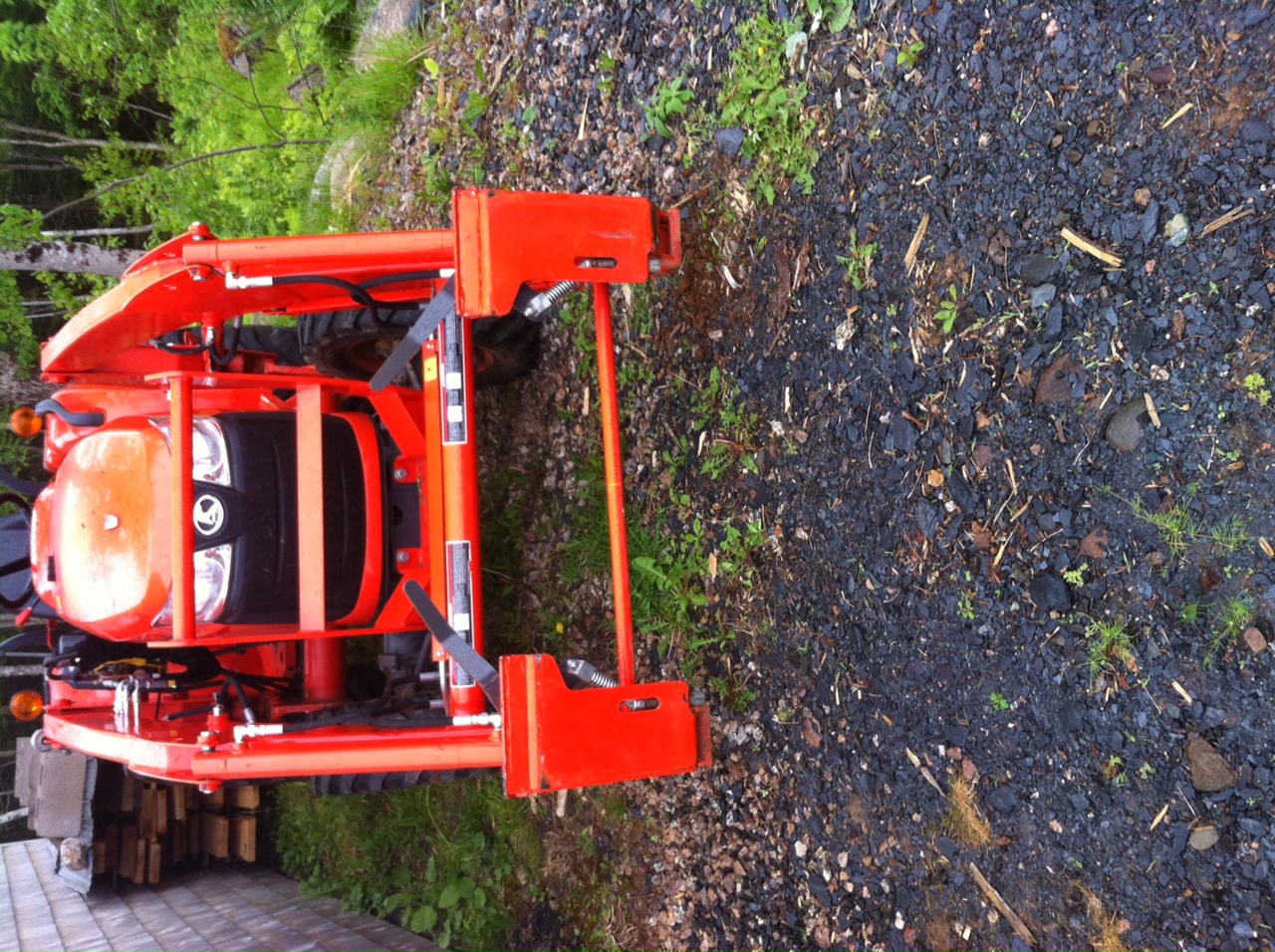

Good Afternoon
I was using my Tractor today with the forks in together to dig out rose bushes the wife wanted removed. I would drive in, get under neath and pop the roots up, it was going swimmingly well, making short work of the bushes and without a drop of sweat!!
Then on my second last clump, i pulled out and noticed that one of the quick connects had come loose and the forks were only attached by the one side (right side i think...)
i lowered the FEL, and disconnected the one side and when i went to re-connect, i noticed that my cylinders were operating different speeds. The right hand side would go faster going down, but when the cylinder compressed, the right side would go up slightly slower.. this obviously caused massive problems trying to re-attach.

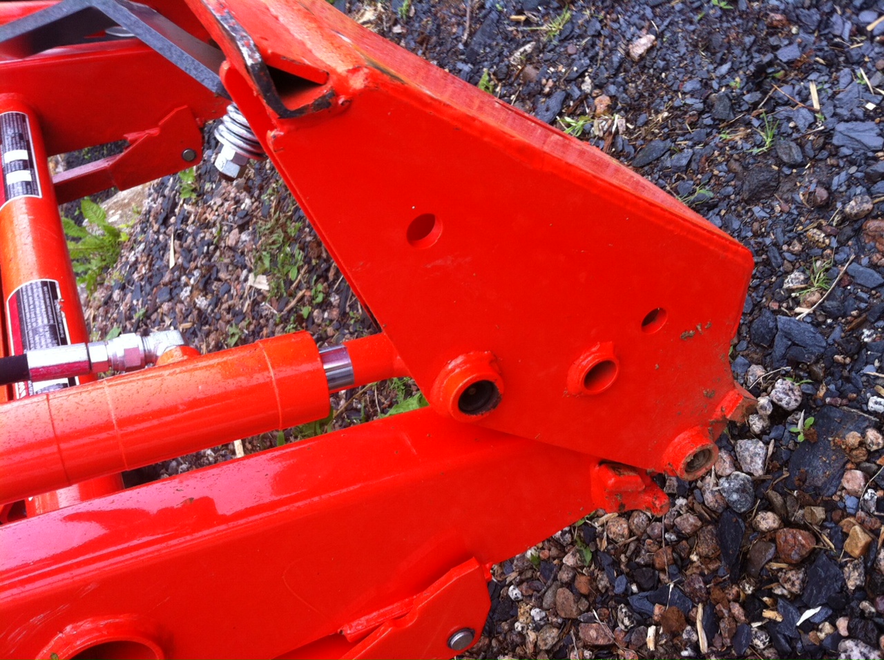

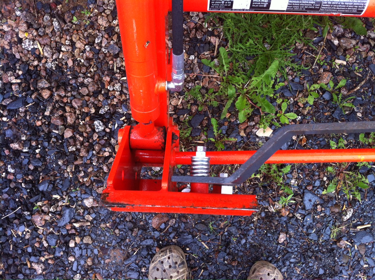

finally i got off the tractor and looked at things and it appears, that when facing the tractor, the left side is twisted maybe 3/4" to the left... so even when i try to by hand muscle the forks back on, it appears the "paddles"? that flip in are almost two wide apart..... best way i can describe the twist is that its like someone was facing the tractor and pulled the loader arm directly to the left....
hope this makes sense.. i am wondering whether anyone has had a similiar situation and can comment, or suggest what to do... i have a basic amount of DIY skills and my neighbor who has a case d40 is my go to guy for tractor lessons & help...
i added a few pics, before i turned the tractor off, i raised the FEL off the ground and curled it all the way up... and then went out 15 mins later, i found that the cylinder that seemed to have twisted has extended maybe an inch...

I read about this happening many times on TBN.
Its the toque tube (the tube running between the QA plates) are easy to twist if 1 side comes unhooked.
Its an easy fix.
Just twist it straight, or cut the tube, line it up straight and reweld.

If you put the forks on the left side (bent side) and put a 4x4 block under the fork - do this on level ground/pad then use down pressure to bring it back into alignment and attach the right side. You will probably need to go a bit beyond say 2.5" to bring it in.
Probably best to have your neighbor spotting with you on the tractor. Go slow and see if this brings it back into alignment.

Yep, you bent the torque tube.
/ Kubota L3800 Loader problems... twisted?? #5
You could heat the tube and re-bend it back, but,,
May need to replace the tube, once bent, it could be a weak link for future bends.

Put one side against a tree and slowly move the other side out with the hydraulics until it bends the torque back straight and both attaching points are back even.

took the QA part off by removing the retainer pins, then knocking the 2 large pins on each side
once the piece came off, it was more obvious to see the twist, where before you could see an obvious twist in the torque tube. My neighbor & I are taking it to a machinist tommorow(hopefully) and going to get him to twist it back , and bring it somewhat back to square. if at all possible i am going to see if he can make it stronger, perhaps a solid bar instead of the hollow tube...

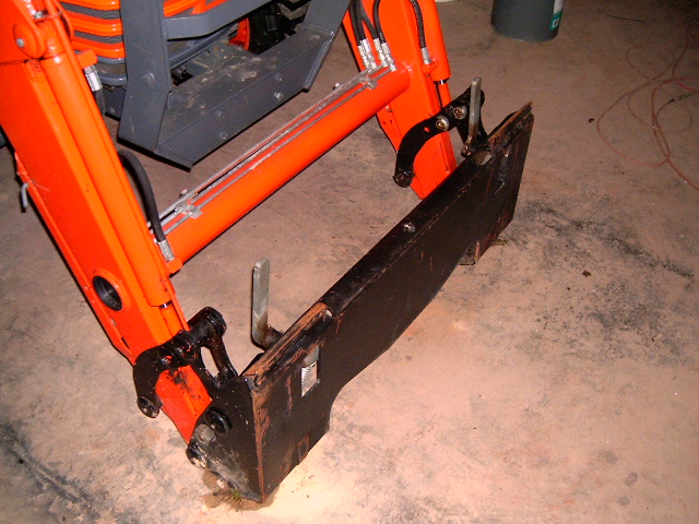

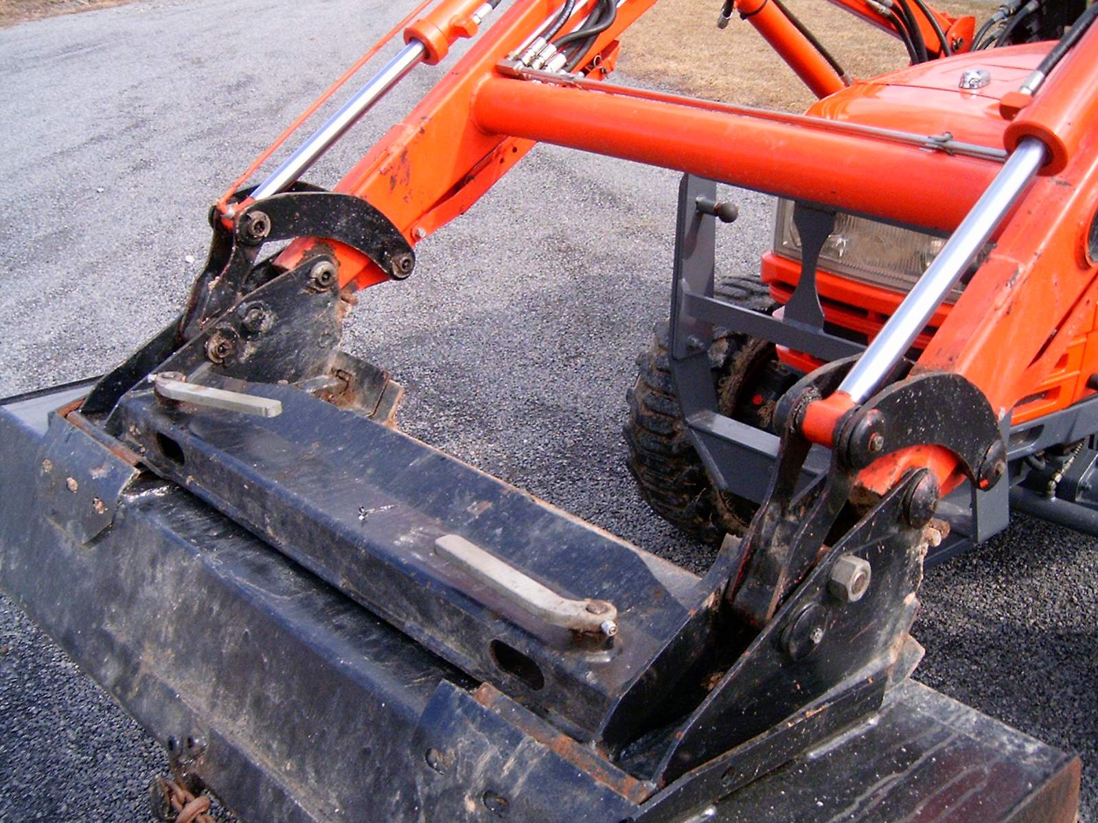

You might not want to reinforce that -- I think the torque tube on QA models is meant to be the weak link that gives before you destroy something else. Kind of like a fuse. Someone else can probably confirm.
/ Kubota L3800 Loader problems... twisted?? #11
I don't think it would hurt to reinforce.
My QA is heavy plate the whole way across (there is no torque tube).
I can take my bucket off and lift with a chain at full loader capacity in the center of my QA without damage.
Hard to tell here in this picture with my bucket on, but the only picture I could find

/ Kubota L3800 Loader problems... twisted?? #12
I found a better photo with the bucket off.
No bending this QA.
Plated the whole way across front and rear

Got the call from the machine shop today and picked up my part
they did a great job bending it back into square
slid the pins back in and fired up the tractor, hooked up the FEL bucket and it was as new
the guy at the shop decided not to beef up the torque tube, deciding that it was a weak link for a reason,, and if it needed to be a solid pipe, kubota would have made it that way at the factory

I am of the opinion that the torque tube is just to keep the QA shoes timed together, the implement (bucket, grapple, forks, whatever) should provide the structural rigidity to keep everything from twisting while is use. Some loaders and SSL's don't even have a torque tube or timing bar.
This problem happened because one side of his forks popped off, that issue needs to be addressed to prevent further damage, beefing up the tube is treating the symptom, not the disease IMHO.
