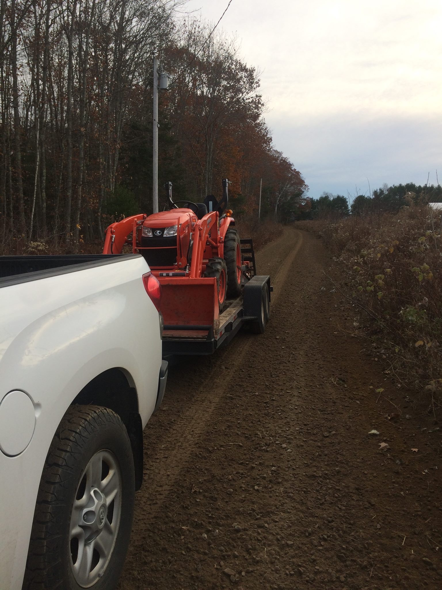

I tow my l3901 with FEL and box blade behind my 08 half ton Toyota Tundra. The 4.7 v8 has plenty of power and suspension to tow it. That said, I'm just about at the limit of my trailer and I wouldn't ever want to tow anything any heavier without a heavier rated trailer and some stronger rear leaf springs.

As Campbell mentions I also don't want to tow at near rated capacities. In mountain terrain I much prefer towing at 66% of capacity instead of 100%. The reason I bought the F550 is because of bigger brakes, 4.88 rear end gears, 33,000 gross combined weight rating. Most of the time the truck, trailer and payload (tractor and implements) is about 22,000 lbs. Truck and trailer are a split on weight at about 11,000 lbs. each. That helps when I have to park on a slope and get out to chock the wheels on the trailer. I don't need the trailer to drag the truck down a slope.
