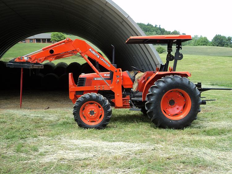

I knew it was top money but I gave 18K for this M4900 with 590 hr. Shed kept.

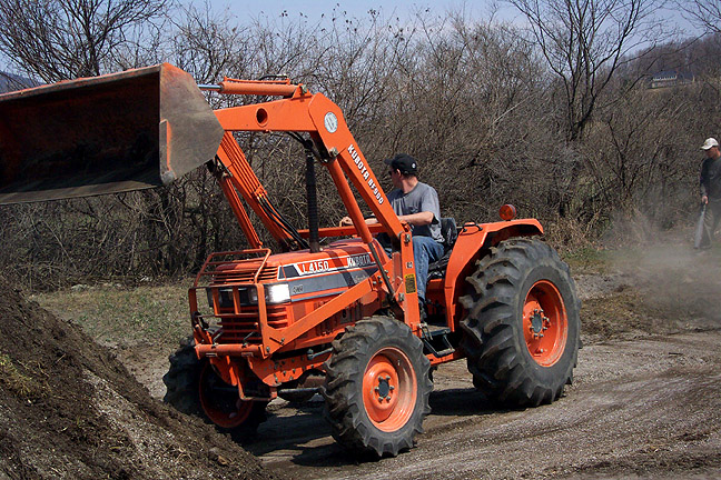

I'm a long-time L4150 fan, and the unofficial bragger-in-chief about all the models in the L4150 series (L3350, L3750. L4350, L4850. L5450).
A little history may be useful here. When the L4150 (L3 chassis) was introduced Kub was trying to penetrate the US market by offering more tractor for the money. They were heavy and strong and the hydraulic shuttle was a great feature. Farmers liked them, but the typical homeowner was looking for lower price. Kub responded by introducing the Grand L series based on a smaller lighter chassis, with "flat floor" operator station and more dashboard electronics. New M4700/M5400 utility models were added using the 5-cylinder engine from the L3 chassis, with no-frills prices and a shifter on top of the trans. Later versions renamed M4900/M5700 had a tweaked fuel system.
Actually the 2 machines are very similar in power and capability. If they have similar hours and condition, I'd pick the L4150. The build quality in those years is legendary. The BF900 loader should handle big bales with ease. The L4150 also has a 2-speed pto and the headlights are high enough to look over the loader driving at night. The thing I remember most about my L4150 was it never leaked a drop of oil anywhere. Pretty cool. Take care, Dick B.
