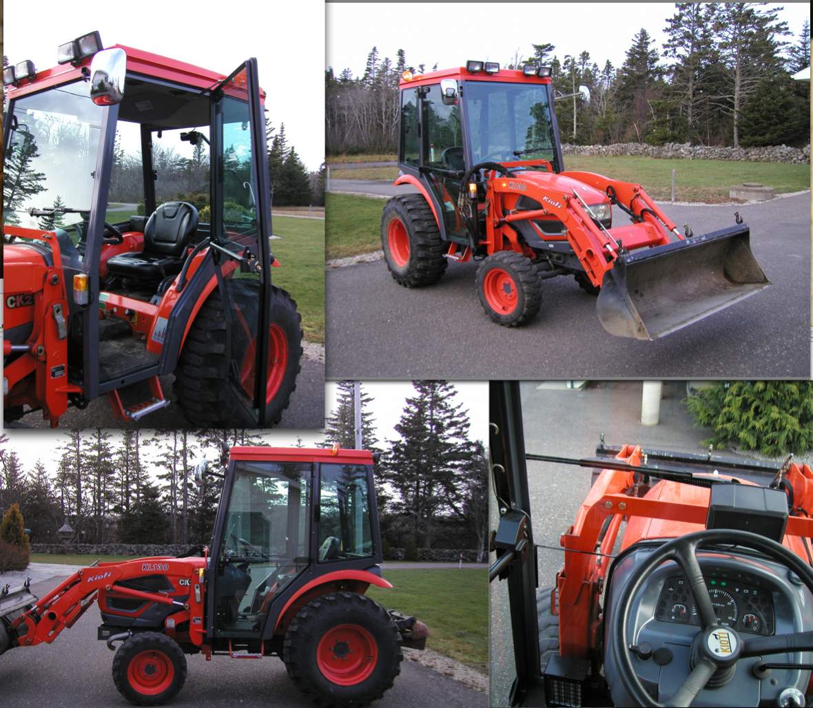

I just found your cab project today. Looks very good. I built one for my Kioti CK25 last fall. You will love being in it. Does your heater system take air from outside? This is quite important. If it does not your windows will fog up on the inside. Anyway, here is a couple pics of mine. Unfortunately I did not take any photos while building. You can search my other posts for more stuff.:)

That is one fine cab, would not have know it wasn't factory.

was wondering if you had build pics and deminsional drawings for your cab. I have the same tractor as you. Sure would appreciate some build direction.
Slowmandown,
As I stated earlier, I did not take photos while building. Taking dimensional drawings of everything would be difficult as everything is round on these tractors. Email me if you would like more photos and some measurements.

u built that? it looks factory! good job!

Deon, very nice cab, what are you using for a door latch/opener?

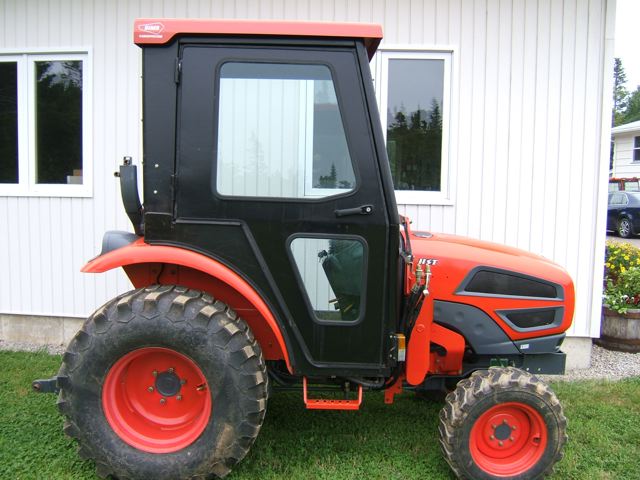

I purchased the tractor with a Sims cab. I didn't like it because it was all steel plate and very little glass plus it was fastened to the floor and jumped up and down all the time the tractor was moving. I saved the roof panel, heater, one wiper and the door latches. This is a photo of my tractor with the Sims.;)
