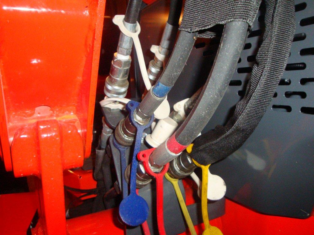

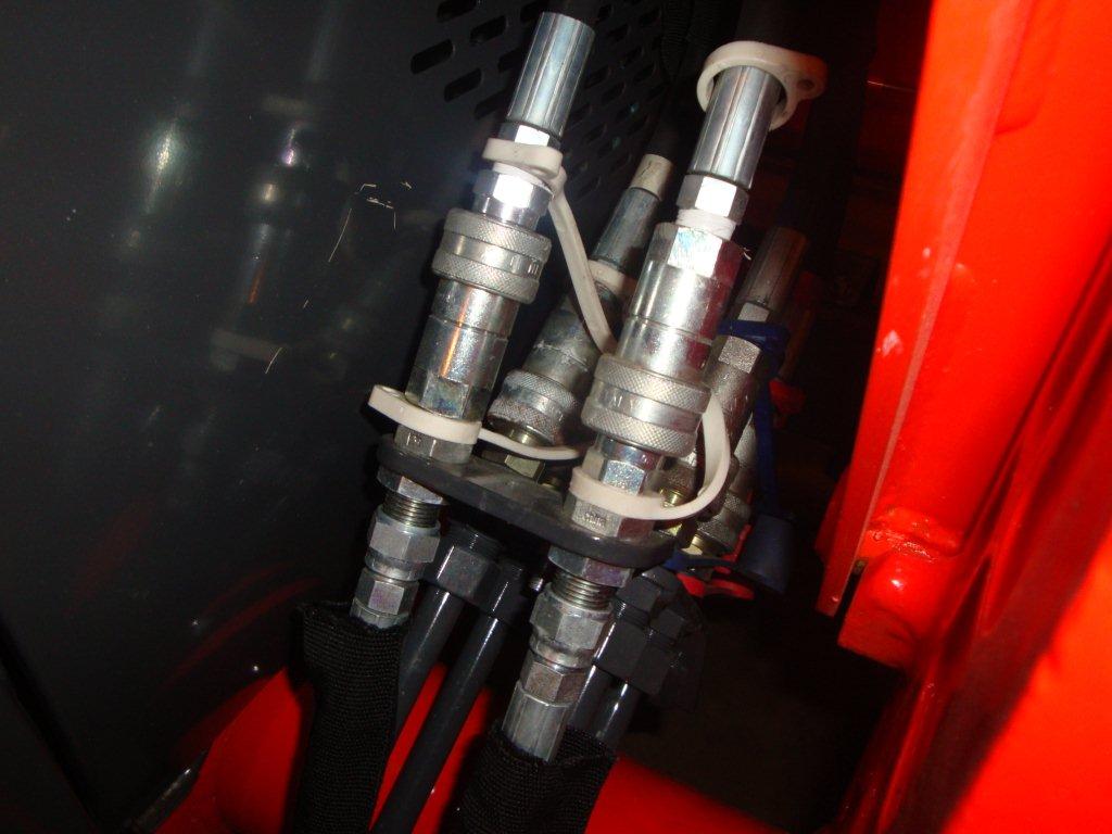

What's the white button on the lever? I thought someone had said it was a second valve. Is that box with the "no step" on the side of your tractor for the quick disconnects?
I think JimP answered but there is also another pair of disconnects over the FEL disconnects to allow loader removal. They are the top ones with the white dust caps.
