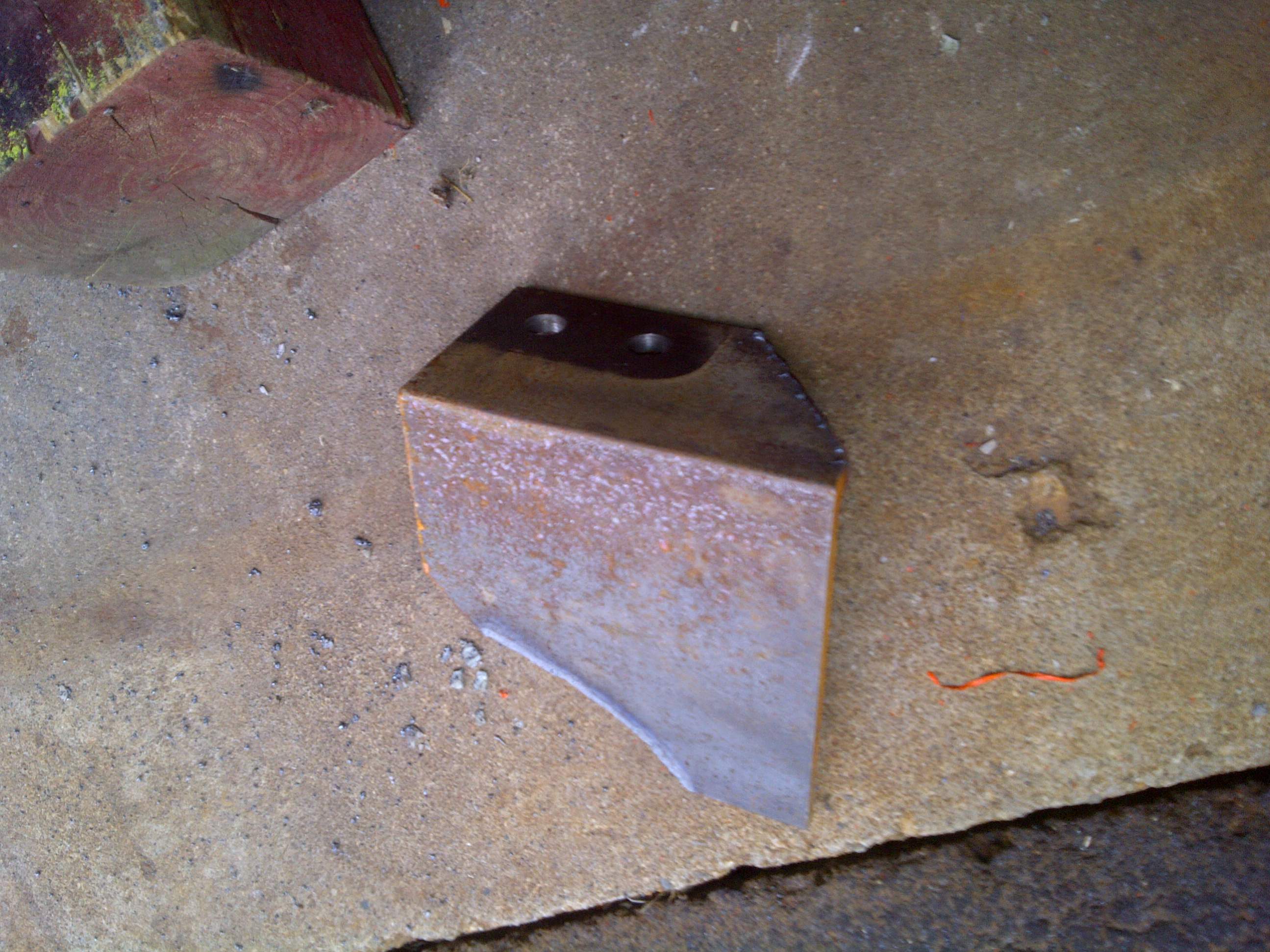

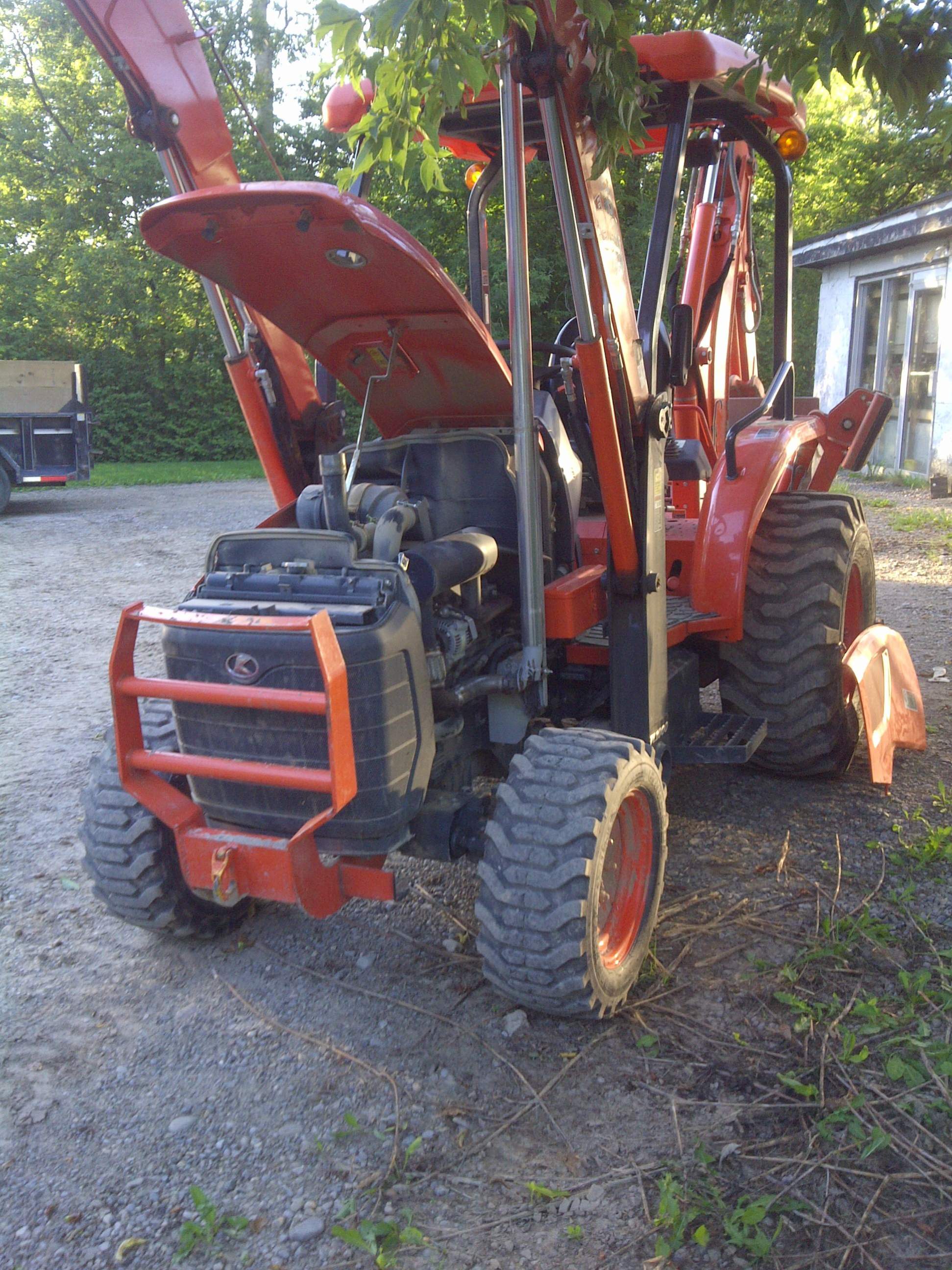

Kubota for some strange reason likes to advertise the fact that there is no exhaust stack on their tractors which "improves visibility". The don't tell you that it leads to operator's breathing exhaust fumes or that the downward discharge can kick up a lot of dust if you are working on dry ground like I have been most of this year. I see absolutely no advantage to not having an exhaust stack and having now added one to my Kubota L45 I can tell you there are many benefits not the least of which is completing a whole day of seat time without having breathed a significant amount of diesel exhaust.
I held of doing this for a couple of months because I have a Laurin cab sitting at the dealers waiting to be installed and I did not want to have the stack intefere with the cab installation. There is an excellent post on TBN from 4Shorts on how he added an exhaust stack to his Kubota and initially I had planned on using a similar approach on my L45 but then I decided that I had to keep my stack further forward to keep it out of the way of the cab installation and the Kubota toolbox mounted on the driver side loader attachment arm. So as you can see in the attached photos I decided to use a couple of bolts where Kubota has attached the heavy frame that sits under the L45. I removed two of the six bolts and then started with a piece of 3-1/2" x 6" angle to make the initial bracket. I then had a piece of 1-1/2" C-channel welded to the bracket to provide support for the exhaust stack. I then went to my local muffler shop and he cut off and fabricated the new exhaust routing under the hood and out from under the side skirt to the stack. Here are a few photos.
L45 Exhaust bracket attachment point 120728.jpgL45 Exhaust stack front view 120818.jpgL45 Exhaust bracket angle 120728.jpgL45 Exhaust bracket painted 120730.jpgL45 Exhaust bracket oblique 120804.jpgL45 Exhaust stack detail 120818.jpg
/ Kubota L45 Exhaust stack #2
Well that's quite the exhaust pipe! Nice! I guess it won't get in the way. I never really seemed to have an issue with breathing in the exhaust on my tractor.
/ Kubota L45 Exhaust stack #4
Nice job! I'm really a fan of the vertical exhausts, mainly because they look cool, but they do have a lot of benefits as well. For those that say a 3" pipe is blocking that much of their view, I tell them to get glasses. You don't even notice it's there during operation.

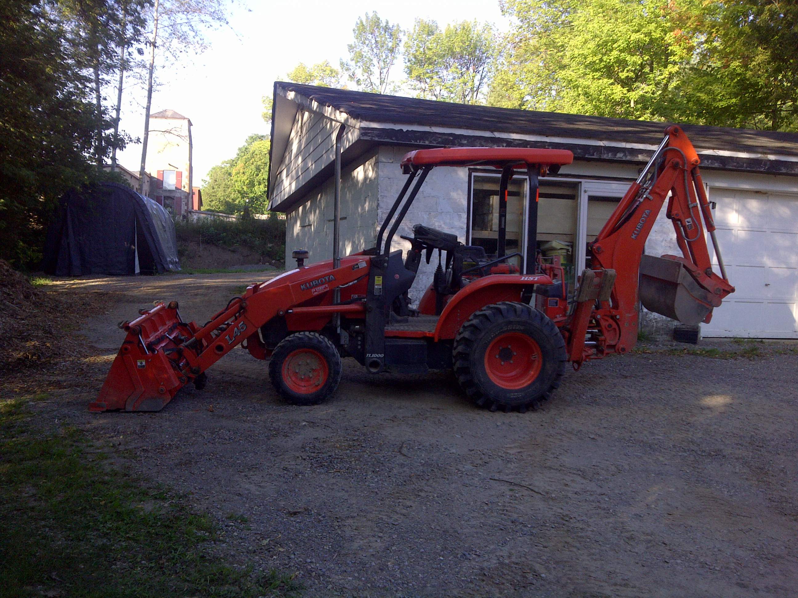

Thanks for the comments guys. The stack is actually only 2" diameter Martian and I don't even notice it when operating the L45. All I notice is the nice, clean, fresh country air. It may not be clear from the photos but the straight stack portion just slips over the piece that is attached to the muffler. I just have a stainless steel gear clamp at the top of my support bracket to hold the stack in place. I had them leave it like this so I can just loosen the hose clamp and rotate the pipe to direct the discharge in any direction I want.
Driving around normally I could live with the exhaust discharging by the front tire but this year it has been so dry that every time I stepped on the HST pedal with the auto throttle on the L45 it would send up a cloud of dust. The low exhaust is also a problem when you are working the machine around a trench or other excavation that has other workers in it. If they are down 3 or 4 feet when you drive by they get the exhaust and/or dust blown in their faces too. The worst problem I have encounter with the low exhaust is if you are excavating along a building which is what I do when fixing leaky basements. I would always try and orient the machine so that the exhaust is blowing away from the building but there are times when you just can't do that with a TLB. Believe me if you are sitting on an open station working backhoe controls for several hours with the exhaust blowing against the building you will be breathing diesel fumes all day. I don't mind a wiff of diesel but all day is too much for me.
I think they made the stack a little too long as it is about 6" higher than the roof so it looks long but for now I am leaving it since it is a good reminder if I am in a low overhead area that the backhoe on the L45 sits about 8" higher than the roof. The top of the backhoe was not higher than the roof of my B21 or my B26 so on those machines if the roof fit than I was good to go. That is not the case with the L45 but fortunately the roof of the L45 is high enough that I can't even try and get it in my garage so I haven't done any damage yet. One of my fall projects was to increase the height of my garage door so I can get the L45 inside for the winter but that project may have to wait until next year as I am so busy with other things right now. They have offered to shorten the pipe but I am going to wait until I get my Laurin cab installed to make a final decision on stack height.
Nice to hear from you Paul. I considered the drain hole but as you can see in this photo the top of my stack has a nice kick off to the side and my machine will be inside soon so I think is will be alright. I spent most of yesterday on the L45 again just beathing fresh, clean country air!
I'm going to call the dealer on Tuesday as there has been a little chill in the morning a couple of days this past week so I am going to see if I can't schedule the Laurin cab and rear remote installation for the week of Sept. 10. Then I'll have to go through a few of your old posts Paul and figure out how many accessories I need to put in the cab!
