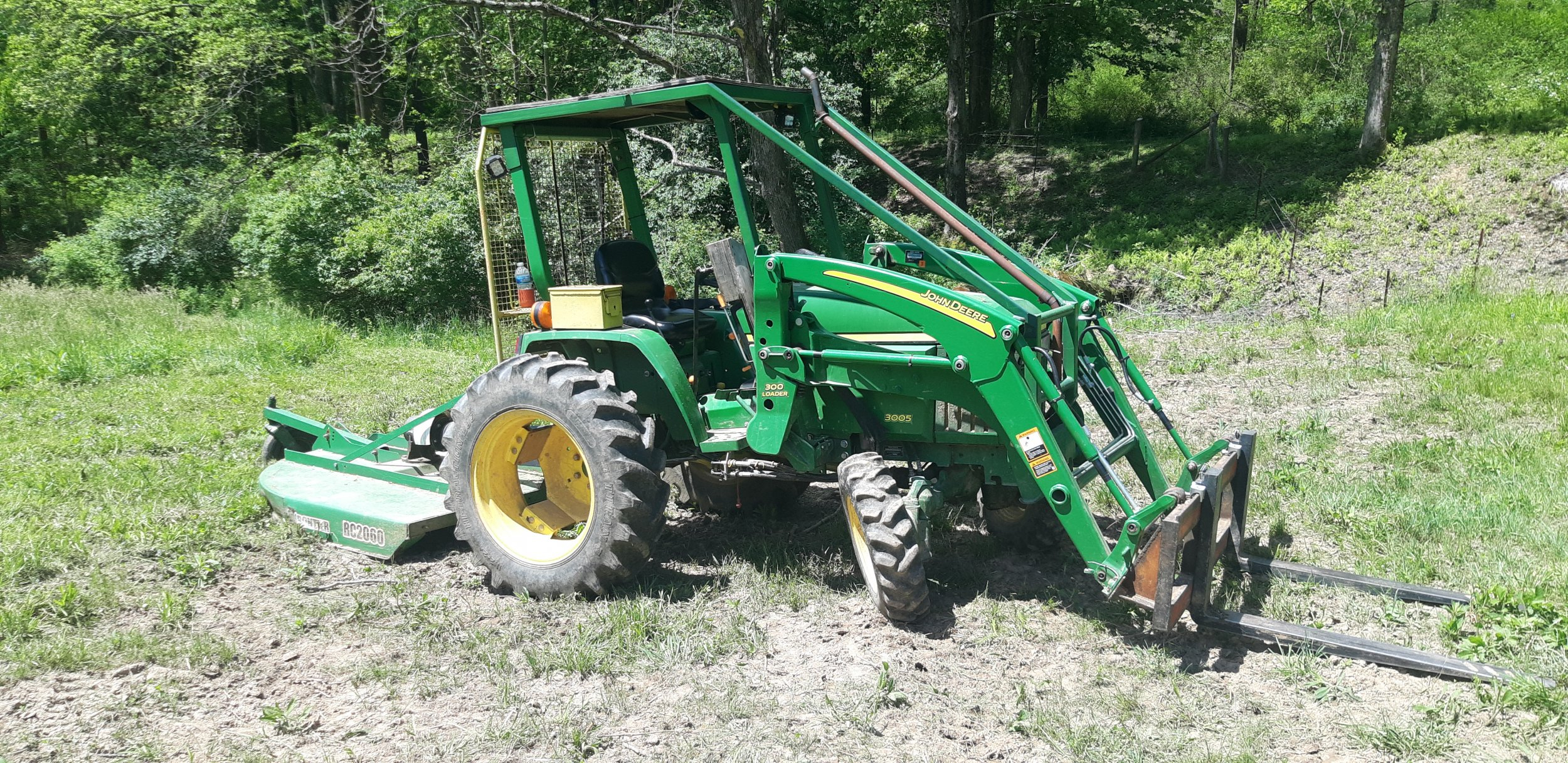

My lil' ol' 3005 had the bucket-blackening lower-front exhaust exit... after I built a roll cage with limb risers, I ran the exhaust pipe up one of the limb risers to exit over the top of the roof panel. Safe from tree branch damage, no fumes in my face. Can't find a good picture to share at the moment... it is somewhat visible here, running up the left side riser.
Saw it instantly. Actually, I saw it before reading your commentary as I was suspecting you had done something like that. Well done!

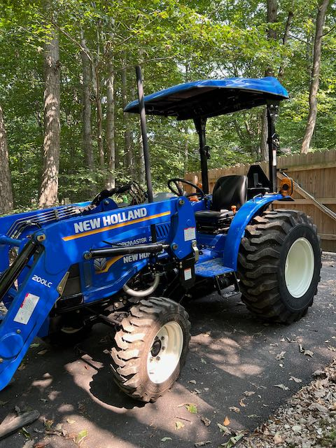

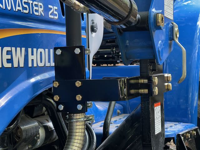

My old Kubota had vertical exhaust that came off the exhaust manifold, passed through the side of the engine housing, and curved upward. There was a little panel in the side of the engine housing between the exhaust and its top edge, held on with two bolts, to allow removing that side of the engine housing. It worked, but obviously was a little more trouble, both to manufacture and to service the side of the engine. On that machine, the hood was hinged at the front, and was above the engine without covering its sides; the sides of the housing covered the sides of the engine and were independently removable which I did from time to time.
The new tractor hood covers the sides of the engine as well as the top, and hinges just in front of the instrument panel. On this conversion, I cut off the exhaust pipe at a location where it's running straight downward, hidden by the hood. Since the flex tubing makes a U turn below the bottom edge of the hood, it doesn't interfere with the hood at all.
I also like that there's a trap there, like a sink trap. If somehow it did get several inches of rain, it would fill up this U turn for a long time, then the horizontal muffler under the hood, before it got into the engine. I always disliked the old Kubota exhaust design that would funnel rain water into the exhaust manifold eventually. I bought it used, and it always looked like it was rode hard and put away wet. The first time we started it in the dealer's back lot where it was stored, a bit of water flew out of the exhaust.

My lil' ol' 3005 had the bucket-blackening lower-front exhaust exit... after I built a roll cage with limb risers, I ran the exhaust pipe up one of the limb risers to exit over the top of the roof panel. Safe from tree branch damage, no fumes in my face. Can't find a good picture to share at the moment... it is somewhat visible here, running up the left side riser. View attachment 763060
This is what I should do. Since I stole a lot of your roll cage ideas I might as well take your exhaust ideas too. Thanks.
How do you get the hood open?
