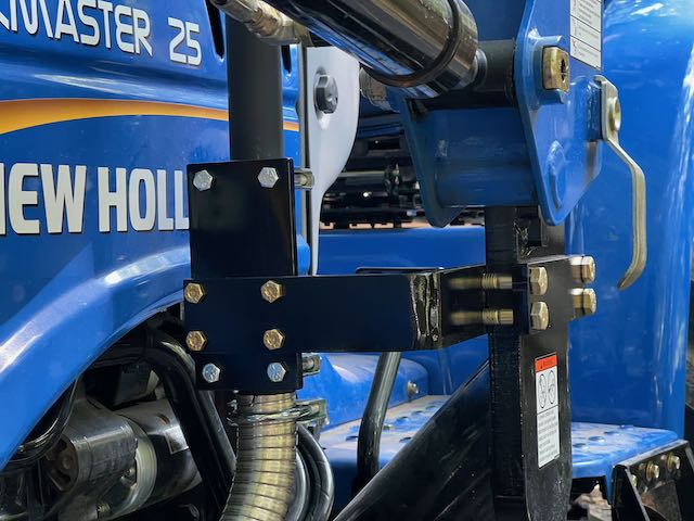

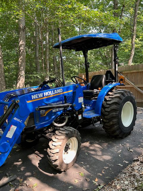

When I got my new New Holland WM25, most things were way better than the old used Kubota B6200. But one thing that wasn't was the exhaust, which was low and forward so I'm often driving through my smoke. I don't get why this is supposed to be ok -- and anyhow I have chronic bronchitis and can't tolerate it well.
So I finally finished the modification pictured here. I chopped the existing exhaust pipe about a foot or so after the muffler, mounted a vertical exhaust pipe, and joined these together with a length of flexible exhaust pipe. The mount parts are 1/2" by 2", and 3/8" by 3", mild steel from McMaster. I did get a shop to do the weld, but the cutting and drilling I did at home. The assembly clamps onto the very solid upright of my FEL mount, very firmly (I used four 1/2" Grade 8 bolts torqued to spec). I didn't cut or drill anything on the tractor, other than shortening the existing exhaust pipe. Loader and hood operate normally.

Looks good. I think they use the down towards the front exhaust for couple maybe three reasons: cleaner view of front-end loader, clearance for those who need to fold roll over bar say for shed and really just height clearance such as for shed. So will stick with a couple of reason

This pipe is going to hit a low branch first, but it's not quite as high as the canopy. I can see the top of the pipe while operating. In fact, I might put a wire on the top, like a curb feeler, to test whether the canopy will fit.
I hope that the pipe, which is ordinary Walker brand exhaust tubing, will bend before it damages anything else. It should buckle at the top of the bracket. It's easy to replace the pipe, and I have a spare one which is a little dinged up from the mocked-up version I put together first to test it all out.

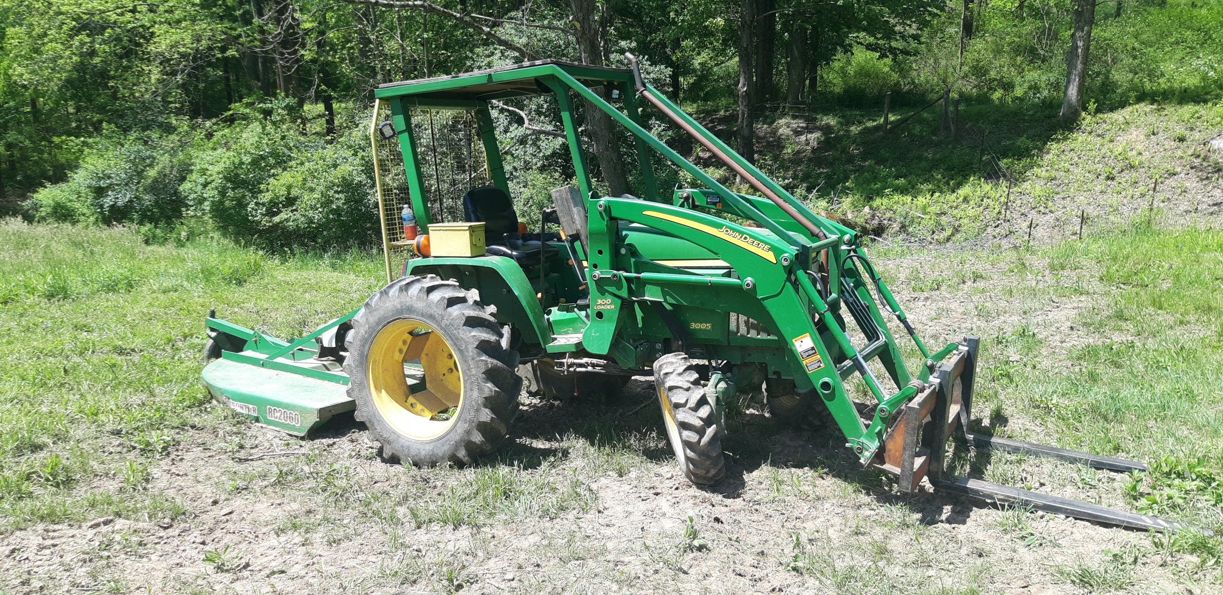

My lil' ol' 3005 had the bucket-blackening lower-front exhaust exit... after I built a roll cage with limb risers, I ran the exhaust pipe up one of the limb risers to exit over the top of the roof panel. Safe from tree branch damage, no fumes in my face. Can't find a good picture to share at the moment... it is somewhat visible here, running up the left side riser.

The new tractor hood covers the sides of the engine as well as the top, and hinges just in front of the instrument panel. On this conversion, I cut off the exhaust pipe at a location where it's running straight downward, hidden by the hood. Since the flex tubing makes a U turn below the bottom edge of the hood, it doesn't interfere with the hood at all.
I also like that there's a trap there, like a sink trap. If somehow it did get several inches of rain, it would fill up this U turn for a long time, then the horizontal muffler under the hood, before it got into the engine. I always disliked the old Kubota exhaust design that would funnel rain water into the exhaust manifold eventually. I bought it used, and it always looked like it was rode hard and put away wet. The first time we started it in the dealer's back lot where it was stored, a bit of water flew out of the exhaust.

My lil' ol' 3005 had the bucket-blackening lower-front exhaust exit... after I built a roll cage with limb risers, I ran the exhaust pipe up one of the limb risers to exit over the top of the roof panel. Safe from tree branch damage, no fumes in my face. Can't find a good picture to share at the moment... it is somewhat visible here, running up the left side riser. View attachment 763060
This is what I should do. Since I stole a lot of your roll cage ideas I might as well take your exhaust ideas too. Thanks.
