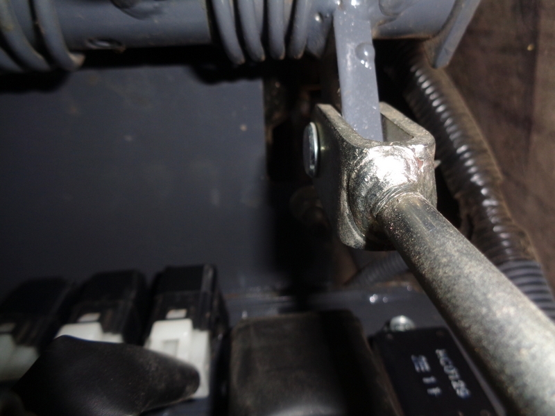

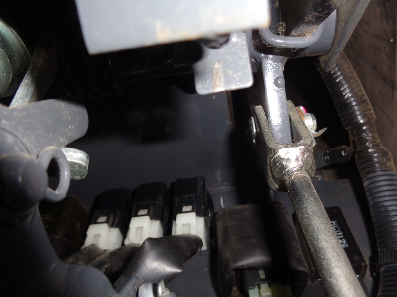

I made a mention of sticky relay before. What you said about it not doing anything and then clicking corroborate that condition. I don't have access for WSM for L4600 but on mine there are 6 relays in all. one is OPC (Operator Presence Control)timer that basically watches seat switch, one for flasher unit and one for glow plug. I will post a pic below here that shows where there are located behind the metal cowling where the start switch is. There are 3 more smaller relays to complete circuit for neutral safeties both for PTO and shuttle shift. On mine all safeties are doubled up perhaps for more reliability but in your there is one in each circuit. On my WSM even the 3 little relays are not clearly identified and they bunch them as one group. I bet one of them is acting up and sticking. Again, anytime you put the key in start position (not crank) then battery and engine light should illuminate.
See if you can find those relays.
The relays are behind the brake manual release.

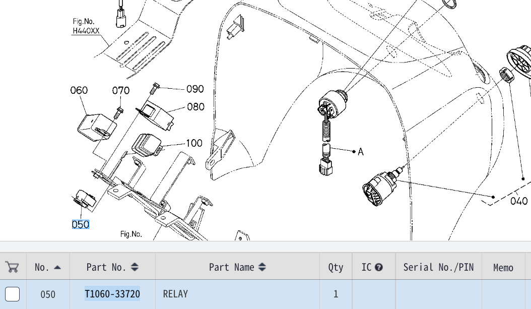

Would this be the relay you are referring to or #80 the controller? #60 is flasher unit and #100 is glow relay. I wouldn't think it would be the glow relay since he only uses it in the winter. I just searched the relay and the controller and I can get the relay for $21 on Amazon, the controller is listed on some sites as the OPC and it's $250.

Obviously I cannot confirm with 100% certainty. I Went to amazon and it is the $20 for that 4 pin relay. It is a heck of lot cheaper than Kubota OEM. You do not want the OPC, Glow plug or flasher unit. For MX-4700 there is a bank of 3 relays. Now that relay can be bench tested, if you have just one then $20 is not a bad try.

That does not make sense. OPC and Neutral safeties have two separate paths but interlinked. Some relays , I believe is latching but can't unlatch quickly. The OPC has a timer module also. I am wondering if that causes it. Anyway $20 is not bad ivestment for that relay. You can check the old relay against the new one. At least you will have a spare relay for future if your existing is good.
