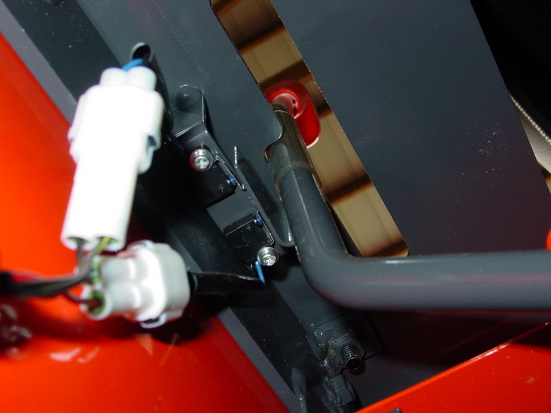

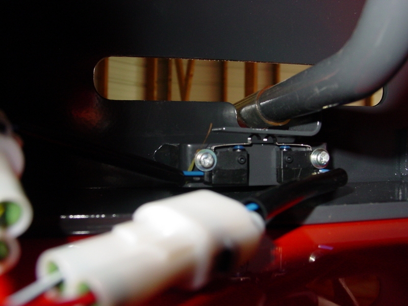

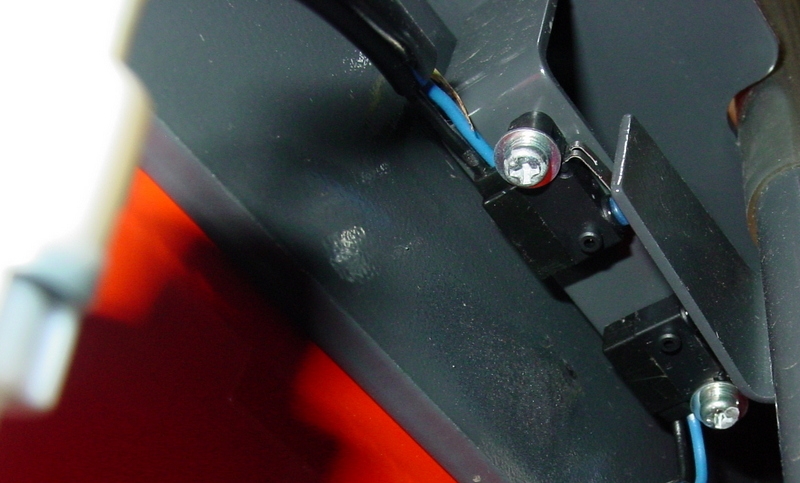

Tammy,
I went and checked the picture library that I have for my Mx-4700. The shuttle neutral switch is not just one switch. They are two switches one for forward and one for reverse. In the neutral position (handle in the notch the switch must be closed. I have couple of picture for your benefit. The strand of wire you see is just a blade of grass.

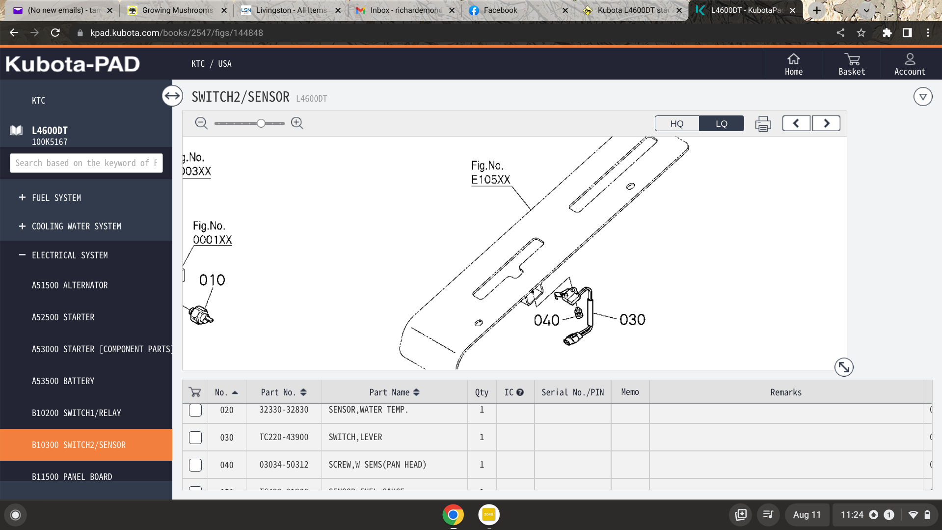

Ours only has one.

very interesting, at least one less sensor to fail. On my Ford 1700 i have only one as I don't have shuttle shift on it. I never needed to do a deep dive on my Kubota as I had just about zero issues in the last 11 years. My tractor has always been parked in the barn as well. I was at the dealer for about 8 hrs that day when they un-crated t and put it together.
make sure the shuttle lever fully engages the rocker arm thing on the switch and connecting two poles of the switch should turn on the test light and and when you push the rocker arm it should turn off. I did go to Kubota site and verified the info as you did.
