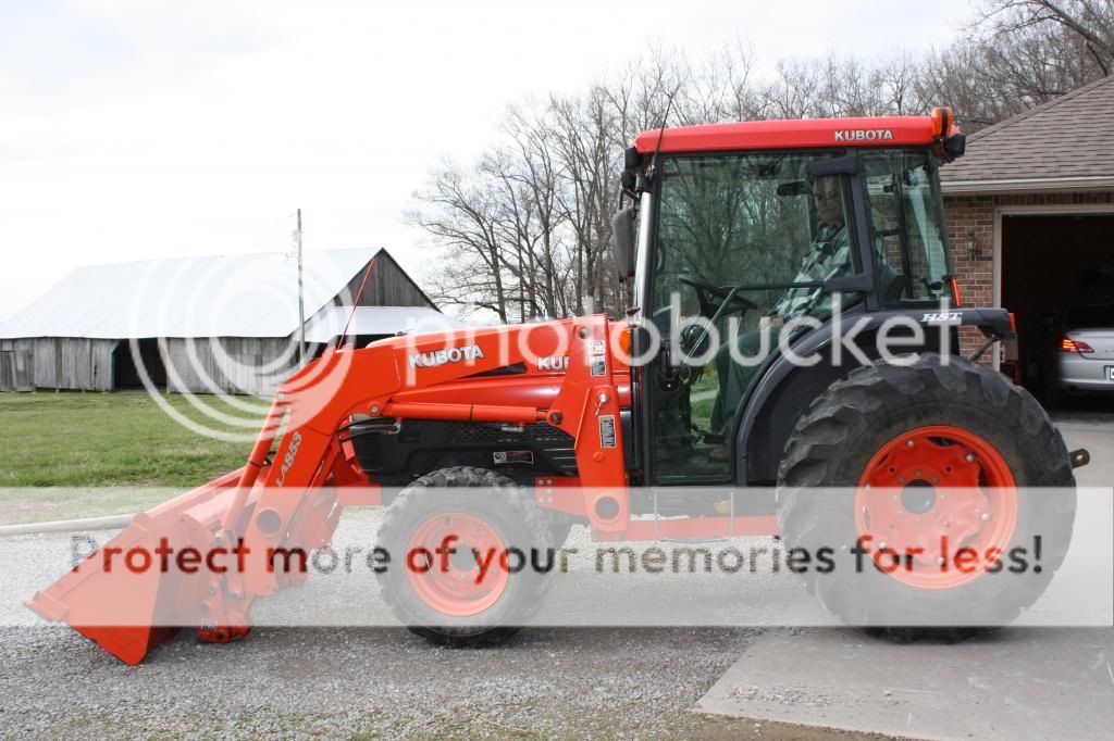

Beautiful tractor. I am sure you will be very happy with it. On the SSQA hydraulic driven snowblower, you will need to find out how much flow in gallons per minute you will need to run it. You might not have enough flow using the tractor hydraulics. Some of those require an external PTO driven pump/reservoir to drive them. Remember most skid steers can supply 20-25 gallons per minute. But most tractors that size cannot. Again congratulations on your new machine.

I am wondering if I can put the rear wiper in or is it a waste of time and money also I can buy a ssqa front blower from a skid steer which I believe is hydraulic driven what would I need xtra to run the blower guy is asking 2700 do I need front remotes
I don't believe you will be able to run a hydraulic powered snow blower(not enough flow),they do make Rear Pto powered front blowers,not cheap.
I have a third function that powers my thumb,snow plow angle and tree shear.About $800 from Kubota.
