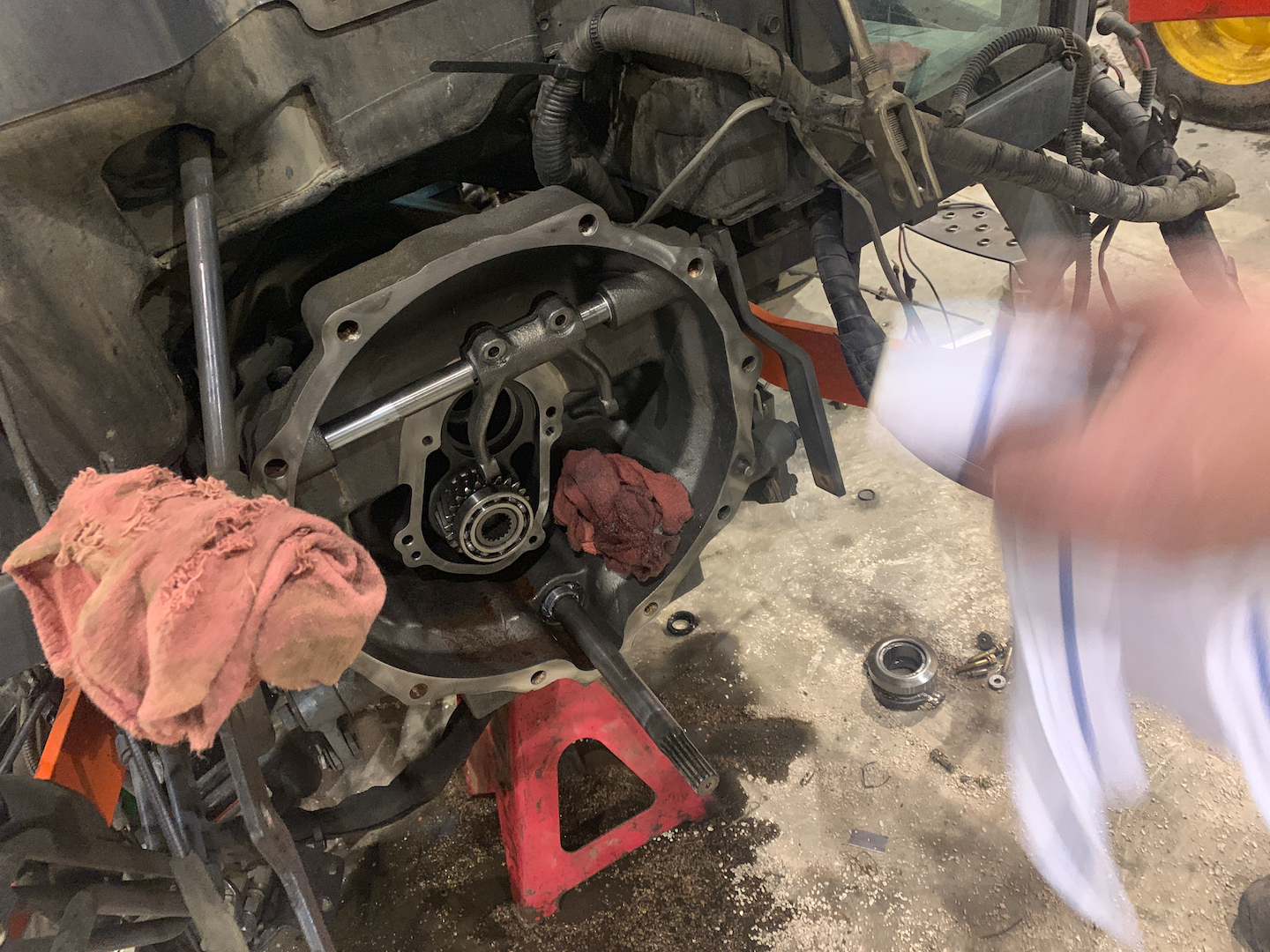

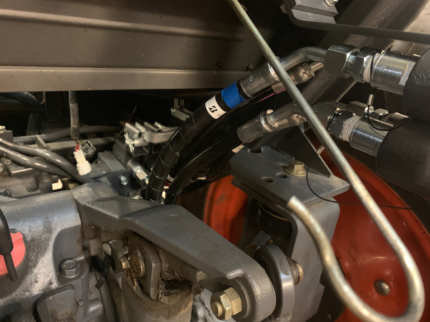

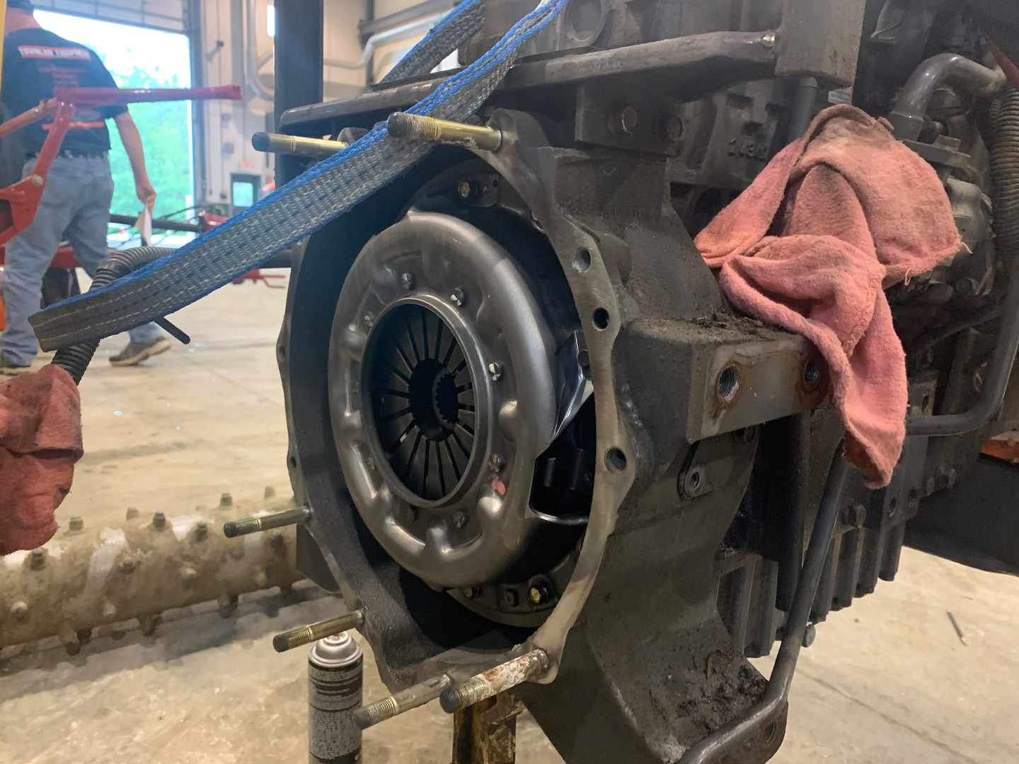

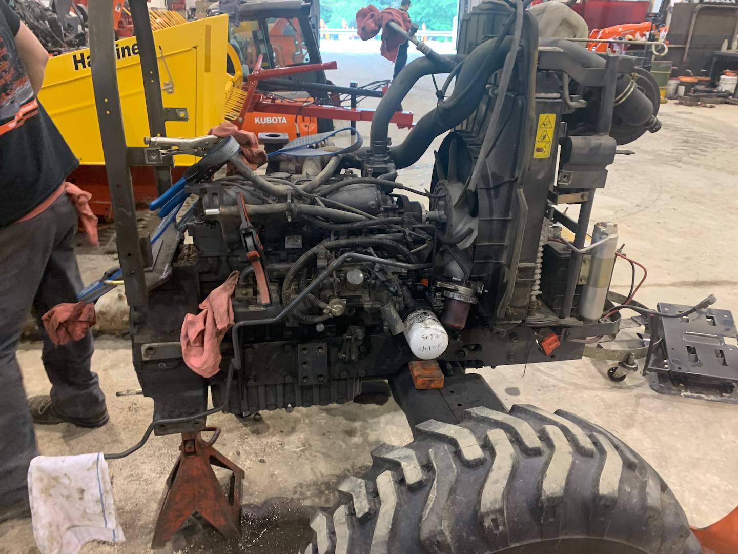

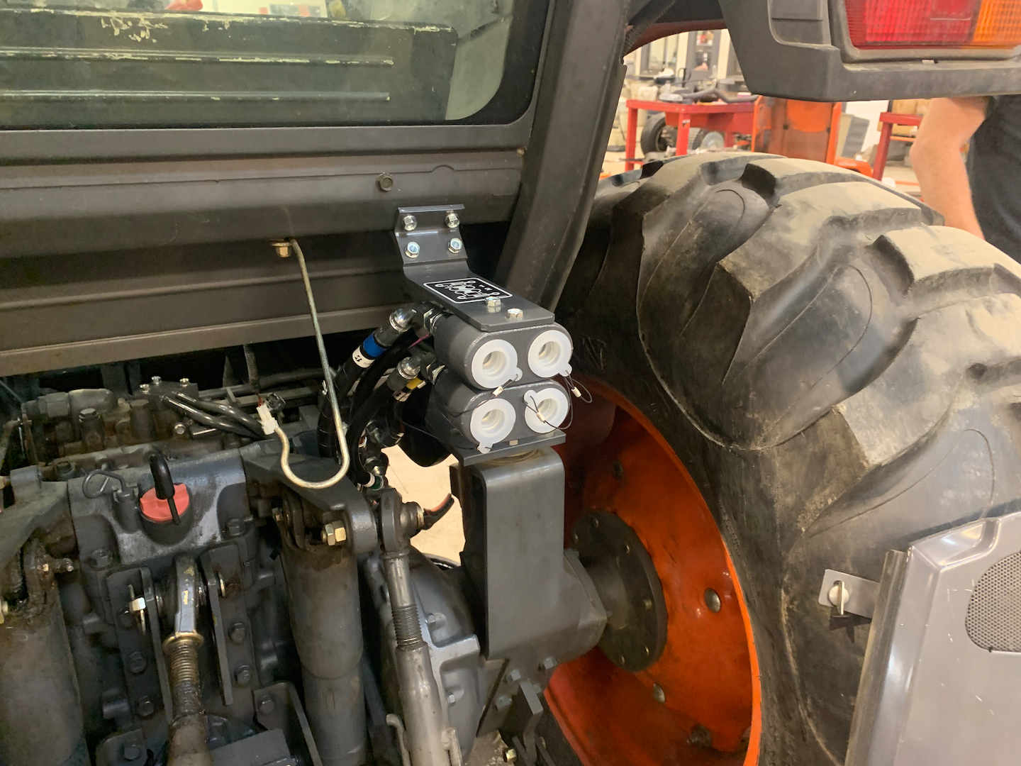

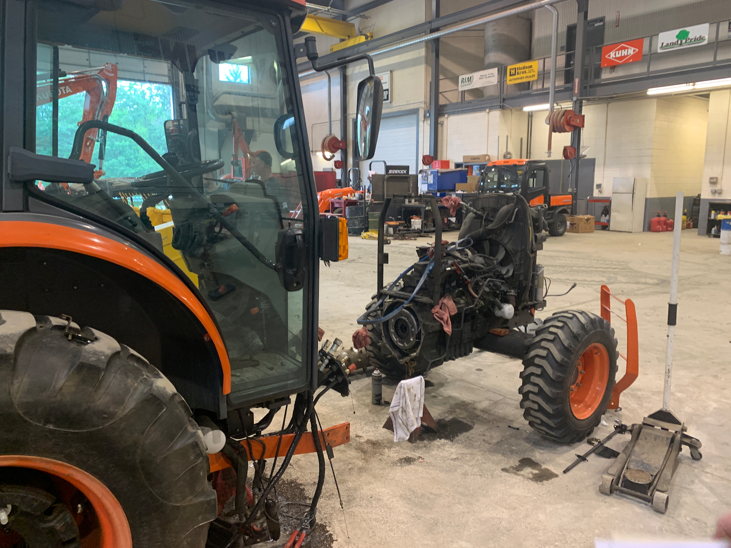

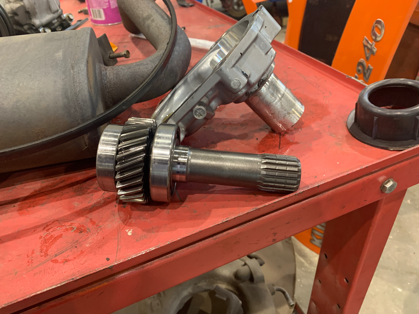

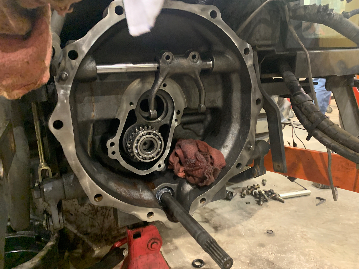

Nothing like walking in on open heart surgery. My leak got to about a gallon every 10 hours of operation so I bit the bullet and am having it done. I've always wanted to see what a split tractor looked like, so went to the dealer to look. Glad I didn't try it myself. They actually found two seals that were bad...plus some worn parts. I'm going to need to be sitting down when I get the bill, for sure. It's the first serious expense I've had with the machine, so I'm not too disappointed. Glad I didn't try to do this myself.

I got my machine back and it's perfect! No more leak, and the remotes are a home run. As for Townline, I'd have to agree that the service was really stellar. I had it there Sunday night, and by 5 pm Monday they had it completely apart, and ordered a part or two they didn't have. Out of curiosity I priced the most expensive part (the stupid air conditioning hose that runs the length of the tractor, and had nothing to do with the original problem) on Messicks. With shipping it would have been around $700. They charged about 15% more, which does seem like a lot, but for parts you can't install yourself, I'm good with it. The thing about paying for good service is that the price bothers you only while you're paying the bill; Having a properly maintained machine, serviced by people who know what they're doing, is really worth it in the long haul, in my opinion. Just wish they weren't so far away; hauling alone was $400.
It still bugs me that a failure of a part such as a seal or O-ring can lead to such an expense to replace, but I guess that's the price of owning machinery.

Uh Oh. A couple days after I got the machine back, it's like the power steering went kaput. Read the manual, and it advised bleeding the system by turning the wheel lock to lock, shut the machine off and then on again. That seemed to work, but a couple days later, the same thing happened. I'll call the dealer on Monday, but any thoughts on what might be causing this? The last time it happened, at the very same time the steering was heavy, I pushed on the foot accelerator and got almost nothing. Then after a couple seconds, the machine took off and the steering worked. Like it had no fluid or something. But it's full of course. Stumped.
   / Kubota L5240 Hydraulic leak...need help please #18
Sounds like there is some air trapped in the lines or a small leak allowing air to enter under certain circumstances. Check the fluid levels and fittings for the power steering.
Mike
   / Kubota L5240 Hydraulic leak...need help please #19
On the right side where the hood ends at the dash panel. There is a rubber hose and it had to be removed to split the tractor. Check the clamps and cracks in the hose, You must be sucking air into the system, that hose is known to crack.
#20
Would one expect this hose to affect both the steering system and hydrostatic drive? Trying to figure out if it's my imagination, but I thought that when the steering became hard, and I stepped on the throttle, the tractor either didn't move forward, or moved forward slowly. Then all of a sudden, when the power steering started working, the tractor took off. Finally, after starting up, and warming up, lifting the FEL off the ground, I seem to feel a "chug-chug-chug" kind of jerkiness.
The dealer said the hydraulic pump and steering pump are two completely different systems, but if this hose is common to both, it might be the culprit; they're coming tomorrow to take a look.
