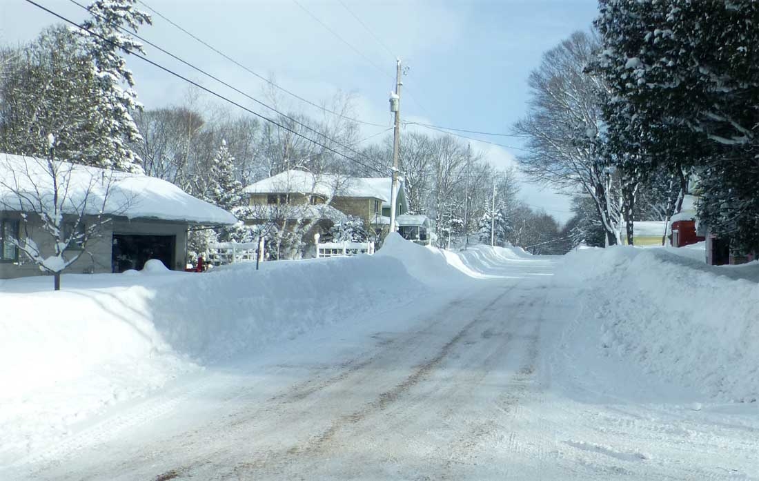

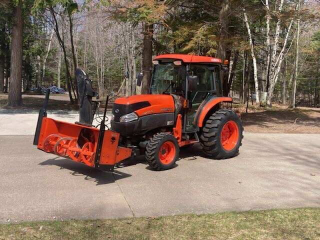

Snow is big business here. We'd need to get a truck with a plow for light days, then blow on heavy or to get the sides that are built up removed. We have seen 48" in 48 hours.

Why does he need the ati QA? The Kubota factory one on it should work just fine.
My mistake - I read it didn't have SSQA - but after looking at the other pictures it does, All he needs is the 3rd Function and the rear remotes. A lot simpler and less $.

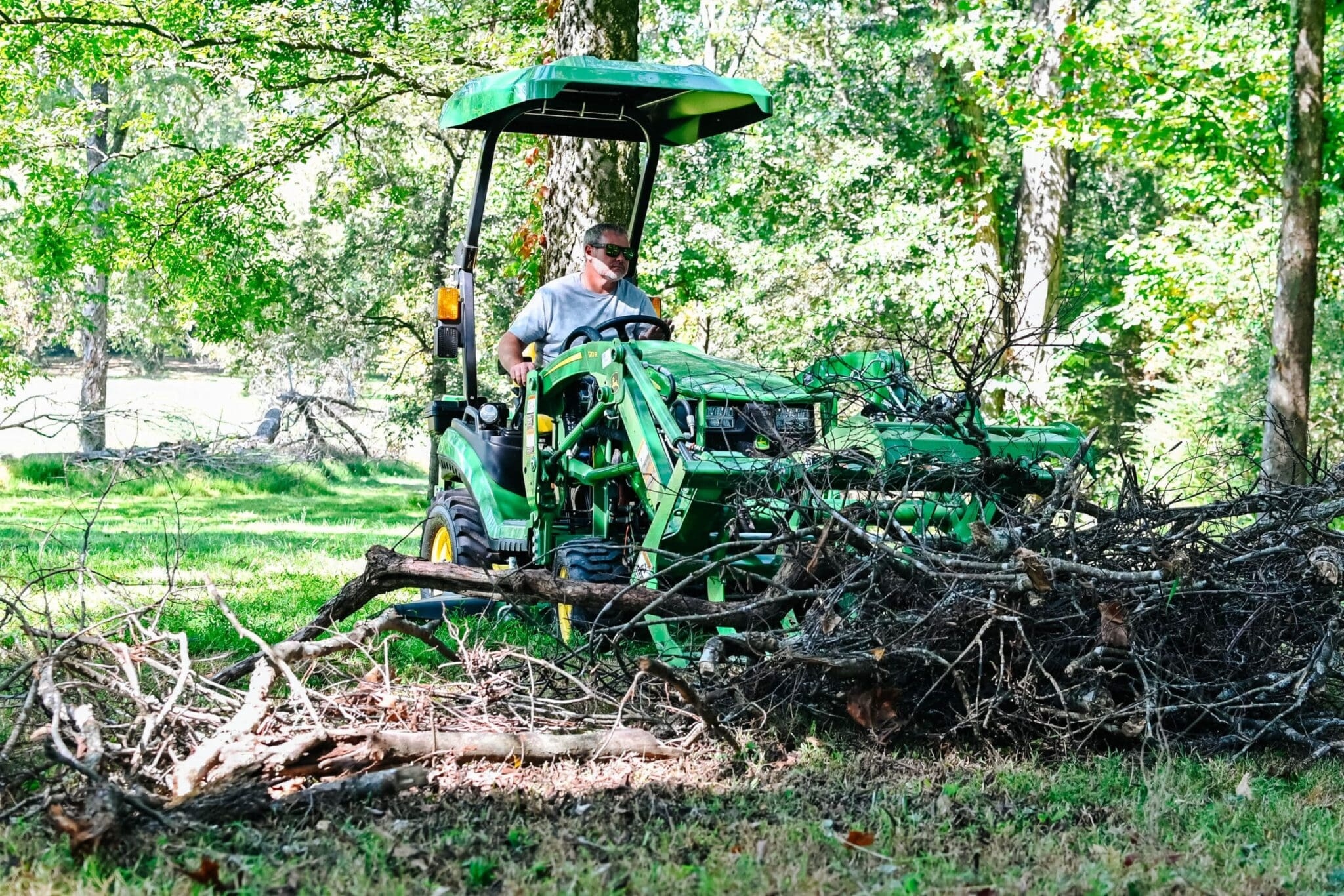

I wish I had a grapple but get by with my forks. You can try and get by with the forks and add a grapple later. They are pricey is why I bring it up, if you have it in your budget I’d get it now then.

If you've got the money to make it work, get the remotes and 3rd function. You'll never regret a dedicated grapple.

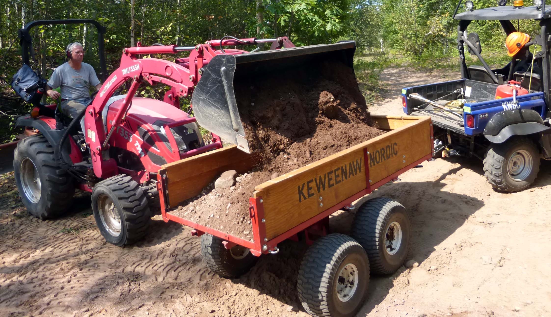

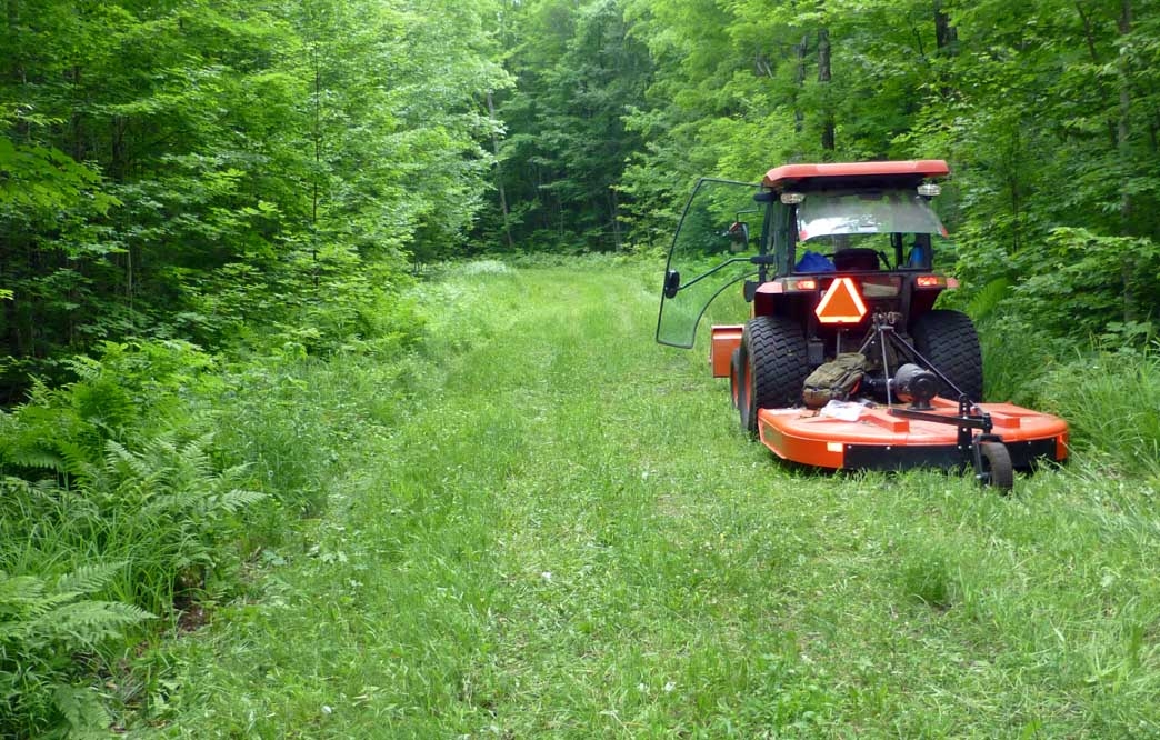

We have been clearing trails for many, many years but at the point, I have a wrist that no longer likes doing that. We have to switch to a tractor but we have used them on trails in the past. The rear hydraulics would be for a 3 point mower, or back blade. Front is for a grapple.

OK. Then add at least 2 sets of remotes on the rear. Way easier to add them at the same time than come back later and take everything apart to add another single.
If you can adjust top links and side link manually, you probably don't need any more than two. If you think you're going to want more, go for all three. I don't use anything behind that tractor that needs more than 2 remotes. Usually only need one.
