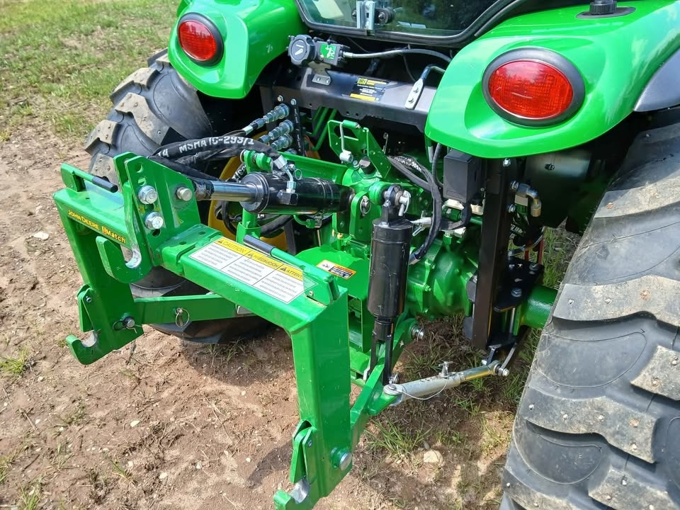

So if we get this tractor, it needs a grapple and the hydraulic lines to the front added to operated it. Plus have the front axle grease changed and those suspect bearings tested. With only one hydraulic circuit to the rear, does another need to be added? Also watching for a 4 series JD but many of those don't have a belly pto added.
It depends on what you want to do with rear hydraulics, but one set is pretty limiting. Most people at least want to have hydraulic top link and hitch tilt.

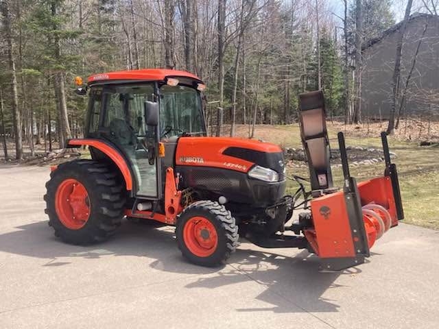

I’ve never had top-and-tilt or a quick-hitch. Guess I’m old fashioned and backward. But if you plan to switch to a rear snowblower, you’ll want at least one rear remote for chute rotation.
As jyoutz said above, it depends on what you plan to do with it. Define that and you can determine minimum needs and options.

Would you do a 1/2 of a mile drive looking backwards? 😆
Well, I plow mainly. Only reverse when drifts are too deep. Much faster to plow.
And I can kinda get sideways in the seat and use my left foot on the hydro. Coffee cup is right there on the right. You’ll really like your warm cab come snow time.
