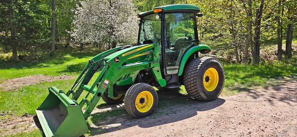

Used tractors are showing up near us and a JD4320 just did priced at 18K.
2010 JOHN DEERE 4320 45 hp deere diesel HYDROSTATIC TRANSMISSION 4wd factory cab heat air conditioning work lights wipers mirrors 1 set rear hydraulic s mid pto 400x loader 73 inch QTACH BUCKET.
I asked the owner and it has 3700 hours.
