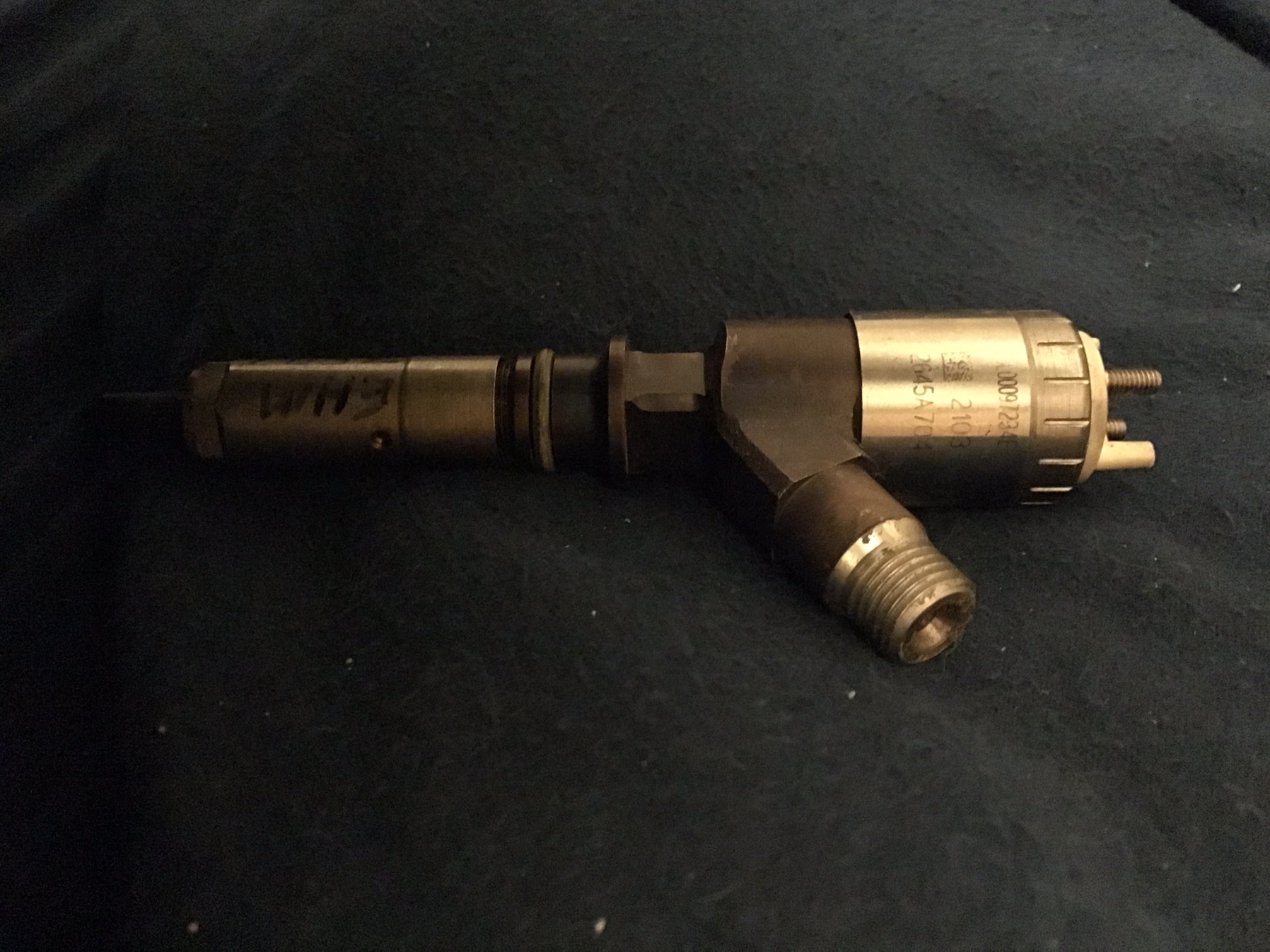

Here is a CRI injector I have lying around. Not Kubota. Important thing is the serial number at the top. There is a trim file with the injector. That is all that is serviceable. Replace the injector, load the trim file into the engine ECU, and that’s it. For this injector the engine will periodically go into its own diagnostic mode and fine tune the engine ECM based on what the sensors are feeding back. The trim file at the start is based on that injector at the time it was built. The engine fine tunes it in operation.
It’s not unlike other consumer products. I lost a hearing aid, covered by insurance. I have the replacement but the trim file is at my audiologist 240 miles away. She cannot send me the file to upload using Bluetooth. I need to drive to her office and have her upload by Bluetooth. She needs her piece of the action. Fortunately some things can be done by the user. When I quit using my computer tonight it informed me to make sure it was plugged in to a power supply. Tonight it is updating the bios, then updating to the latest Windows version. Tomorrow I find out if it went well but at least no dealer involved.
