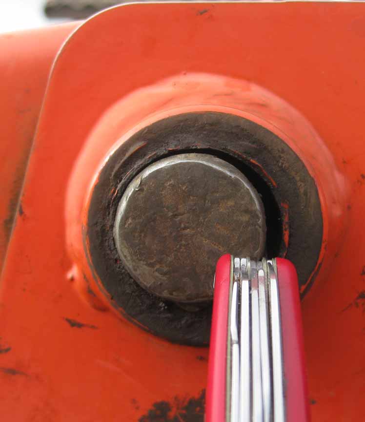

Still haven't tackled the worn out bushings, but Enco has a sale this week and I'm about to pull the trigger on a pair of adjustable hand reamers that look like they'll do the job. I think the bushings are the cause of the play:
That's a pocket knife with the blade stuck into the gap between the pin and bushing bore. Nominal diameter of the pin is 1.125"; I measured 1.271" across the largest ID of the bushing. That's 0.150" of material to take out with the hand reamer and it seems like a lot:shocked:. The part shown could be mounted on a mill table and bored close, then reamed, which is probably what I'll end up doing. With that part in hand, though, I could also cut off the bosses and weld new ones on, then drill and ream to original 1.125" size. Still haven't taken the assembly apart to measure the bore in the boom arm of the loader, and as I mentioned in my first post, the loader arms are joined and it would be a real trick to horse them onto the milling table.

Could you drill out the bosses, to say 1.375", and then insert new bushings with the correct ID? I suppose fixing them so the grease passages stayed lined up might be tricky. And, I gotta wonder if a lack of grease caused some of this to begin with, or just hard use? The pin looks okay. Be interested in seeing how it turns out.

The more I think about it, the more I like the idea of using a bushing. Thanks for suggesting it, varmint. I don't think the grease fitting will be much of a problem. A couple tack welds on the end should hold them in place just fine, and if they ever have to come out again I'm better with a grinder than I am with a welder. I'm disappointed Kubota didn't use bushings to begin with, but stuff breaks on this tractor that never should and I don't abuse it.
The tractor came to me with about 1300 hours on it. Both rear anchors for the curl hydraulic cylinders on the loader were broken off, the cutting edge of the bucket was bowed down two inches in the center, the main chassis rails under the engine had been re-welded, I think one of the rear gear housings had been monkeyed with, heaven knows why, and the seal for the forward 4WD shaft was leaking at the front of the tranny (had to split the tractor to fix that one). Not surprising the worn out pivots hadn't been lubed, and when I got it neither of those zerks would even pass grease. Lack of lubrication was the least of the problems with the poor thing, but I never could say no to an abused machine that needed a good home.

Its hard to see with "all that grease" still in the way!
But it looks like there is an inner bushing that could possibly be replaced along with a new pin.

The quick and dirty repair(maybe not the preferred) is to cut the worn boss out of the loader frame and weld in new ones. A full length of round stock can be used to maintain alignment to the good side.

Might be easier, cheaper to hire a line boring repair company to come out or bring them the loader they would simply overbore the whole thing and use an oversized pin.
By the time you fiddle and fool with the repair yourself and get it all lined up properly you might be ahead of the game to farm it out.
