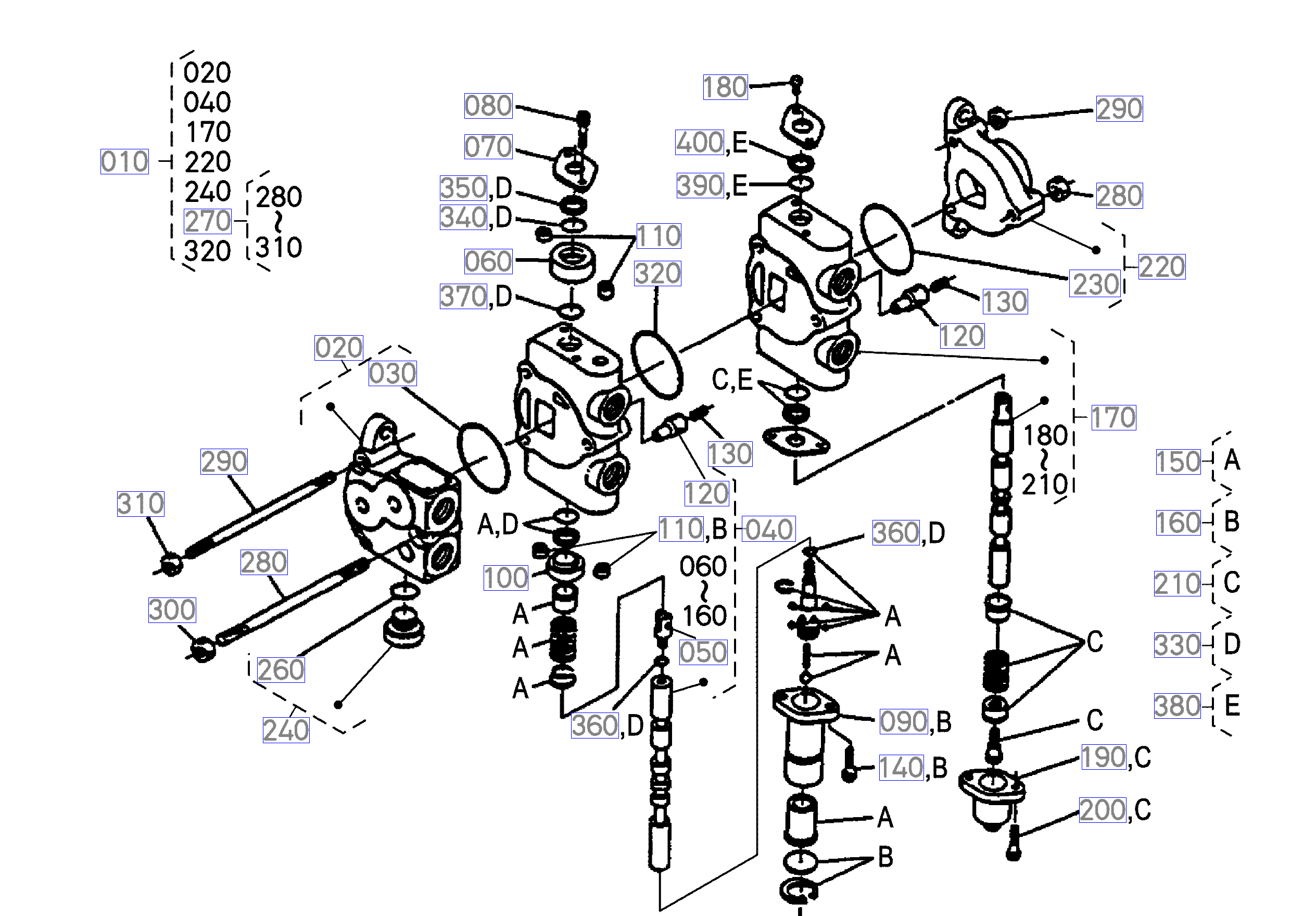

I was having some problems with my Kubota L2900 (LA480 Loader) where it wouldn't stop going up and then it didn't want to go down at all. Also, the float didn't work. I took apart the bottom of the control valve to take a look at the ball detent assembly. I found that the small spring (which pushes the detent balls outwards for the float position) was kinked pretty good, so I figured it would be a good time to order a ball detent kit and rebuild it (items "A" on the diagram below)

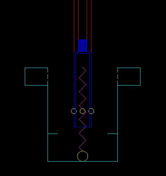

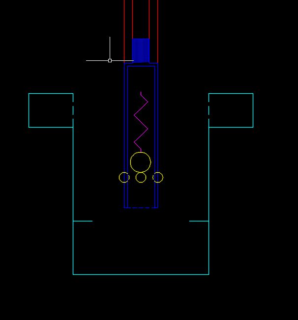

So I tried a couple different spring/detent configuration. I first tried leejohn's method, putting the spring and then the big ball above the detents. There was too much pressure on the detents and no way to hold everything in place while slipping the cap over the assembly. I then tried putting the spring on the bottom and the big ball right below the detents. This didnt work either.
I did notice the stiffness goes out of the joystick when i remove the detent assembly, so my problem is definitely in the spring/detent/ball configuration.
/ Kubota Loader Detent Kit - Help! #12
Getting the sleeve over the small balls when the big ball is pushing out is going be tricky, but after getting it over then you put the end cap on. Is that the way you tried? The big ball has to push on the small ones and with total movement of the spool there would have to be something holding the ball and spring in place. The small balls roll as they move back and forth in the sleeve and they can't if the spring is between them. Also the sleeve and end cap can't go on at the same time. When you took it apart the balls should of went flying unless you were ready to catch them.
#13
When I took it apart the first time, the large ball and spring were sitting in the bottom of the cap, and the small detents were in their proper place. My assumption, based on what I saw and Kubota's shoddy diagrams were that the spring being centered in the sleeve, behind the detents, was holding the detents from falling inwards. What I didn't understand was how the spring was going to stay centered on the large ball. What I saw when I took it apart looked like this:
If I understand you correctly, you think it should look like this:
I tried to install it with the large ball above the detents, but the spring was so compressed that I had trouble keeping the detents in place - they wanted to shoot all over the place. I think the only way to make that configuration work would be to hold the large ball in place with something long and thin (like a drift pin), install the cap (without the bottom piece) over the sleeve and drift pin, then try to slip the bottom plate into place and install the spring clip. Does that sound right?
/ Kubota Loader Detent Kit - Help! #14
Yes that is what I thinking it should go. That also is the way I was thinking to put it together.
