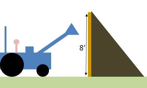

Going thru the "this vs that" for a tractor upgrade - possibly. While larger machine in general has some advantages to me, I think loader capability is going to be much higher on the list than most everything else. Some of what i do is maintaining 8' tall shooting berms that I fill from behind so reach height and dump clearance are important specs. What I have now with my LS for max height/dump clearance/weight at pins:
85.7"/65"/1270 lbs
Overall have pretty much settled on L3901, HST, ind tires, and SSQA bucket is the right machine for me. I'd like more, but for specs vs budget, that's where I land. Also compared LS XR4140H but loader heights quickly ruled it out at 96.3"/63"/2713 lbs. Losing dump clearance height doesn't work for me. Have not looked at specs for all other competing brands...familiar with LS and Kubota so may be something else out there that works that I haven't researched.
Anyway, sticking point on the L3901 is the LA525 loader it gets paired with. 94.3"/76.2"/1131 lbs is an increase in overall bucket height and almost a foot more dump clearance - both would be improvements. But I struggle now with lift capacity & breakout force on a 50" bucket rated 1270 lbs at the pins, so the 1131 lbs # is scaring me. And spending more $$$ on a machine and still working around a bucket that doesn't go high enough doesn't make sense either.
I haven't gotten a quote for a 4701 yet. It gets paired with the larger LA765 loader but is otherwise overkill. I assume since the frame changes there it's a little more significant price bump than the $1800 to go from L3301 to L3901? Can I just get an L3901 with the LA765 loader? or will that only fit on the larger frame? Grand L, MX more than I'm willing to spend....by a lot.
Excuse poor drawing, but this is what i do and why dump clearance matters to me:

Are you loading dump trucks? Sounds to me like you need a bigger machine like an L47 or M62

Let me summarize for my thought process:
You've got an 8' (96 inch) clearance needed.
You've got an 85" lift presently (a foot short)
You "struggle" with a 1270 lb lift capacity.

It seems to me that if you've been able to get by with what you have an "upgrade" to the L3901 would still not give you what you need and I'm pretty sure you couldn't put the LA765 on the L4701 easily.
Go with the L4701 if you can afford it.

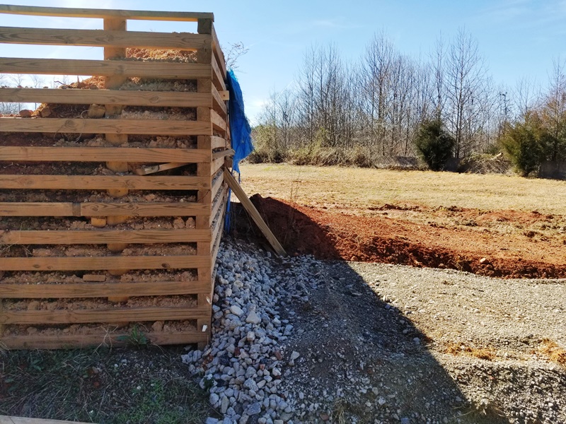

Just filling those berms a few times per year....bullet strikes tend to loosen up the dirt :) No dump truck to load.
I work around now by (1) renting a large backhoe - super easy with 1.25+ cu yd bucket, unlimited lift strength, real high clearance or (2) gravel/dirt inclines behind the berms to climb up and get some elevation.
I've heard a zillion times dump clearance doesn't matter - clear the obstacle then dump over it. Problem is, I need the bucket lip right at the "wall" so the material is as far back as possible. Otherwise more just wants to run down and off the berm. I very much dislike topping off my berms by climbing an incline behind them. I feel very unsafe/awkward climbing with full bucket at max height. Although I absolutely creep doing it & haven't felt like I was just about to tip sideways, it doesn't feel "right", and I think any give out or slipping on the incline would be a wreck.
Even if the MX were only $1 more than L4701, I think 3901 to 4701 jump is around $6k. L3901 quotes is right at what I'm willing to spend. To spend any more, it makes more sense for me to let larger projects and tasks pile up then just rent a backhoe from Hertz (Herc?) 1-2 times per year and knock them all out over a long weekend. Expensive and inconvenient letting stuff pile up waiting on a machine, but $6, $7, $8k or more is a LOT of BH rentals...
So any $ into tractor upgrade definitely means no more rentals. Kind of why I figured L3901 > L3301 for $1800 more...15% more HP might be able to muscle a little more. Won't do the earth moving like a 90HP, 8 ton backhoe, but probably a lot more than my current 25HP, 1600 lbs machine. Most of my larger earth moving projects are done - or done enough that they just need finished/graded/smoothed.
This is what back of the smaller berm looks like:

Is this a range club? Any member w/ proper size tractor receives a discount if assisting w/ berm maintenance
I have a set of steel ramps , custom made w/ checkered plate when extra reach is required

No, it's private - no members or other people shooting there.
Steel ramps sound like a better solution than my dirt/gravel inclines. I'm guessing that's something a lot more substantial than the ramps you drive your truck up on for a driveway oil change? Can you post a picture? I like that idea and have an acquaintance who does incredibly good welding work inexpensively.

Ramp photos, I did NOT measure, they are about 6' in length, gentle incline, 11" rise approx. Stops at top of ramp: critical!!

Based on your pic of the shooting berm, with your approach ramp in the rear of the frame that supports the berm, what about having a few loads of dirt delivered and unloaded behind the supporting frame and thereby increasing the height of the approach ramp? Actually, I would favor spending the money on a tractor with a FEL that fits your needs, but you might price out that alternative.
