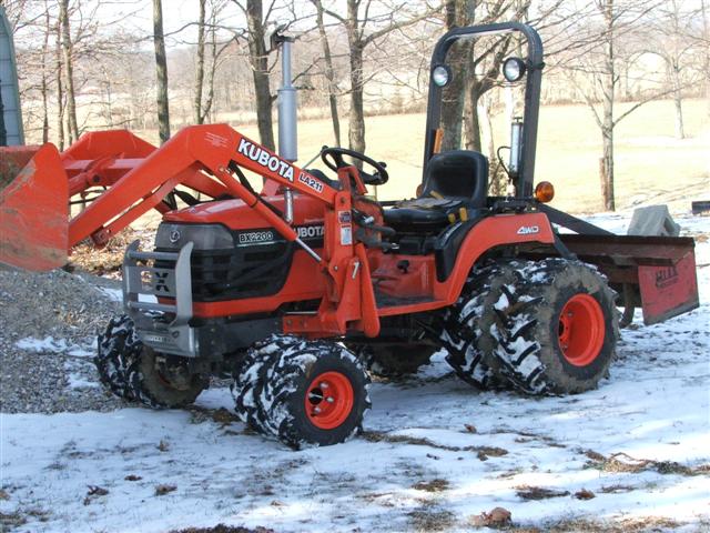

Milkman, thats gotta be the coolest looking little tractor I have ever seen!
   / Kubota M135X Duals? #19
I second that!!!
