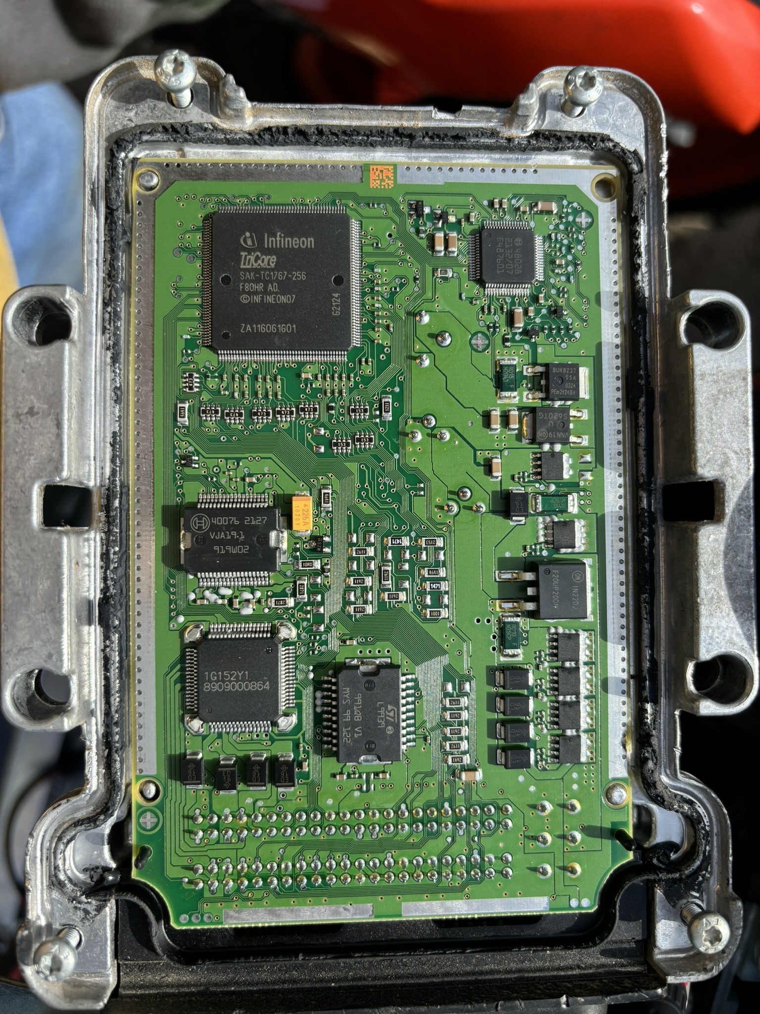

I opened the Engine ECU and found plenty of +5V power all around the board's ICs

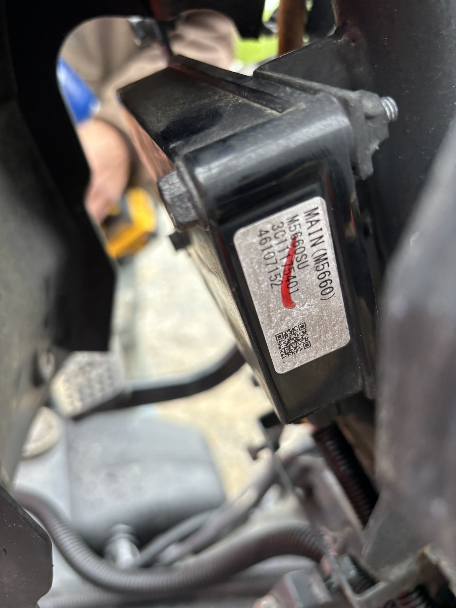

I think the +5V error is generated on the MAIN ECU (one below the steering column which would have been subjected to fire/heat) That Black Box is non serviceable all molded in plastic (second picture)
