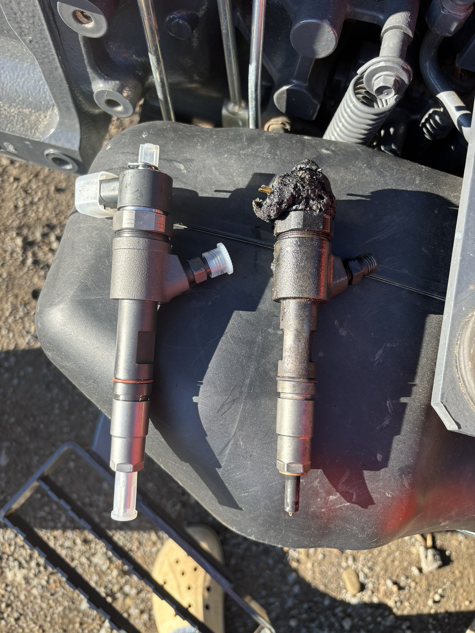

Replacement cost of that non-serviceable unit?
   / Kubota M5660SUHD caught on fire (60hrs)!
#252
It's $1000 (main ECU). The engine ECU is 2k but I think it is the main ECU.
I will know more once I get the fuel lines connected and run the engine and if it runs then it is the main ECU.
I ordered the service manual too,
   / Kubota M5660SUHD caught on fire (60hrs)! #253
Have you poked around Tractor House at all?
Tractor House, Dismantled, Kubota M5500, M5700
I'm not seeing any M5600 tractors, but there are M5500 and M5700 tractors.
It may take some hunting to cross reference parts numbers.
If you do go with an ECU, there would be advantages of purchasing new.
Do you have a Kubota diagnostics tool/ECU reader/programmer? That would help a lot.
Now might be the time to install a stripped mechanical injection pump, if possible, due to all that heat damage and get rid of that crap.
#256
injectors were actually easy to install. The heat damage was on the plastic connector on top of them.
I got the fuel lines and fuel flows but does not get to the injector rails. Probably solenoid does not want to let fuel run due to ERROR-60
