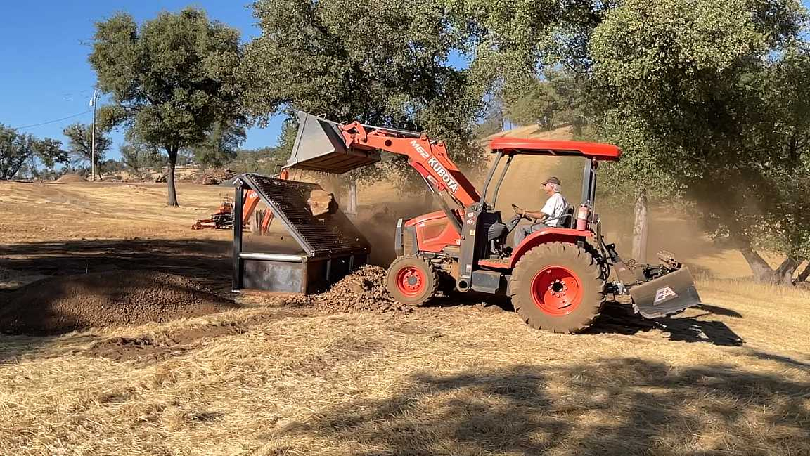

Tried the crawl feature, but ended up just picking up the FEL a little bit then shoving the tractor forward with the backhoe. FEL back down and back to work. I thought the crawl feature would be perfect for making small adjustments when attaching implements to the 3PH, but it engages too abruptly and moves the tractor too far. So at this point I really don't know what it's good for, especially since it only works if you're sitting in the seat.
The ground here is really, really rocky, and about half of what came out of the trench was rock. There were places I couldn't get deeper than a foot before I hit really hard bedrock, so I had to call it good. But I needed to screen what came out of the trench to keep the rocks in the fill from puncturing the plastic pipe in the trench. So I made a set of grizzly bars with a little help from a neighbor. Most of the steel came from the junk yard...
I found a 12" trenching bucket at a used equipment dealer up in Medford, Oregon. That's what I was taking out of the VW van for that photo you remember. Saved way more than the cost of gas over the price Kubota wanted...
