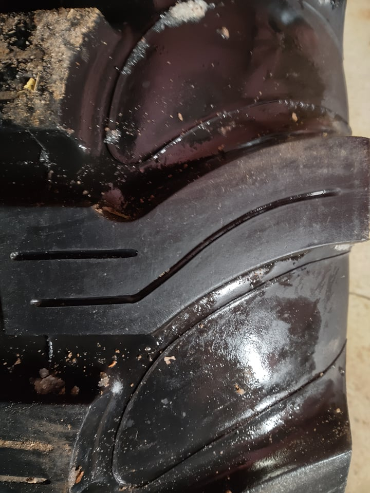

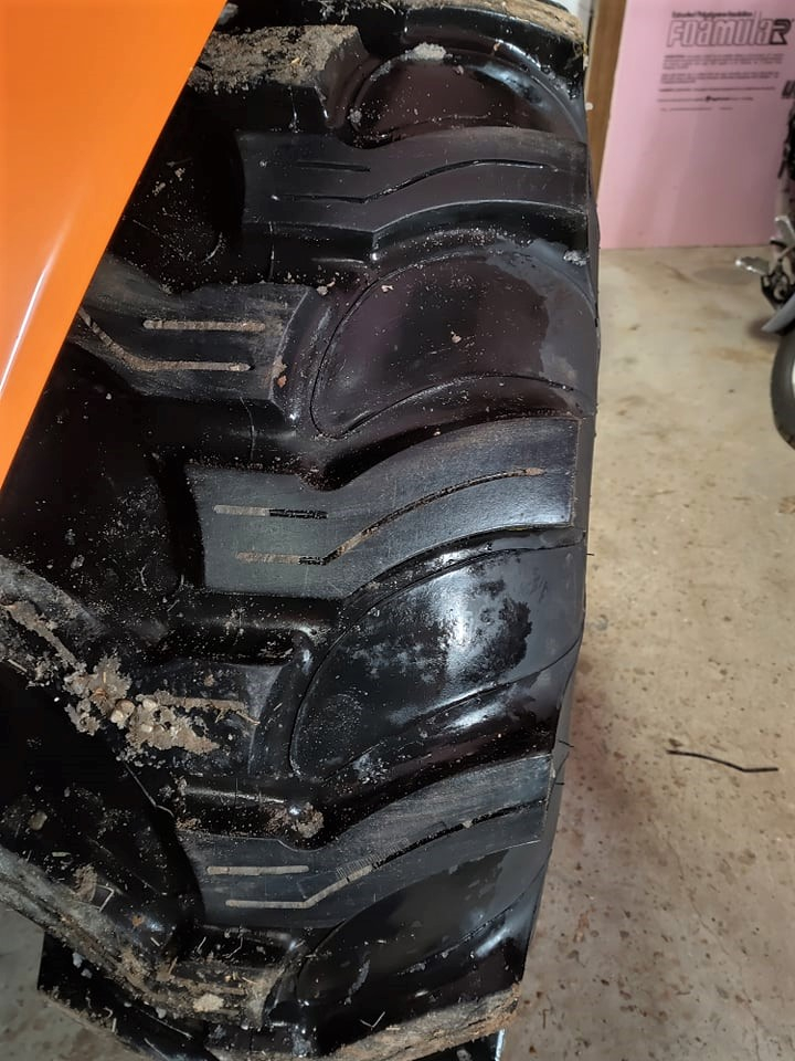

Got around to grooving the rear tires today. Did the same as the fronts but added a shorter additional groove as there is more meat to work with. It took a bit longer even though the working height was better. Getting to the inside bars was more difficult due to the proximity of the rear fenders so I had to move the tractor a lot.
I've had several opportunities to operate the tractor in identical conditions over the last few days. Prior to grooving the rear tires I had to engage 4 wheel drive or lock the rear to get up the slope going into my shop every time. After the grooving no issue whatsoever just driving into the shop.
@sixdogs Here's a close-up you wanted to see.

Glad it made a difference, I felt it was a big difference as well. I was going to buy chains. No need now.

Me too. I figured it would make a good difference as there is no shortage of people who have found out first hand.
Chains are always an option if it ends up that I think I need them. But if just the grooving is able to meet my needs it's a win.

Rob41--Great pics. Thank you very much. Great thread.

You're welcome. Getting good results is super easy. It is a little work to push the tool but not too bad.
There are a buch of tire grooving thread but I figured I'd do one also because the largest tractors I found doing this were along the lines of a Kubota L series. At least now an M series is in the mix.

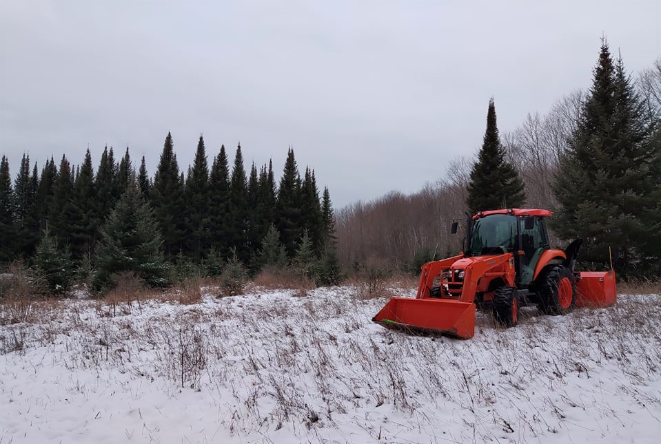

Been driving around on the property a bit today. Went back almost a half mile to use the pole saw to trim back some branches. The grooved tires did well even in the snow with a bit of terrain.
