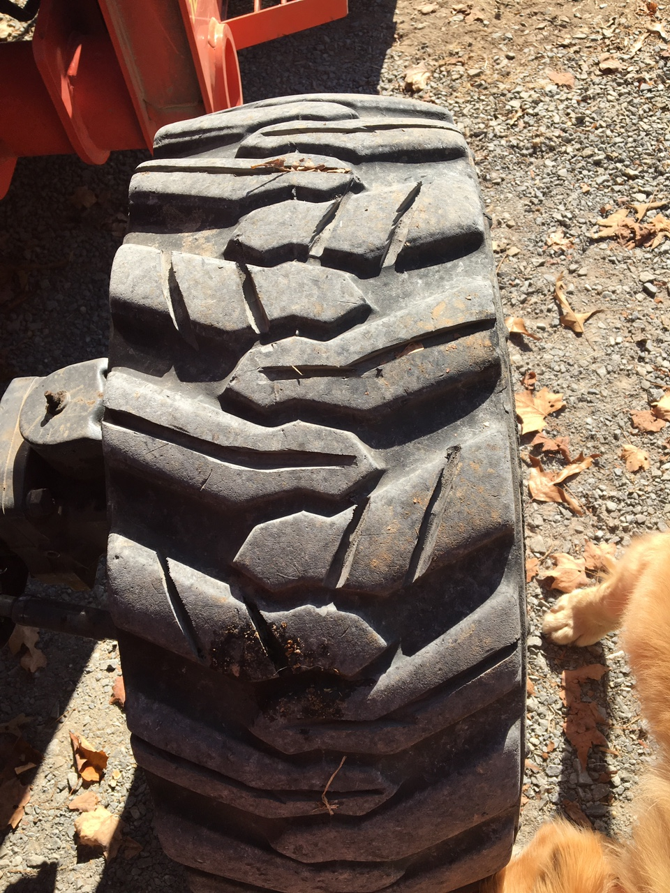

Have little experience in snow. When I first bought a used M59 it had worn R4 fronts. Easy to slip in mud, soft ground and grass fields. Used a chainsaw wood carving blade on grinder cut tires. View attachment 723052
Made for significant improvement for my terrain. After a few years replaced with 12ply, extra deep tread R4s for better mud traction. Farmer who bought those used grooved tires still brags on those tires on his skidsteer around his barn.
B26 many chores is finish mowing the many hillside clearings we call yards.
Immediate improvement in wet grass.
Done with tire groover. Has worked good for 5 years, 500 hours.
I actually used this picture of the b26 when I did mine. Just realized it, you made it to google search!

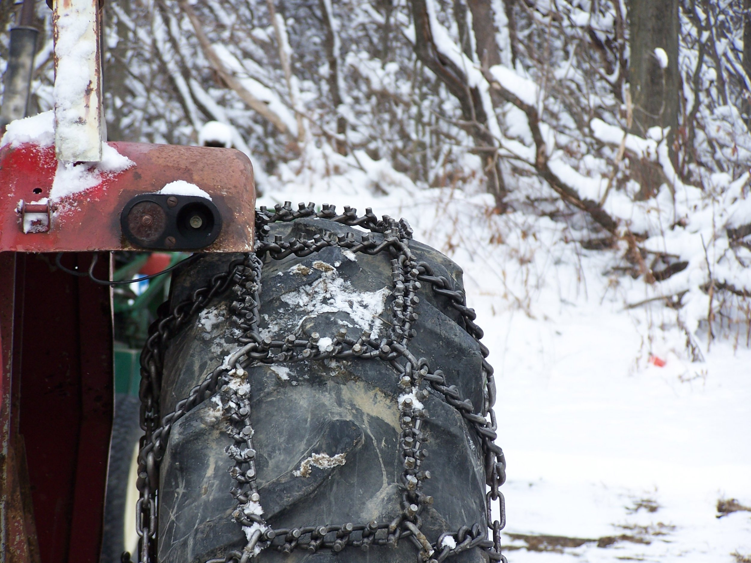

This is a set of OFA's IMG_20151228_135705794.jpg100_4167.JPG,

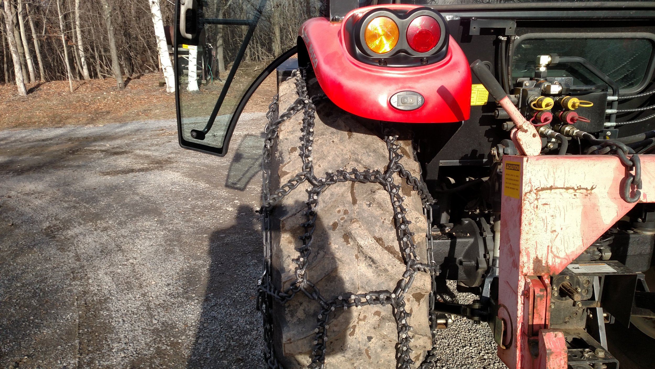

And this is a set of Aquiline Talons;

Both of those look very good. And I see the Talons are a good $400 less than the TRYGG yet look to be similar in construction.
