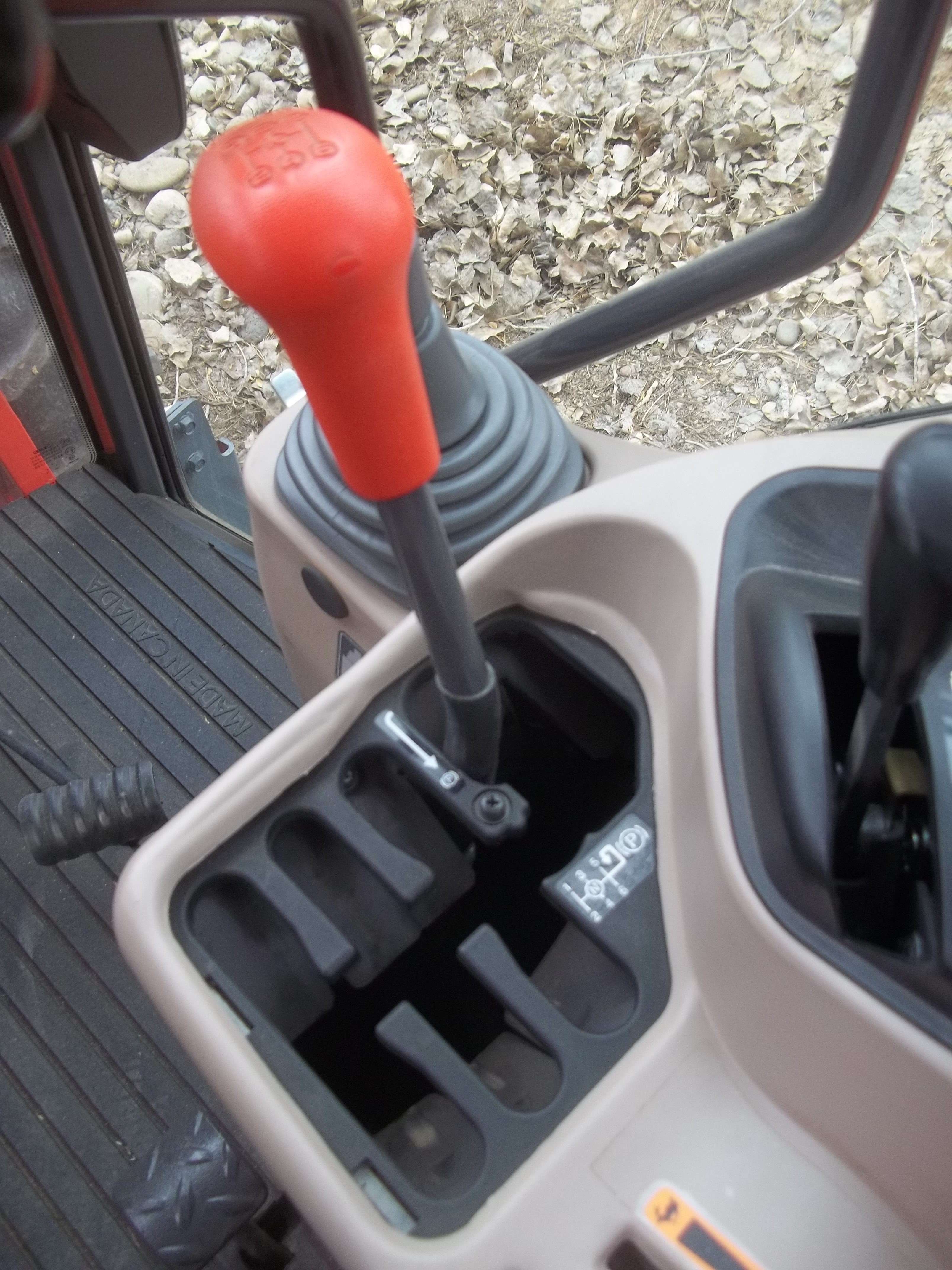

Attached is a photo of a M7060HD12 gear shift with park brake. To put the tractor in park, the shift lever is pushed all the way to the right; pushed forward; then back to the left and finally pulled back again. On my tractor, once in this position, it is almost impossible to "slip" out.
But... if Kubota wants to make sure one does not "accidentally" set it improperly they could manufacture a new shift guide plate that has an "L" shape guide that starts at the screw that is visible in the photo. This would create a slot that would keep the shift lever in the park position. Manufacturing and installation costs would be minimal.

I have had an M706012 for two years. If I could change one thing about it, it would be the parking brake. I really don't like it much, and don't trust it much either. Until the post by OVRSiZED, I had no understanding of why I had to use the transmission to have a parking brake (due to hydraulic brakes).
Now that I understand why, I feel a little better about it, but still wish there was some kind of foot controlled parking brake also. For one, it's a bit of a pain to get the shift lever into Park each time, although I understand now that even if there was a foot pedal I should use both the transmission and the foot pedal (like I do in a manual transmission car). On my 7060 I have had the lever pop out of Park a few times, but always while it was still in my hand. If the engine is running and I put it in Park, I give it a few seconds with my hand still on the shift knob to be sure it won't pop out, because it occasionally doesn't engage.
Here's a question I've wondered about, but never tested: If I park on a grade, and the transmission pops out of park but the forward/reverse shuttle shift is not in neutral (i.e. is in forward or reverse) will the tractor roll?

If that is a power shuttle using wet clutches it will roll as there is no direct mechanical link to keep it from free wheeling, plus if you jump out of park it's most likely in neutral not a gear.
