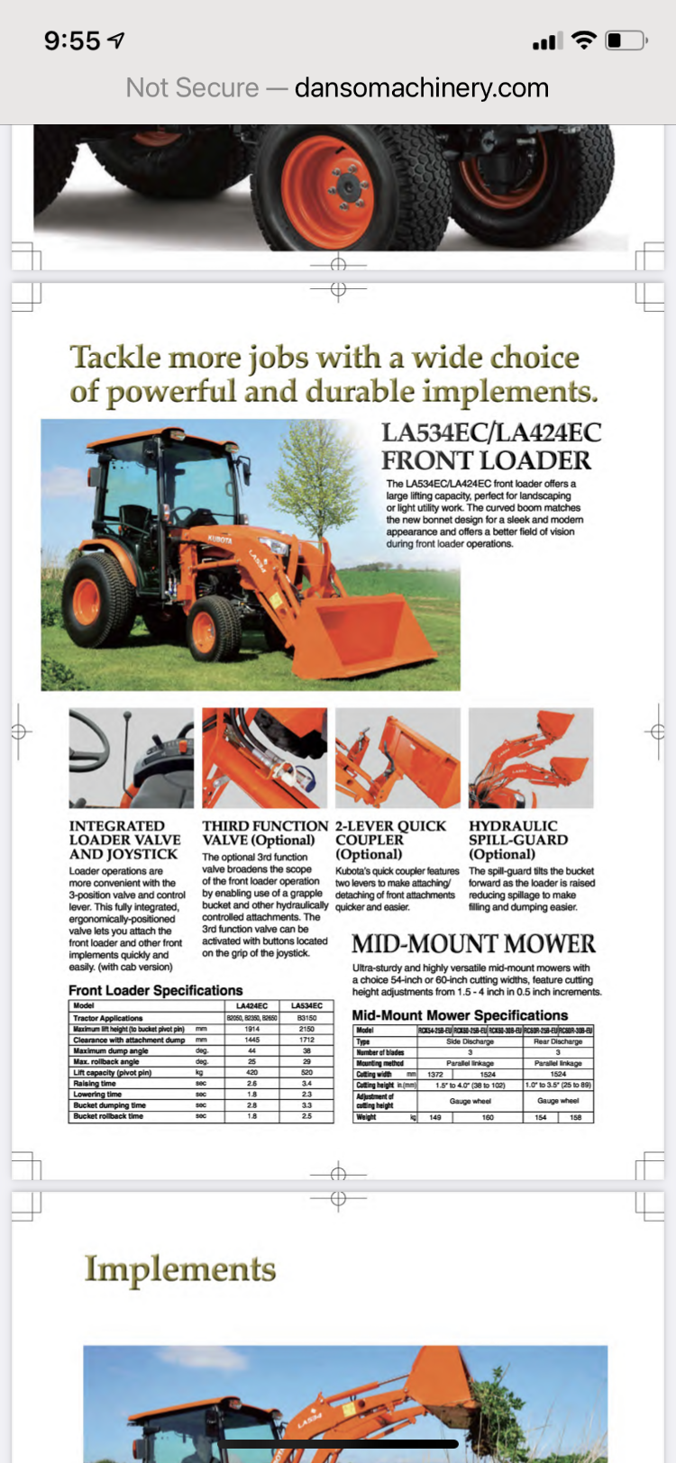

Hello, Yes I am overseas (Europe). I also noticed, that in the US there is a different model range.
Below is my Kubota picture. Can You tell me , if this is matching with what You guys have ? Maybe it's the same model but just different number?
I join also a scan from Kubota flyer where You can see the possible options which we have for MMM (with rear discharge as well)

Don't fear the mid mount mower for the B20 or B01 series if that's what you have. They are drive over decks and very easy to take on and off. A single handle on the front of the tractor and a spring pin on each side on the lift arms. Hardest part is reaching under to lock the PTO shaft on.
I have seen rear discharge on the rear 3 point mowers but didn't know they had a rear discharge option for the mid mount. Only benefit to a rear discharge is if you are mowing very long or thick grass, as it distributes the clippings more evenly. But if you mow regularly before it gets out of hand a side discharge is fine.
I have the 60 inch side discharge. And my yard is not level, yet I don't find it scalps at all.
